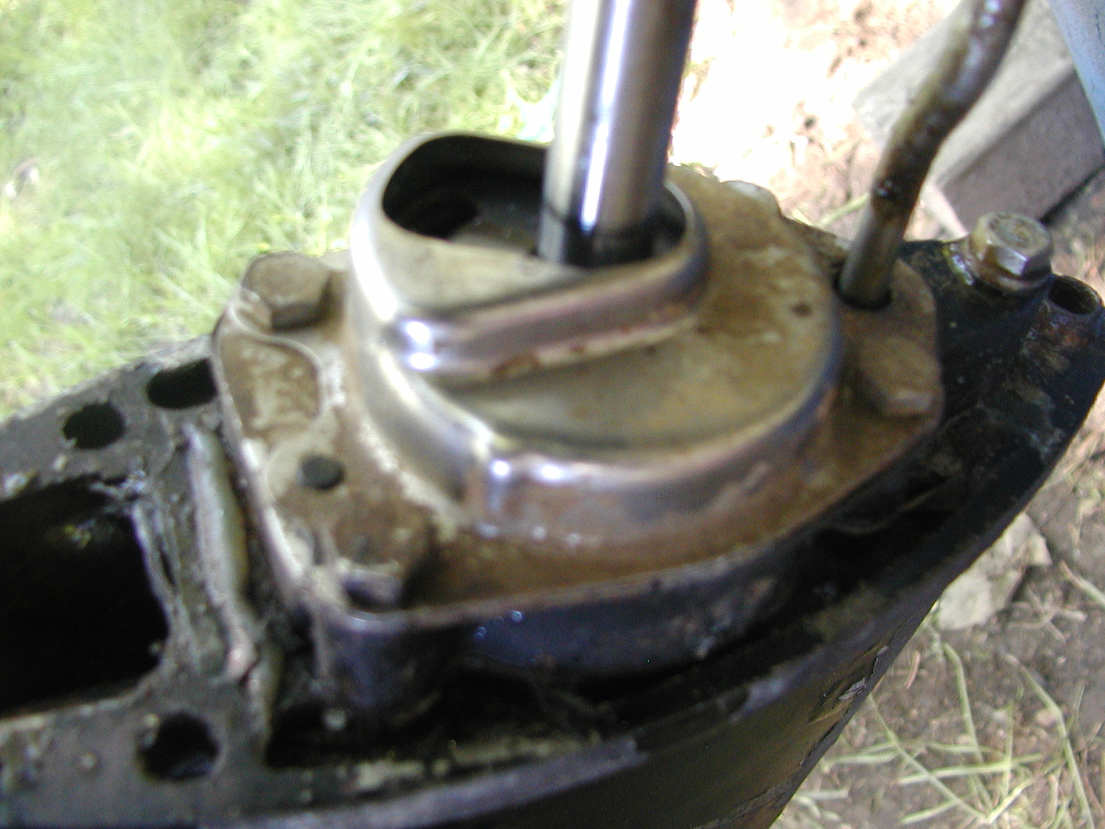

9.9 water pump seal 12 years 4 months ago #96453
i have a 1987 9.9 hp that i am putting back together. I have never seen this style of water pump. When i pulled the lower unit the top seal stayed in the water tube, does it stay there and just sit on top op the water pump cover?
thanks for any help.

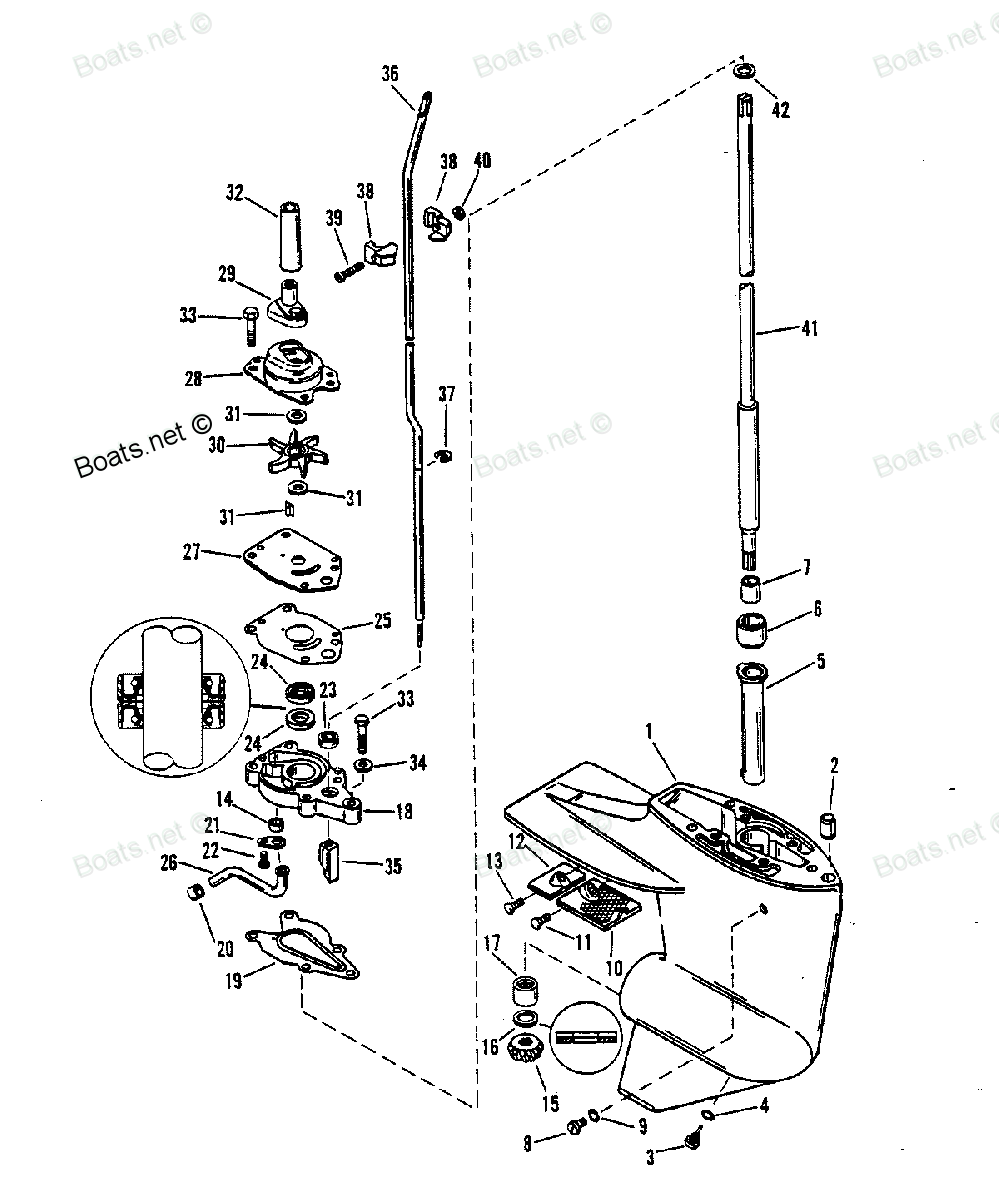

Re:9.9 water pump seal 12 years 4 months ago #96551
i tried adding a file showing the parts diagram.
Re:9.9 water pump seal 12 years 4 months ago #96552
try again
Re:9.9 water pump seal 12 years 4 months ago #96757
Hi,
Possibly way too late, but the black rubber grommet should be removed from the water tube, and be fitted back into the water pump housing opening (there is a molded-in lip which inserts into the stainless housing opening). Then, lube the bottom of the water tube (please clean/remove any build-up first that is sometimes present on the copper) before reinstalling the lower unit assembly, ensuring to align the water tube into the top of the grommet as the lower unit is being installed.
Regards,
Joe
www.fergusonpoolemarine.com
Profile Picture:
Re:9.9 water pump seal 12 years 4 months ago #96768
Thank-you Mr. Poole, actually i haven't done anything yet except order a new grommet as the old one looks a little tired, i will post an update when i get back to it.
Re:9.9 water pump seal 12 years 3 months ago #98404
Got it all back together and it is the water pump is working great.
