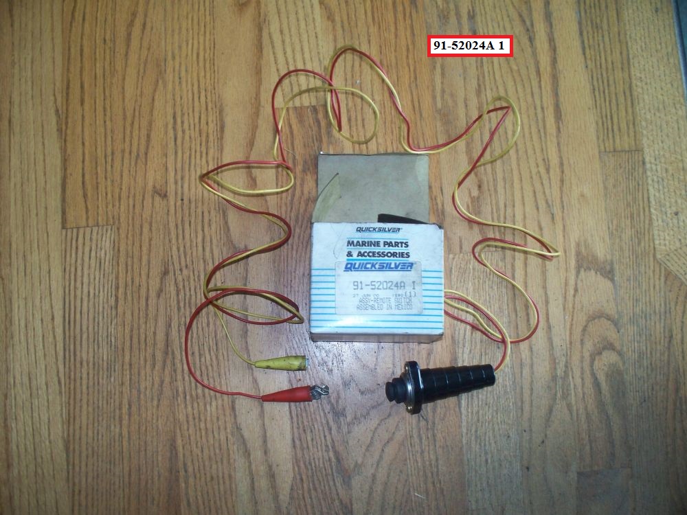

Here is the Mercury Marine tool for the job :)
Doc

Peter,
The remote start switch is basically a jumper wire between the small yellow wire on the solenoid & the primary large red terminal on the solenoid.
If you have a control box plugged in for power you can use a 16 gauge wire with alligator clips on each end to spin the Merc.
Clip onto the small yellow terminal and touch (don't clamp) onto the primary red terminal.
Leave the ignition key 'off' for compression testing, or 'on' (with spark plug leads removed) for timing, etc.
Remember all,...
If you don't have a control box connected, and are doing tests that spin the motor, remove and tape off the (2) yellow wires that go to the rectifier from the stator to avoid breaking the rectifier.
I also strongly encourage removal of the propeller during any testing that puts you standing near the propeller.
Doc
