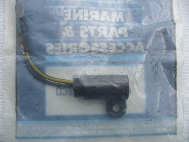

Re:Rewiring an obsolete motor 12 years 5 months ago #95104
Hi,
If you should like to continue to have the safety feature, we have this one available which will likely have a shorter wire than yours, but a jumper wire can be added, or this can be extended.
Regards,
Joe
