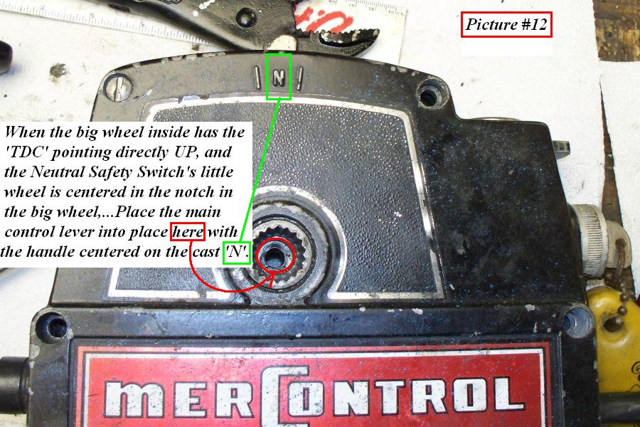

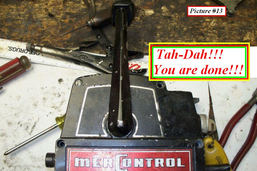

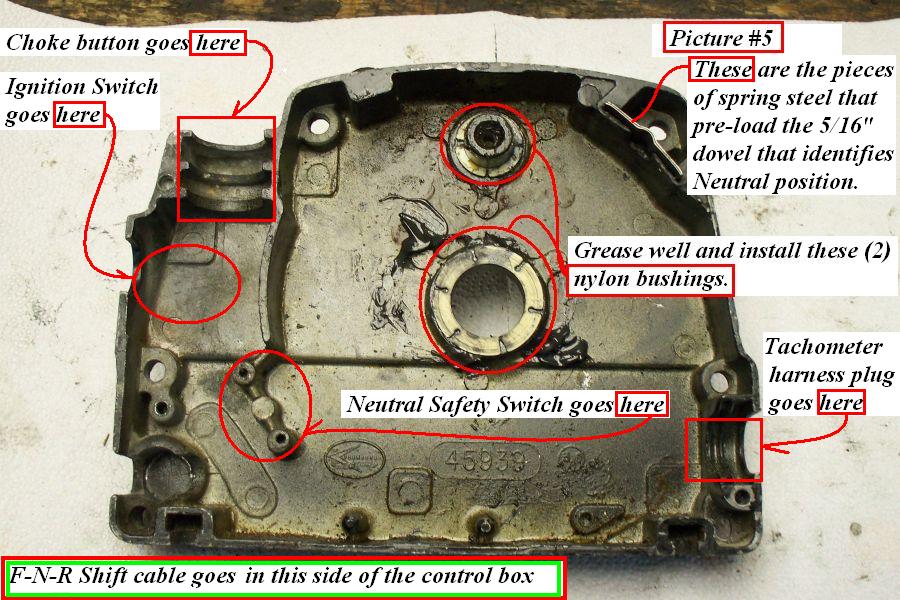

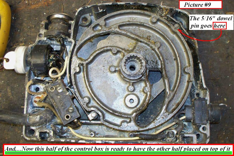

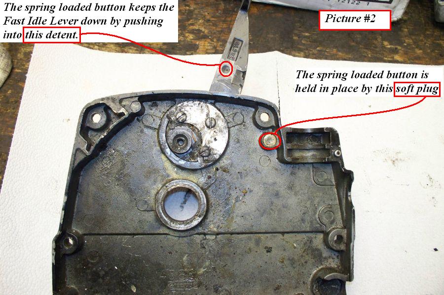

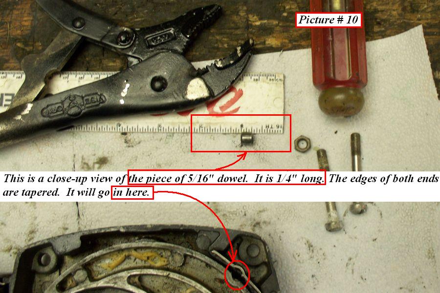

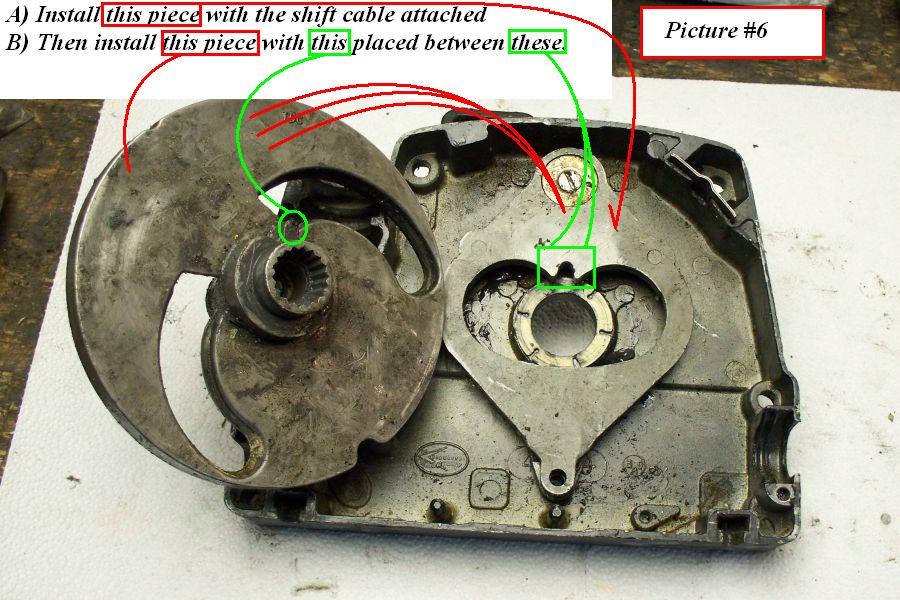

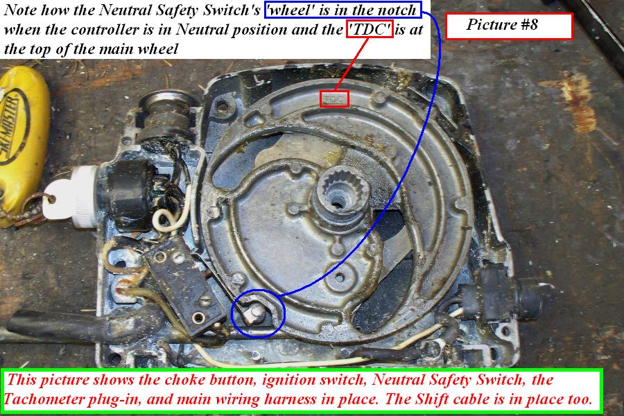

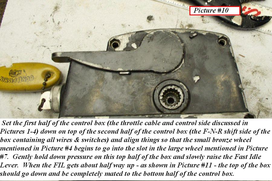

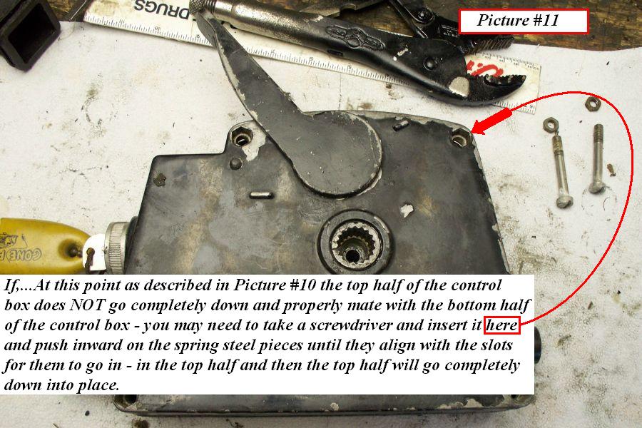

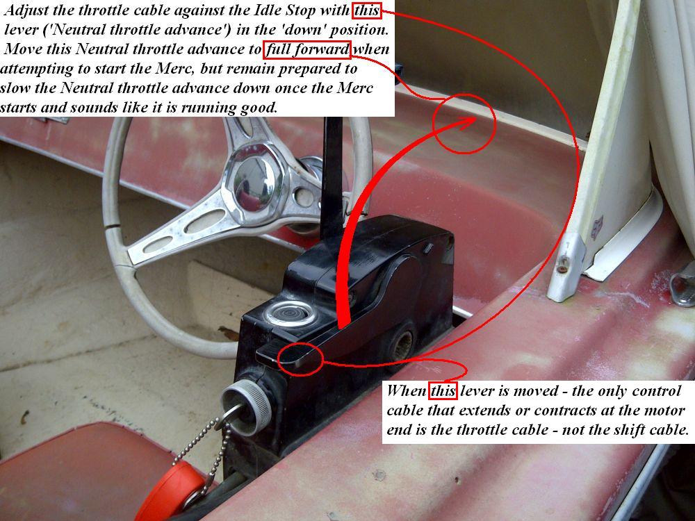

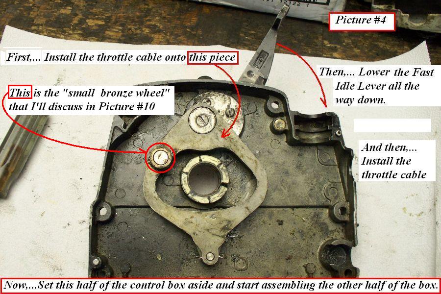

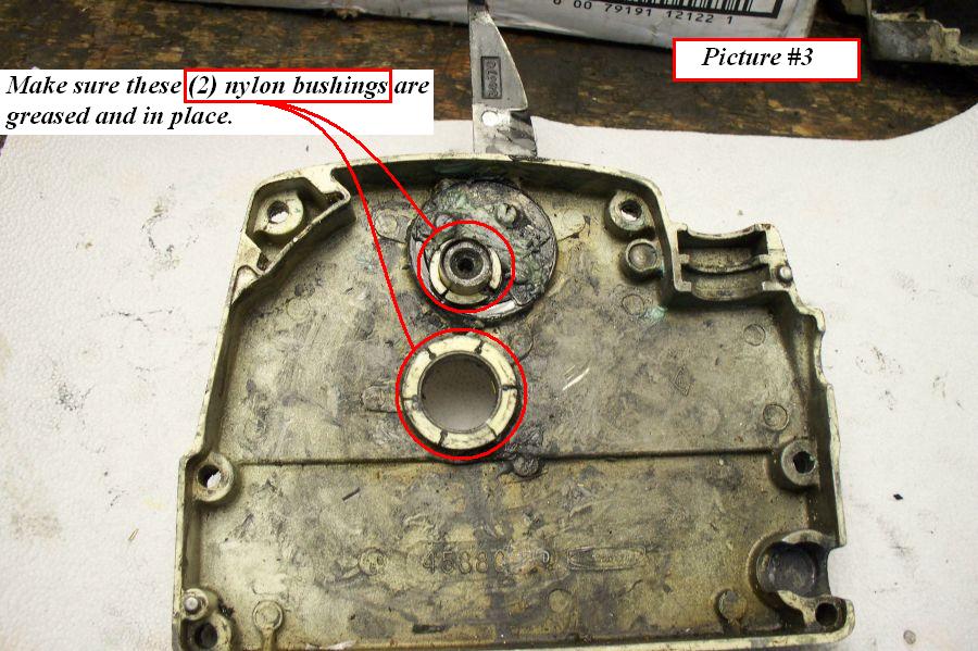

I doubt this will answer all of the current questions, but maybe it will assist some when they first open their mid-'70s Merc control box.
I am trying to find the pictures explaining how to adjust the shift & throttle control cables at the engine ends, but no joy yet.
You will need to click on each picture to be able to read the narratives.
Doc

Thanks a bunch doc , if this doesn't walk me through it, I dont know what will !

great tutorial doc. definetly saving that. ron

Thanks for this doc, I have a control box that I bought disassembled cause I planned on reprinting it. This is perfect.
