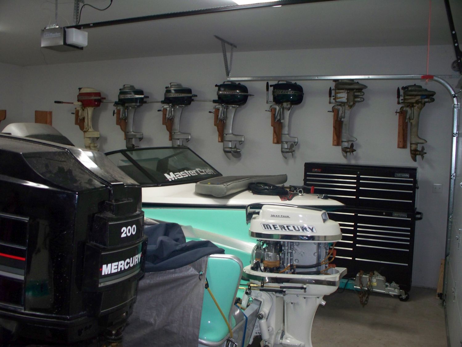

doc, thanks for the advice will do !!!! and yes i like all the motors you have. now i know what to put on the wall of my garage!! madbohunk safe boating

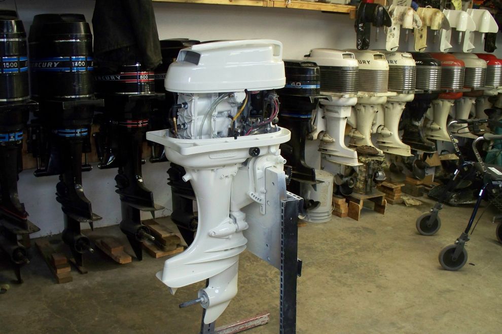

SteveH asked: "Holy Cow! You got enough motors there Doc?"
SIGH,...WAY too many, but they are like stray cats to some folks in that I just can't allow such treasures to be nuked at a scrap yard.
I've said it before, and I'll say it again,...I am a Mercaholic
:) :laugh: :)
A neighbor kid counted just under 100 assembled Mercs a month or so ago.
Lots of used parts too.
Doc

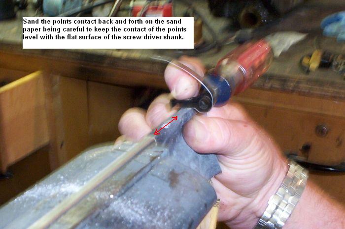

Re:59 mark 55 AE 12 years 5 months ago #94253

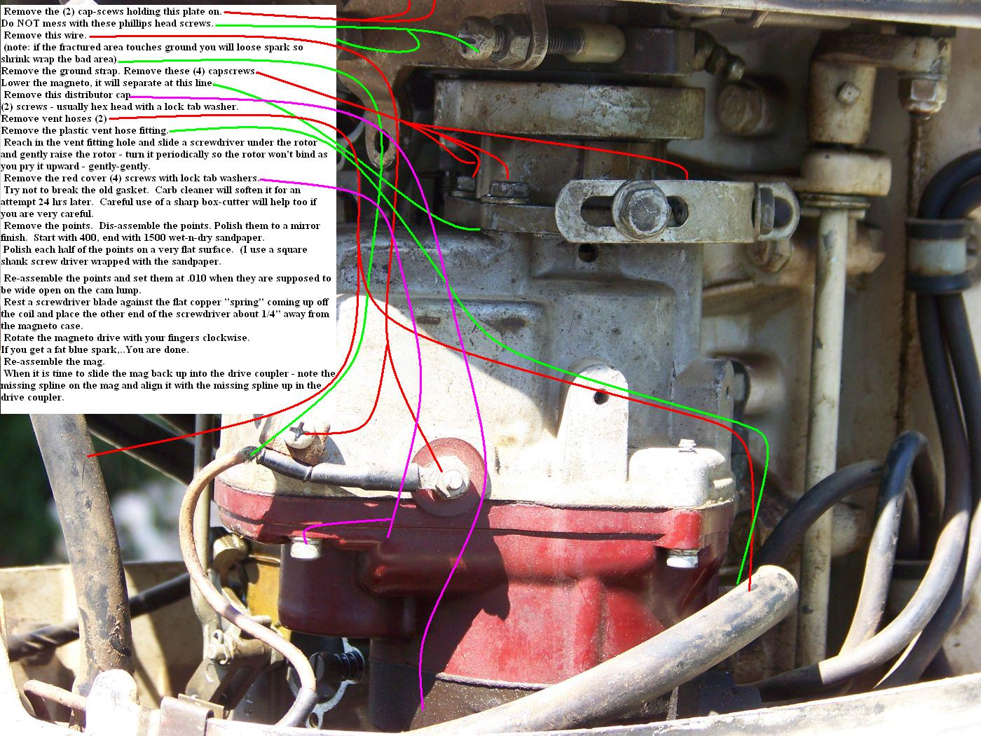

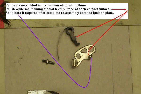

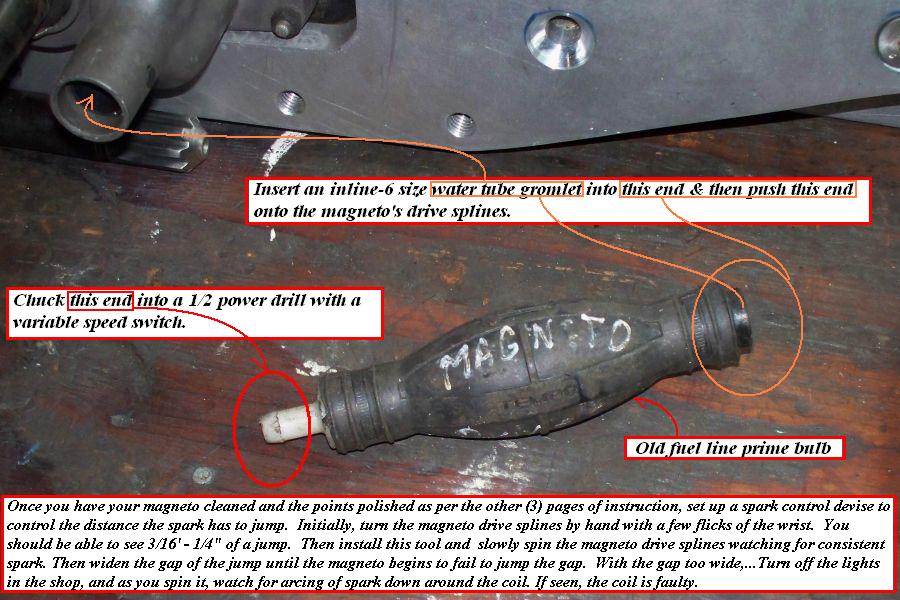

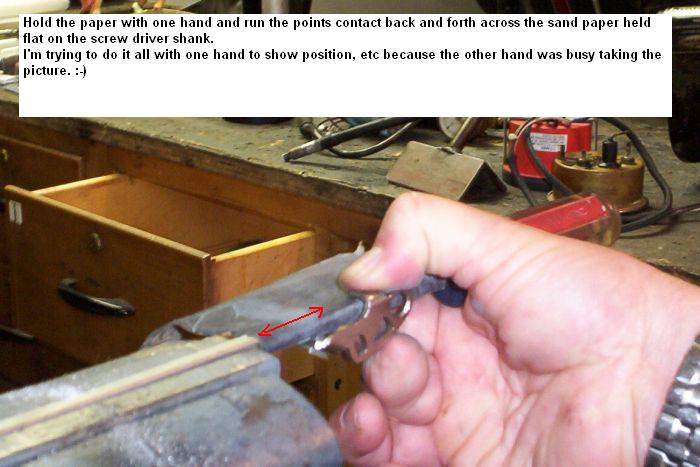

madbohunk,
I have attached some pictures that show the process to remove the magneto polish the points.
Hope they help.
Doc
