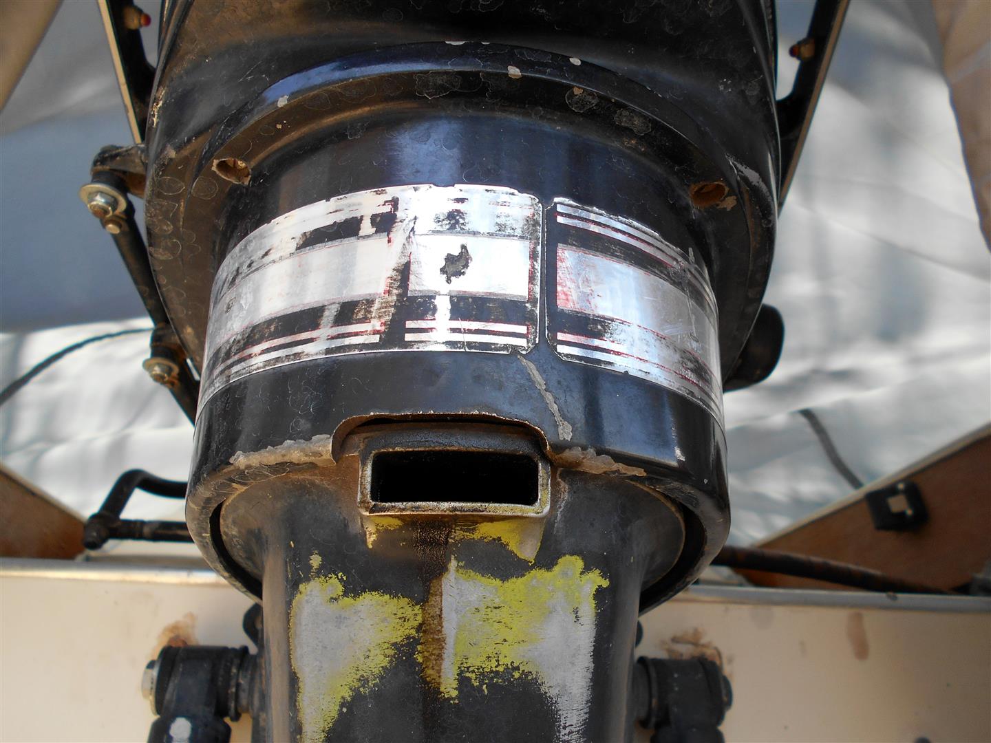

  • Karma: 22
I notice that I get a fair amount of exhaust fumes in the cockpit when underway. Part of it is the boat's design, the cabin/windshield creates a low pressure area that pulls the motor fumes forward. But, I also notice that this motor has the wrong upper cowl, from a different year. The graphics are red, not black, the exhaust relief port has been added with a grinder, and the cowl doesn't really match up correctly to the bottom of the motor. Wondering if that's part of the reason for all the fumes. At idle/trolling speed, I see no exhaust at all coming from the prop hub. It's all venting from the relief port. Is that normal? At speed, there is exhaust coming from the prop hub but still a lot of venting from the port. No fumes from inside the engine cowl though. Is it possible the wrong cowl would lead to excessive fumes venting from above waterline? See photos, yup the paint is awful, haven't done a thing to the motor cosmetics since I got the boat.
Re: Question on upper cowl, 64 Merc 650 12 years 6 months ago #93833
that would not be the problem the original cover was a thin flat piece not cast. the problem might be the seals on the upper mounts.

Re: Question on upper cowl, 64 Merc 650 12 years 6 months ago #93900
yes it would . try silicone on the outside. may work.

Dave, I've been looking at the parts diagrams on Marineengines.com and can't pin down the seals you mentioned. I see two gaskets, driveshaft housing to bottom cowl and powerhead to bottom cowl. Are those the ones?

My son and I spent yesterday trolling and the fumes were pretty bad when heading upwind. Other than that, the motor ran well.
Re:Question on upper cowl, 64 Merc 650 12 years 5 months ago #94311
on the top one ##33 is the part.

OK, I see it. They're calling it upper mount packing. Thanks.
