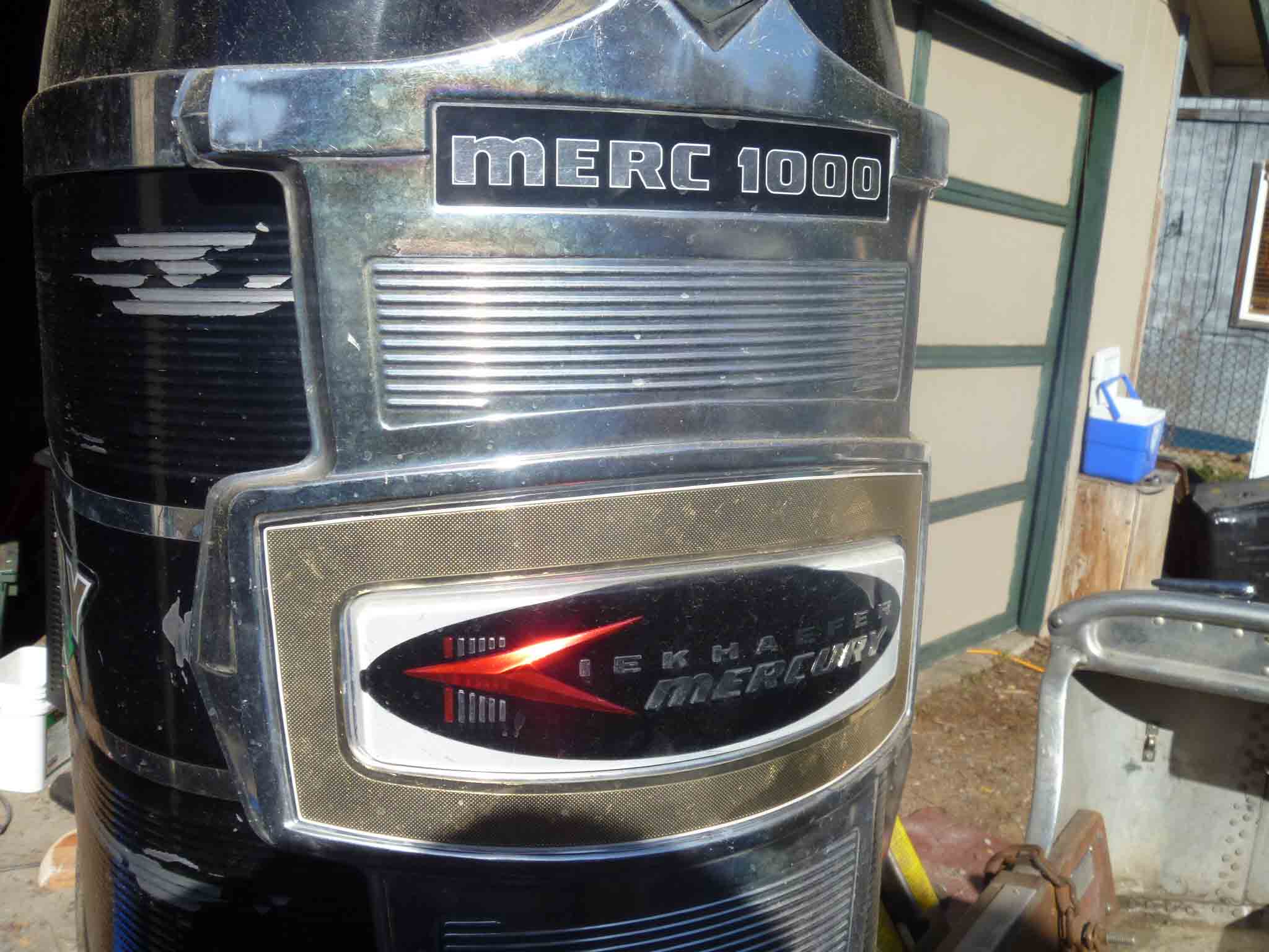

I'd like to touch up the paint on this 1965 Mercury 1000 until I can restore it. Who knows what type of paint and the color to use?
