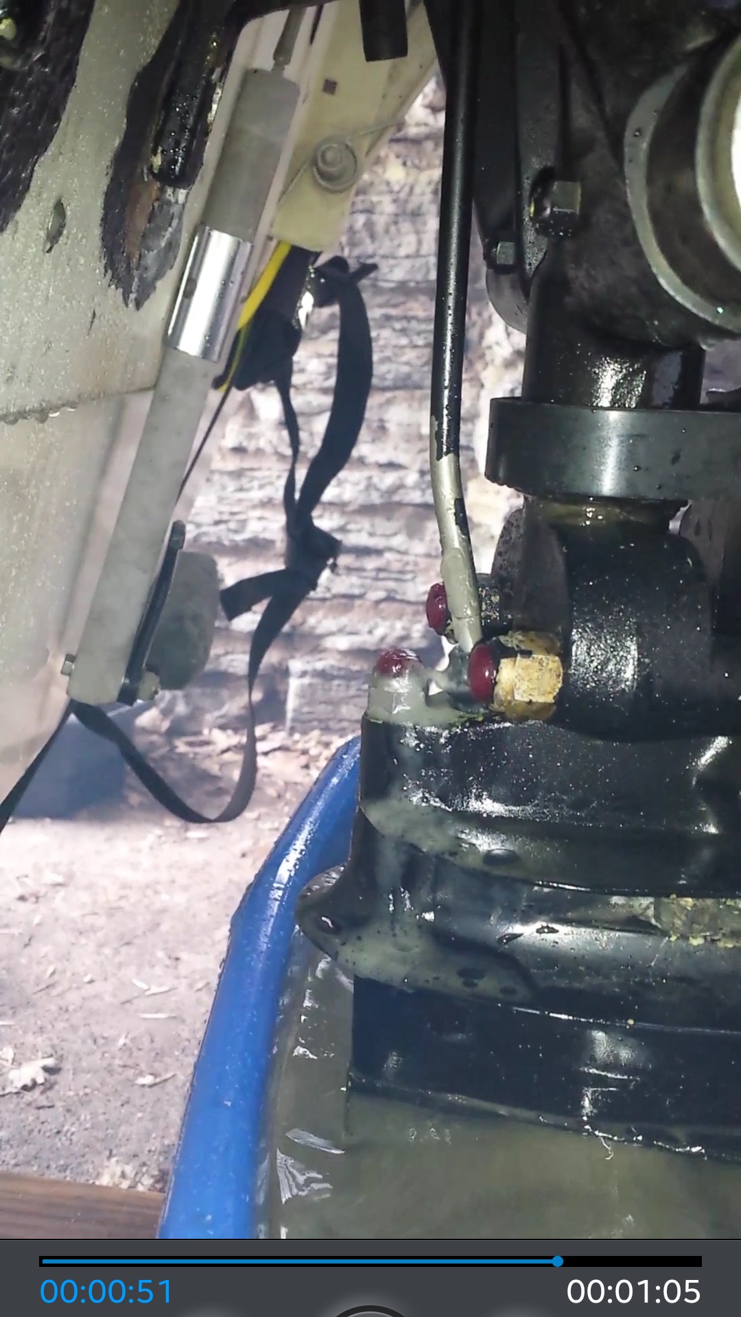

Here's the update. Replaced the shift rod bushing and oil seal, oil seal & o-ring on the water pump base and the water pump body, replaced the water pump gaskets but will probably need to be replaced again as they have been on and off now twice.
Pressure tested with 15 psi and it only lasted 2.5 hours. When I ran the engine it seemed to run real rich and had ALOT of extra oil and gas in the test tank and it was still puking gear oil and exhaust out of the same hole as shown above resulting in a geal oil slick. The water had a really strong gas smell.

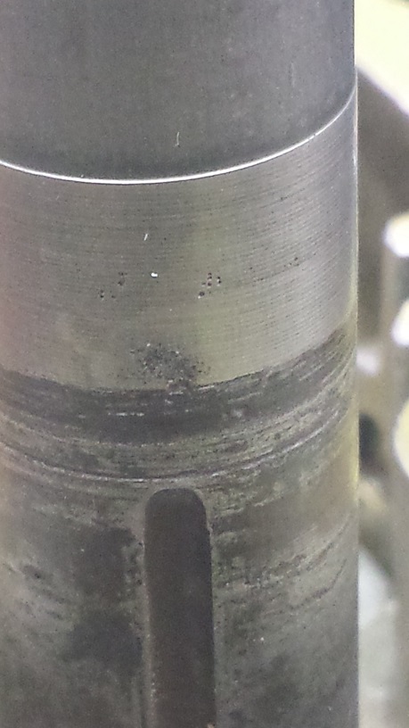

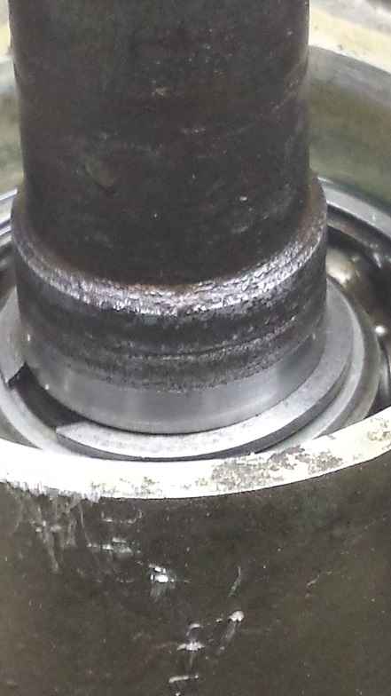

Another forum said that if the drive shaft had rust on it would leak again regardless of new seals.
Re:Brand New/Old Merc 1000 12 years 6 months ago #93917
Yes, if the prop shaft is rusted/pitted/worn away at the location of seals then it wont ever seal completely. How much it leaks will depend of course on the amount of wear. There are solutions to this (something called 'speedy sleeves' I think, or finding one of the later model stainless shafts) but I don't know much about it....
Re:Brand New/Old Merc 1000 12 years 6 months ago #93921
also check the shift shaft seal. common problem overlooked
Re:Brand New/Old Merc 1000 12 years 5 months ago #94257
Ordered some speedi sleeves to fix the problem. it was a rusty drive shaft where the oil seals have worn on the drive shaft.
