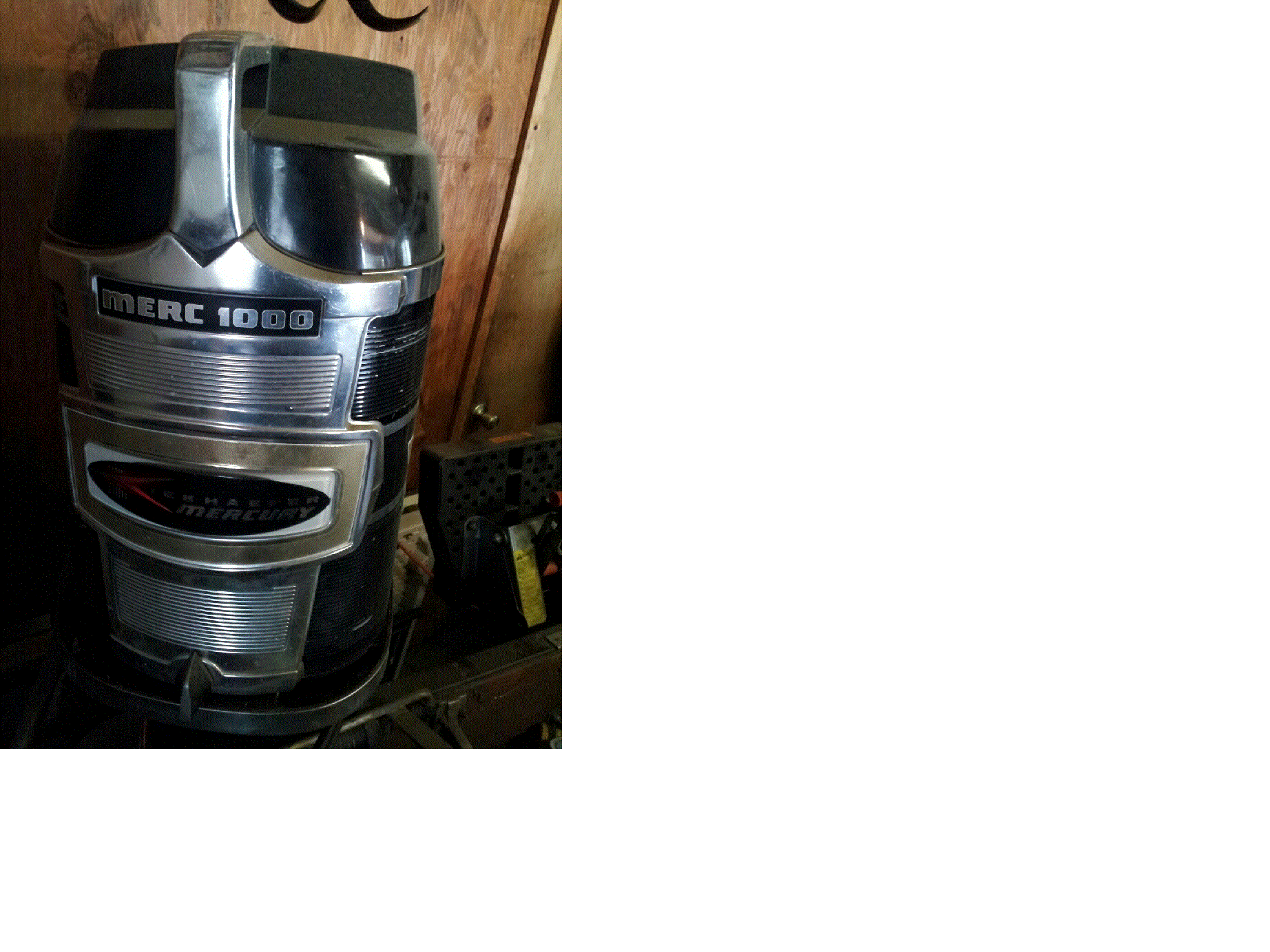

Ok guys, I'm new here and I've been reading through some of the information on other Merc 1000 posts. I'm impressed with all the knowledge available here. So I'm hoping to get educated. I'm not a mechanic but unfortunately I saw a boat and had to have it. She is a 1960 Alumacraft 18' Queen Merrie with a 62-64 (guessing) Merc 1000. The seller pulled her out of the garage and filled up a barrel with water to test her and she fired up nicely and ran well for the test. That was enough for me. She is mine now. So here are my questions;
1. Can someone look at the motor and tell me what year it is? The seller said the boat and motor are 1960, the boat checks out but a little research suggests to me that the Merc 1000 is 62 and later.

Re:Early 60s Merc 1000 12 years 7 months ago #92284
I would say 1965 by the decals definitely not 64 or prior.
