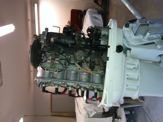

I need a bit of advice. I started my Merc 700 6 cyl. Gear shift this weekend and after a half hour run there was quite a bit of oil in the water drum, what would cause this? Also a bit of oil seeping at the crankshaft cover joint behind the starter. Otherwise all went well. I don't know how long this motot had been sitting but it started right up and ran well. Water was flowing from the telltale but I am unsure of the intake location.

Good evening! I have the motor out and crankcase split in half, not to bad of a job. I did find a few things that didn't seem to be covered in the service manual, I might have removed a few extras but it only goes back to gather one way. I wasn't sure of distributor and drive removal and it was a struggle to get the plug wires thru the bracket on the exhaust cover. Also the fuel line system seems to be built as a unit because the carburetors need to be removed and unscrewed one at a time. I think this is a good time to replace all the lines. I also noticed the top bearing was very dry and "gunked" up with dry fuel mixture. I could not turn it by hand after removal so I cleaned it and it ran free but was a little rough. Again a good time to replace both bearings.
