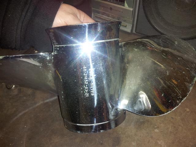

Hello,
Does anyone have information about this propeller? I found a Michigan Wheel spreadsheet online, but only the A1 prop was listed, not the A3 as indicated in the photo.
In case the photo is not easily readable, the number on the prop is
48-31452-A3-21
Thanks in advance,
Pete

No clue me, but for the life of me can't figure why they can stamp all kinds of crap on a prop but the damn pitch and diameter! Every time I run across a prop and know the dimensions? OUT COME THE STAMPS AND A HAMMER if not there!
Re:Information about propeller? 12 years 7 months ago #91338
mercury prop book has it listed for inline 6's. 650 4cyl in line. 650 thru 1500. 70-90hp 3 cyl above serial #A722297 and merc 700-800 Direct reversing with LH rotation.
Re:Information about propeller? 12 years 7 months ago #91339
The -21 tells you it's a 21P, and I think most of the 2 blade bronze Merc 6 cyl props (15 spline ?) were 13 1/8" dia.. It looks like a RH prop to me, but I'm still on some wacky meds!? LOL
I think the A1, A2, A3 designations were production runs or something to do with the amount of cupping? Also possible the pitch or cupping have been "adjusted" somewhere along it's life, only way to know is let a good prop shop check it out or bolt it on and run it. Looks pretty, did you get it from David P in MN?

make sure it is the correct rotation for your motor.
if it has full gear shift it will work. non shift in that rotation is rare. hope you have the motor on a very light boat with that much pitch.

I have a 63 1000 on a 900 lb hull. 21 is a bit too much pitch for it just with me in it. I prefer 19p. Also, I dont like the weight a stainless prop brings with it. BUT! If it's a free prop, give it a try!

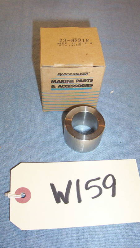

That's gonna be a lot of prop for an 800. Looks like it's chrome-plated brass to me, but my eyeballs ain't what they used to be, either!
You can use a modern-style prop with integral hubs on the old motors, by use of a spacer sleeve, Merc P/N 23-86918 (superceded to 23-86918T).
This sleeve goes up against the square-shouldered prop shaft. Then you use the "modern" Merc flat thrust washer and away you go!
One thing you can do is try the 21" prop, see how it performs. Then you'll have a baseline to help you figure out what pitch you really need.
If you don't have a tach, use an automotive tach on the 6-cylinder setting, and connect to one coil only. This will give you accurate rpm readings to help with prop selection.
HTH............ed

Thank you Ed for the advice, I wasn't aware of the need for the that part for modern props.
