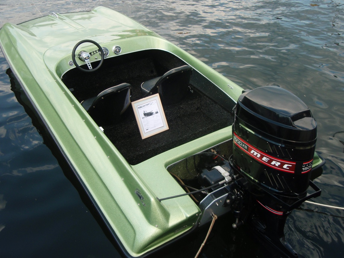

Not to hijack or anything, but it that your Switzer?
Nice boat. :)

Yup, tis mine. It's a 69 Shooting Star...good eye! Motor is a 76 XS with a Super Speedmaster lower unit. I restored the package but kept as much original as possible on the interior, instruments, gel coat etc. Lower edges of stringers were rotted so it all came out, it's all good now. Transom was built up at the factory and had aluminum plates and flat steel braces to support the top from flexing, I replaced the braces with stainless turn buckles which work better and give more room for the tanks, battery and trim pump in the back. Does about 84 mph @ 6500 rpm on a good day. It will only go straight, and needs about a mile or so to get to top speed, it has near zero ability to turn but, that is not the point :-). It's an adreniline rush that lasts all day.
I threw the picture in to show I really do play with XS Mercs and have spent many hours with the both the J blocks and regular 1500's.
I run a "regular" 1500 on a restored 74 Hydrostream Vector.
