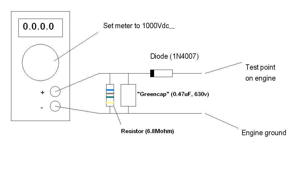

I've also attached a pic of a D-I-Y adapter which you could build from Radio Shack parts for probably less than $5, see this iboats thread for the discussion:
forums.iboats.com/mercury-mariner-outboards/simple-easy-make-dva-adapter-standard-multimeter-374544.html
The Good News is, you can do resistance checks on the trigger assembly and the stator windings, and most of the time the resistance checks alone will tell you if there's a problem there. But the DVA is critical to doing in-depth testing, if you don't find it to be a simple or obvious problem.
