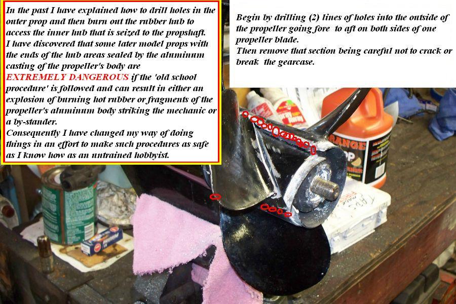

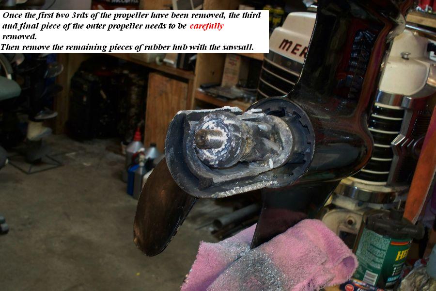

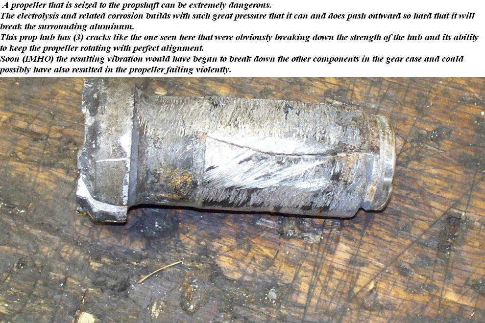

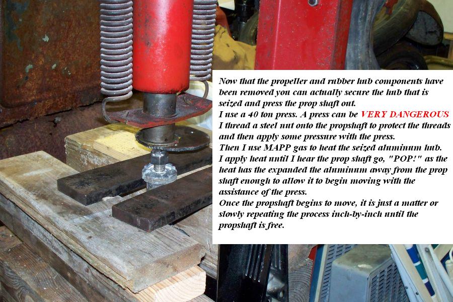

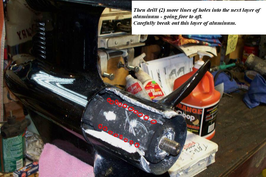

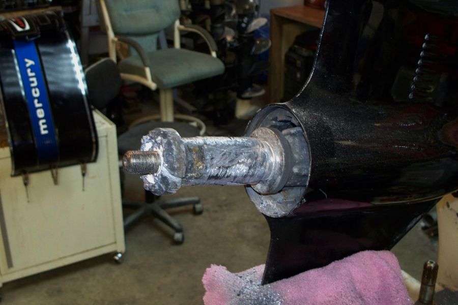

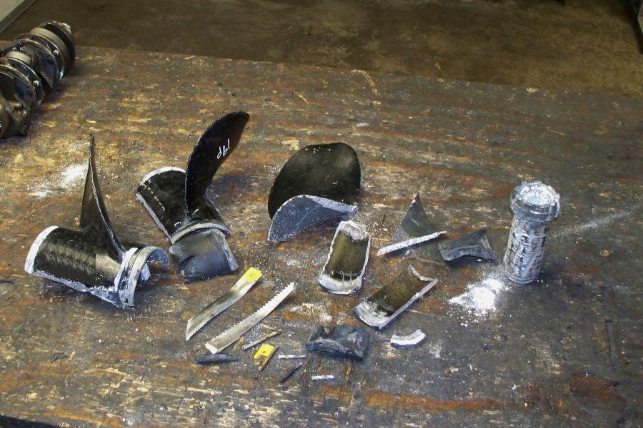

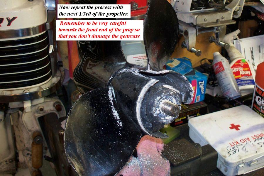

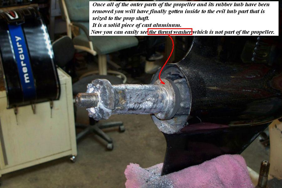

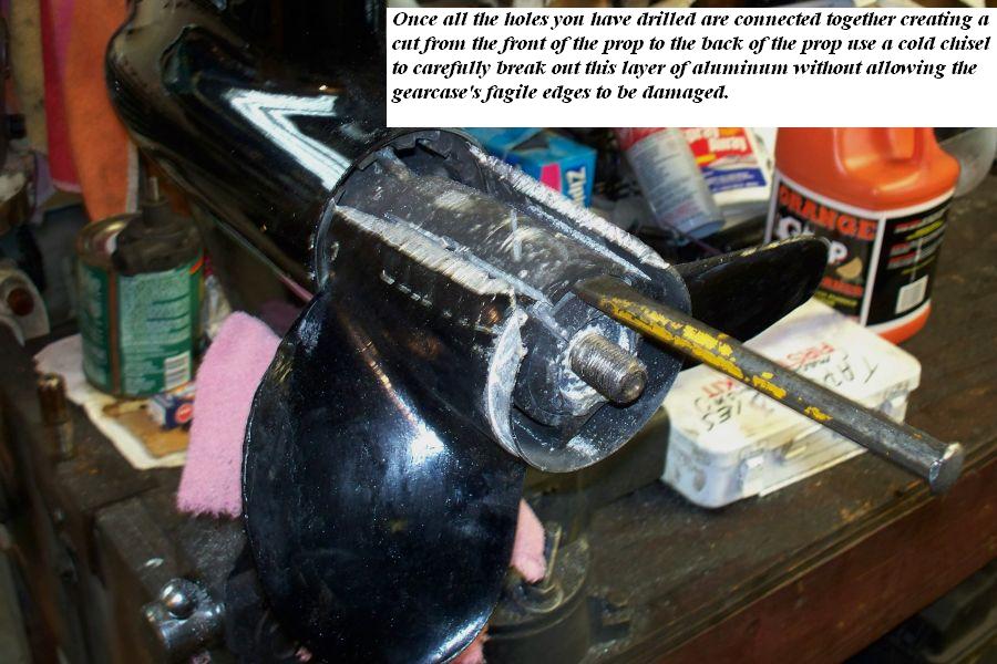

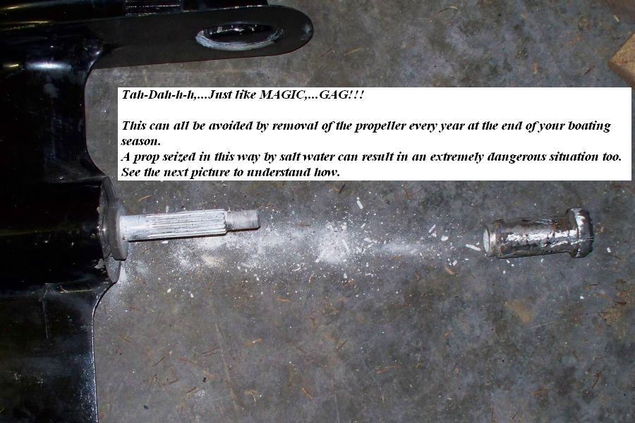

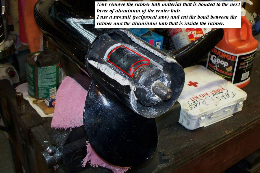

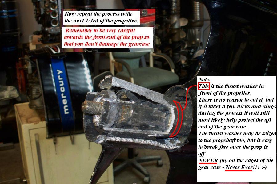

When years go by without the prop being removed and the propshaft splines go uncleaned and re-greased,...The prop can become seized on the prop shaft.
The trouble with attempting to pull the prop off with common pullers is that there is a rubber hub between the outer part of the prop that you are attempting to pull, and not the hub, which is what is actually seized.
Often the heavier stainless props and older bronze props can still be removed with a press against the blades, provided the rubber hub portion is tough enough to hang in there while you press against the prop shaft.
Aluminum prop blades will simply fold or break away if you attaempt to hold the prop by the blades & press on the prop shaft.
Below I have attached a series of pictures showing the safest way I've found to remove a stubborn and seriously seized aluminum prop.
Have fun.
Doc F

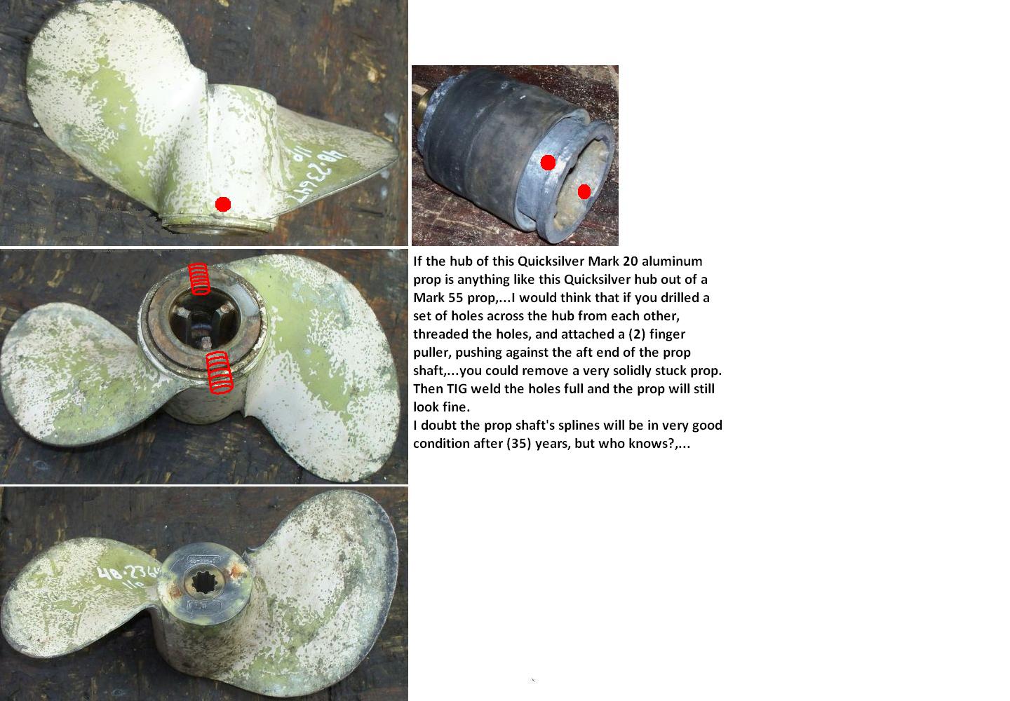

doc, i have a mk 20 and the prop is very stuck, can i save the prop? it has not been removed in 35+ years
Re:Prop is seized on the shaft 12 years 11 months ago #86971
Ponyboy,
Is the prop aluminum or bronze??
If it is bronze,...I would say YES.
If it is aluminum it will probably get thrashed using my means.
I would have to look at a Mk20 aluminum prop to see if there is some way to maybe drill a couple holes in it and then tap the holes & install a couple grade 8 cap-screws through the body of the prop & into the hub & then use these to anchor a two-finger puller.
The holes could be TIG'd later if the prop is still good.
I'll dig one out and get back to ya.
Thom

"doc, i have a mk 20 and the prop is very stuck, can i save the prop? it has not been removed in 35+ years"
Ponyboy,
Sorry it took so long, but here is what I would try.
Doc F
