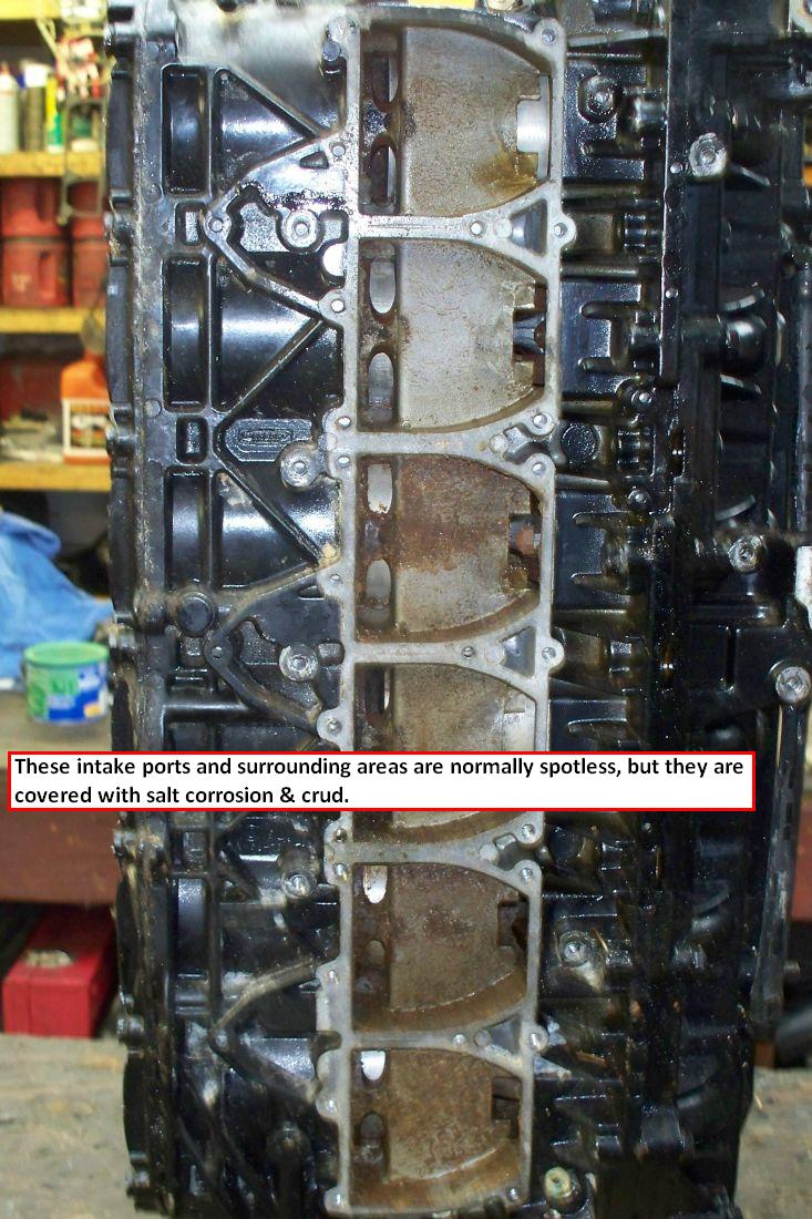

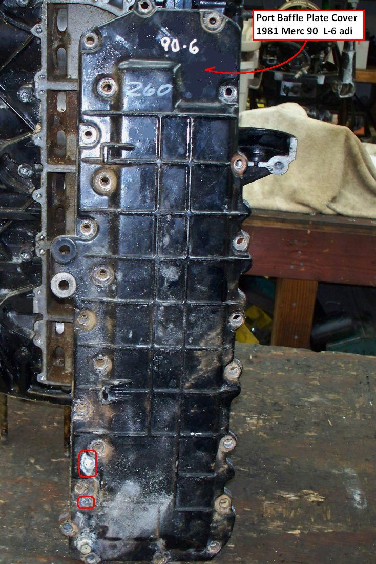

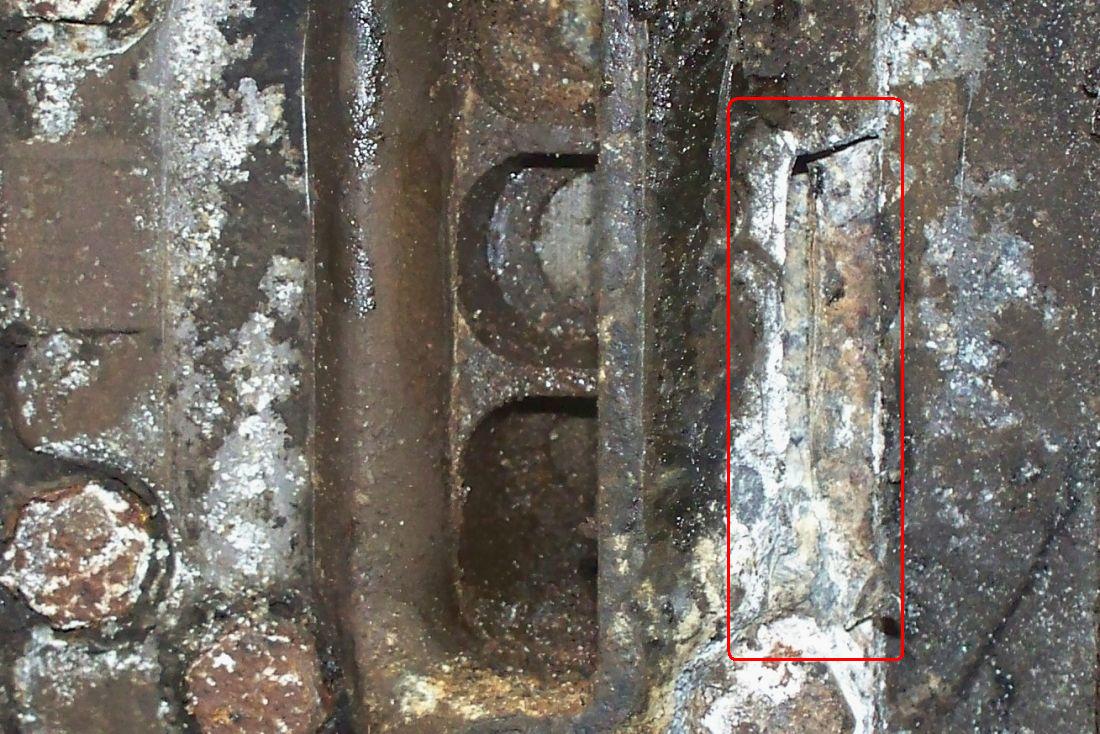

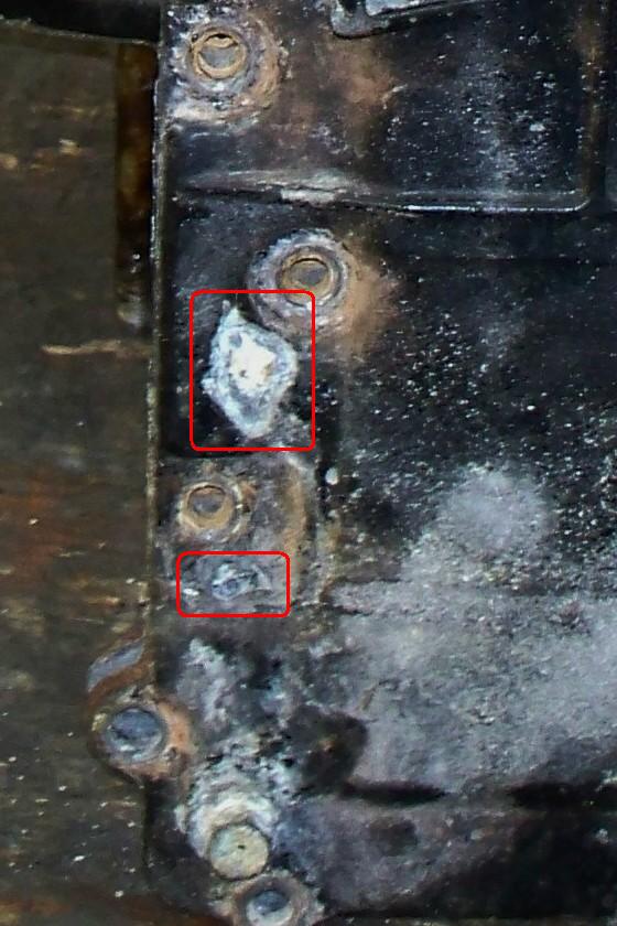

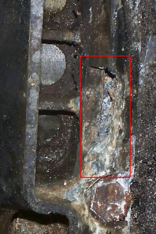

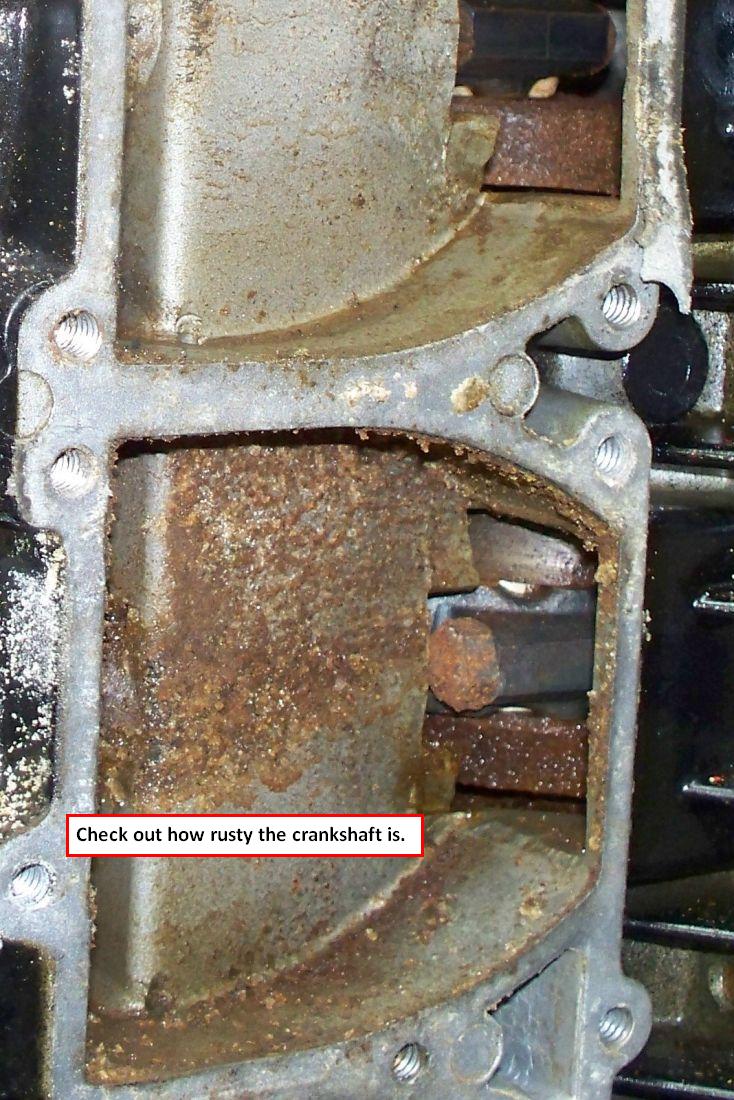

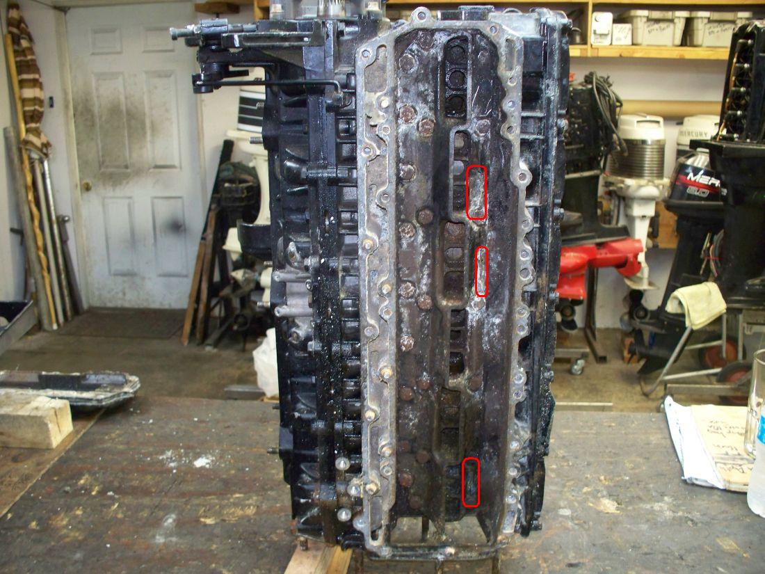

Even when the outside of the Merc is cared for with wash downs & protective chemical coatings, the older Mercs will lose the war with salt water corrosion internally.
The attached pictures are of an '81 90hp inline-6 Merc that was reportedly running fine until garaged for a few months.
I came to me seized, but looking pretty decent - except for one 1/2" circle on the port side cover that had been pushed out from salt corrosion.
I struggle to believe the poor beast could run under these circumstances, but I'm telling it how it was told to me.
I have outlined the areas of the inner water-jacket that are eaten completely through, allowing the water to be drawn into the cylinders and slowly destroy the crankshaft & related assembly.
Doc F

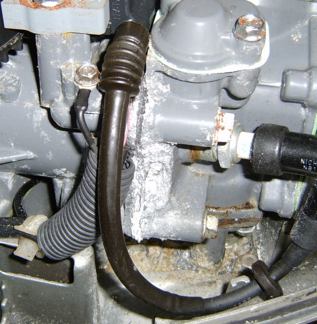

I got another salt story for ya all. Doc, think I told ya about it. Volunteer fireman here gave free me a looked pristine newer 5HP 4 stroke. Honda told him it needed a new block, as water gushing out the head? Got it home and found the following. Salt simple ate out the side the head next to the block! As I had zip to lose, I get the pencil grinder out and dug it all out. Kneaded up some "Water Weld" putty, shoved it it, and well, IT HELD and no water out. Not sure if getting full circulation the motor, as tell tale is awful strong, but had it running in a barrel, then on a 12 foot rowboat, and temp gunning it didn't run hot. Damn ya run salt (me)..YA GOTTA FLUSH! I always if not just fresh, vinegar in Saltaway dispenser summer. Let it sit a bit, and flush fresh. Winter, use Saltaway. My old 125 Force on the 20 footer, still runs fine after 20 years!
Heres some pix..
Re:Classic Mercs lose the battle to Salt Corrosion 12 years 11 months ago #86896
I think that Merc went swimming in the ocean Doc!
That is a common issue with Hondas Robbie, salt water just eats them up yet they will run as strong as Hell. Amazing little engines.

How much effort / risk / benefit to taking off the water jacket and cleaning out any corrosion or other build up? Does taking off the jacket (I assume that is the big plate on the side) give you enough access to clean out the water channels? I was considering it last year when I had the beast all apart for the paint job and PTT retro fit. Ran out of time if I wanted to get out on the water that season
Re:Classic Mercs lose the battle to Salt Corrosion 12 years 11 months ago #86919
Peter,
If you are referencing your early 1000, it would be quite an undertaking if it has ever been in salt water.
You would need to lift the powerhead to remove the port side cover & baffle plate, and if a salty, you'll most likely have quite a struggle with the lil cap-screws to keep them from snapping off.
Then you would have very good access to the port side water-jacket areas.
While the powerhead is up, you would probably want to remove the water-jacket cover around the spark plugs too. Another risky maneuver on a salty.
You would want to check & clean the hole for the water to drain out of the bottom of the #6 cylinder while you have the beast up in the air. It is about an 1/8" hole that makes a big difference in whether or not salt particles have a chance to build up in the water-jacket under #6 cylinder.
Surprisingly, Merc stopped putting this hole in the 1000ss block series, and consequently those blocks are more susceptible to corrosion break-through by the lower exhaust port of #6 that will result in water intrusion and permanent destruction.
I drill the hole when I'm building an SS TIGER (1000, 950, 1100)
But,...Once thoroughly cleaned it certainly should add longevity to your cooling system.
I've started having the inside surface of the top cover, the port cover, and outer surface of the baffle plate media blasted and then powder coated to see if this process will slow down or stop salt corrosion, but I am still investigating & unable to make any claims of confirmed improvement.
One of these days I'm gonna blast the water-jackets in the block and if I can get them clean enough apply a powder coating there too before having any of the cylinders, or gasket surfaces remachined for reassembly.
If anyone has already explored this idea, I would love input.
The Mad Doctor Frankenmerc

Well, the story on my Merc is she was only fresh water ever. I've only run it in salt a few times since I've owned it. To get to that salt water I run down a fresh water river for about two miles. So the return trip is about 1 to 1.5 miles going from salt to briny to fresh. The last mile or so is fresh water.
But I have always wanted to see whats up inside the water channels.

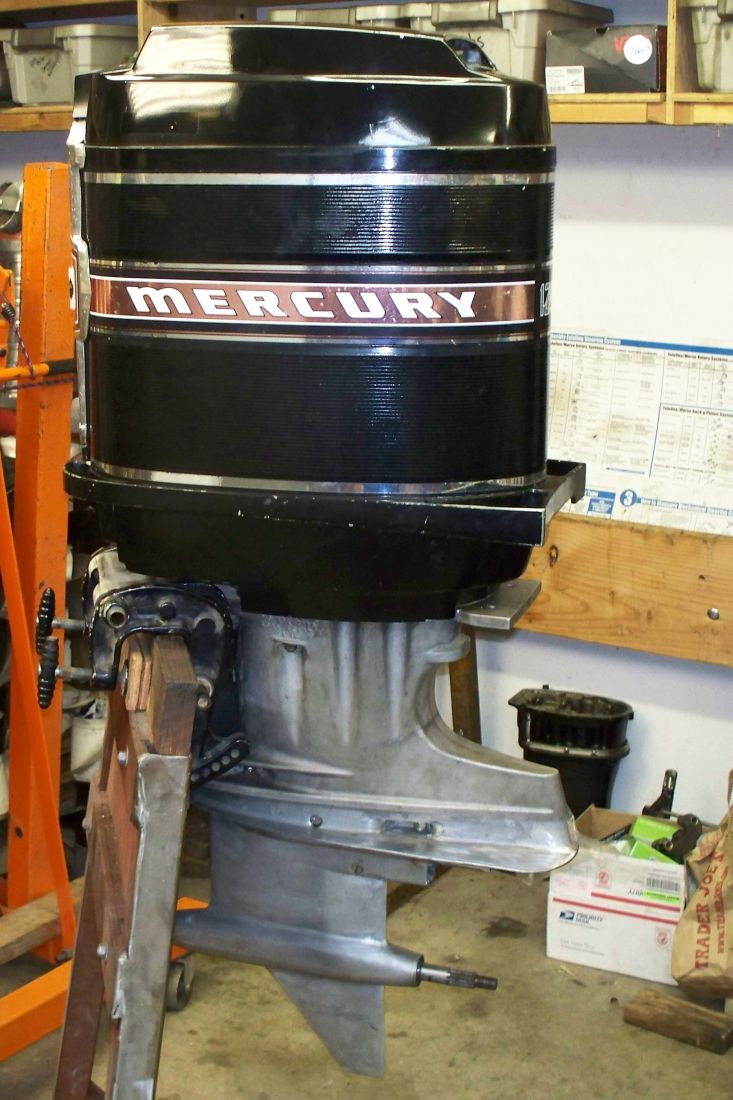

Anyway,...There was no lower unit included so I don'y know if they had the right anode or not.
The poor beast came from up your way - Bellingham or Mt Vernon - somewhere around there.

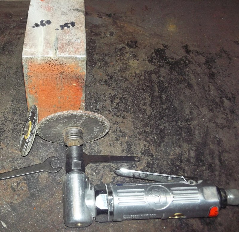

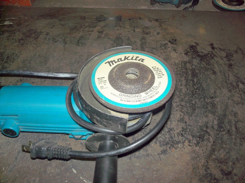

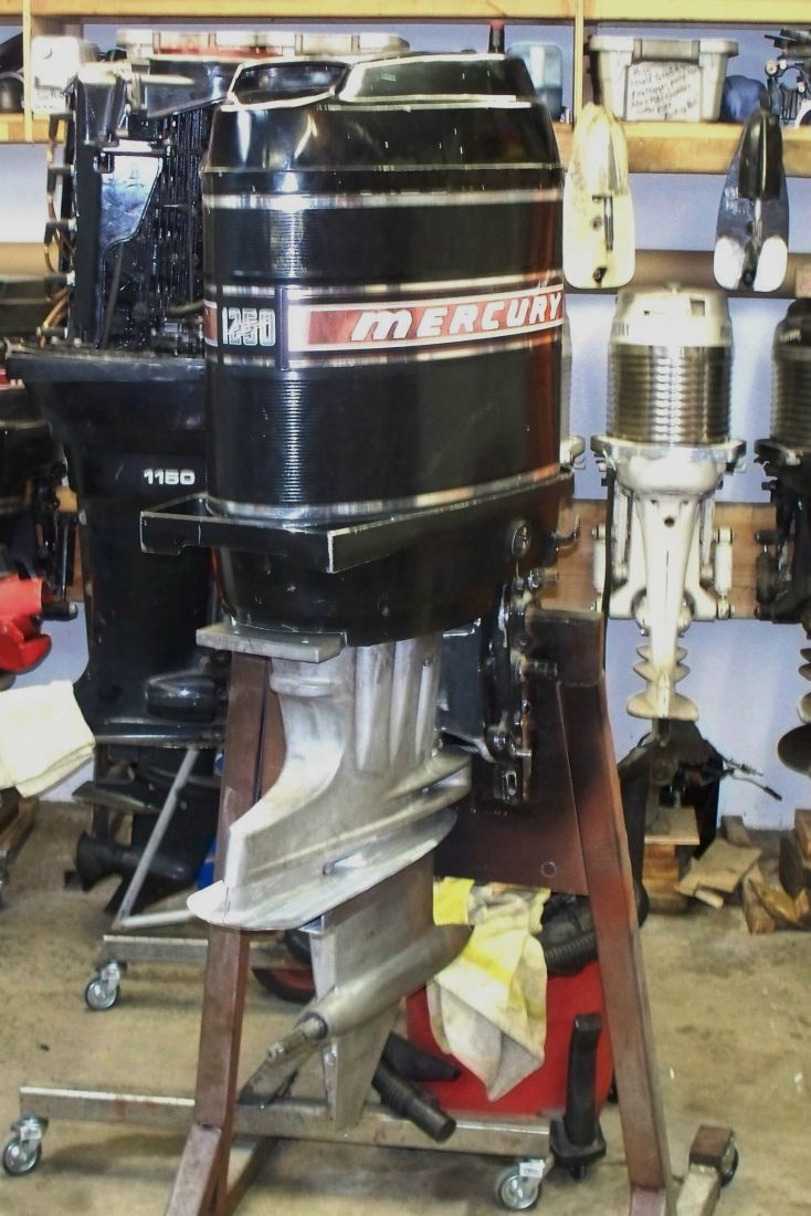

Doc! Thats a cute lower on the 1250! Anyway, on the anode thing lower? IMO ZIP to do with anything but a LU sitting parked in salt. Thats to be sacrificial used up, before the aluminum gear case. Aint got nothing to do with salt water, sitting to dissolve in the block water motor passages. Salt water damn sure aint battery acid, but when evaporated, and just salt? Theres the problem starting! FLUSH FRESH!...easy to do!
Anyway Doc, on cutting a aluminum prop off? Messed today with some my "how to do it easy stuff" 21 years Machinist, and as any know, ya can't grind aluminum a stone wheel as loads up.
BUT! Did some with a .060 , and and a .160, on a angle grinder, with abrasive cut off wheels. Messed with a block aluminum. Does NOT load up but wears down instead. Way easier then drilling holes, and bust out. Just break off a blade for access the hub. Heres a few pix just took. Hard to see the small blade wheel, but the .160 shows fine. Last is what ya start with first, a 4 inch abrasive on a angle grinder.(PS, Doc as like the idea bronze prop, simple drill and tap studs, for something to "pull on!" Anyway, pix next...

Re:Classic Mercs lose the battle to Salt Corrosion 12 years 11 months ago #87362
Salt kills any outboard. At the minimum, it locks the bolts into the block, making them almost impossible to remove without breaking. I wanted to build a Mk 75 many years ago, but couldn't find one that would clean up enough to be worth it. Water jackets deeply rotted, covers rotted, lower units ruined by corrosive salts. I have a fresh water only '63 650 that is in nice original condition. I refused to sell it to someone that wanted it when I found that they planned to use it in salt water. The narrow passages on inlines traps silt and salts. The cover gaskets also have some areas where the gasket shrouds part of the passages, and even more silt and salt will settle in these spots. The cylinder covers are really prone to being eaten away.
Also, an anode wouldn't have done anything for that engine in Doc's photos. The engine and boat doesn't need to be left in the water for the damage to happen. The silt and salts are lodged in the engine, and this is what accelerates the corrosion.

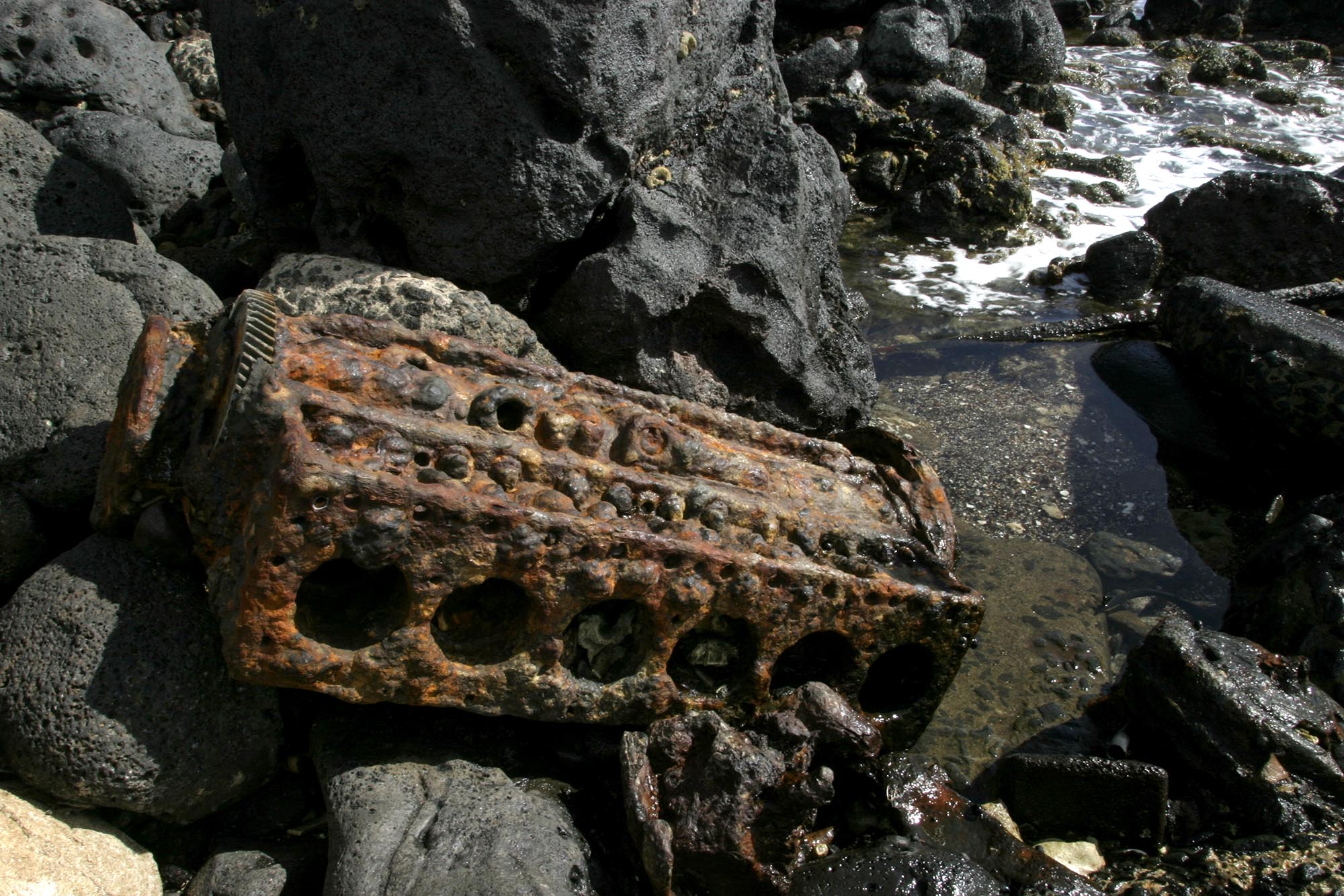

Re:Classic Mercs lose the battle to Salt Corrosion 12 years 10 months ago #87772
Found this block on the coast of Kaui in 2004. Probably all gone by now.
Its amazing what salt water can do to iron.
I am glad I live in the midwest. Except our cars rust out ever 5 years from road salt in the winter.
C

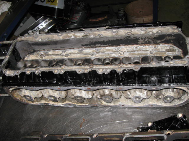

Re:Classic Mercs lose the battle to Salt Corrosion 12 years 9 months ago #89303
Over here in the UK most of us have to boat in salt if we want to go above 10mph. My '84 115 has been used in salt for all its life but was always flushed. When I rebuilt it a while back ALL the water jacket bolts came out, not one broke. I use a method many of you will be aware of - give all the bolts a good hard whack on the head (use a drift) a few times the use a 3/8 rattle gun SET TO ITS LOWEST SETTING & gently rattle them out - use plenty oh eat if required. Doesn't always work but does most of the time.
I always flush mine for about 20 mins in a 30 gal drum with a constant fresh water feed into the bottom. After 20 mins I turn the hose of so the water heats up a bit - I reckoned that would shift any residual salt. If I am leaving it I will add anti freeze to the water or soluble oil (as used in a machine shop).
Works for me.
Picture shows the block after stripping & washing off. Only light corrosion visible.
It would of course be better if it had been a fresh water motor but it isn't bad for a salty beast!
