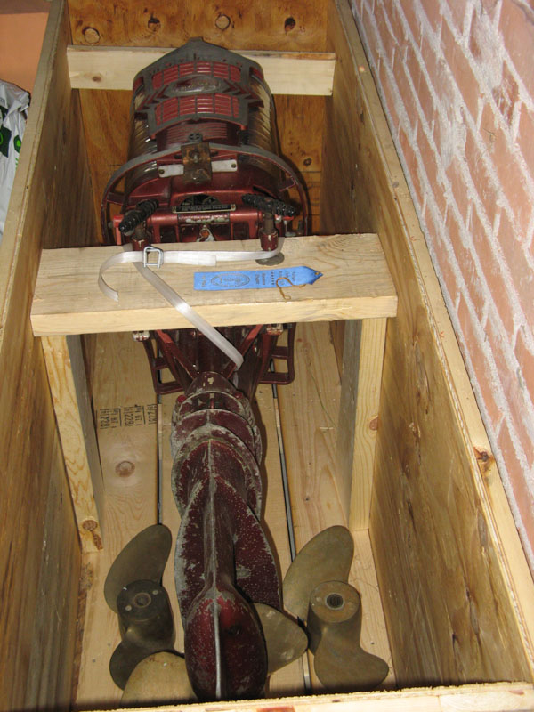

Thanks for your offer but I better find a long shaft motor to buy than the trade option. Shipping is expensive,too! The Mark 75 was crated and shipped to the Netherlands for $ 550.00. Local import duties and VAT was another $ 420.00.

Actually shipping is not that expensive. As you may remember the shipping of the controls was about $ 70.00. If the crating of an outboard is about $ 150.00 to $ 200.00 there is $ 350.00 left for shipping.
Import duties are not too bad in the Netherlands.About 2 to 5 %. The VAT is 19% over the purchase + shipping +custom forms. That is what makes it expensive.

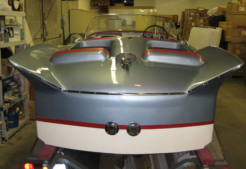

Please tell the owner of the long shaft parts that I decide at the end of next week if I will buy or not. Yesterday evening I received a mail that the chris craft silver arrow { the blue one on the picture} has a chance of 95% to be sent to Amsterdam.
It is standing since october in Baltimore docks after it felt of the ramp while loading, and sunk.
If it comes to Amsterdam I need my time { and money} to restore the Arrow and the other projects have to wait for a {long} time.

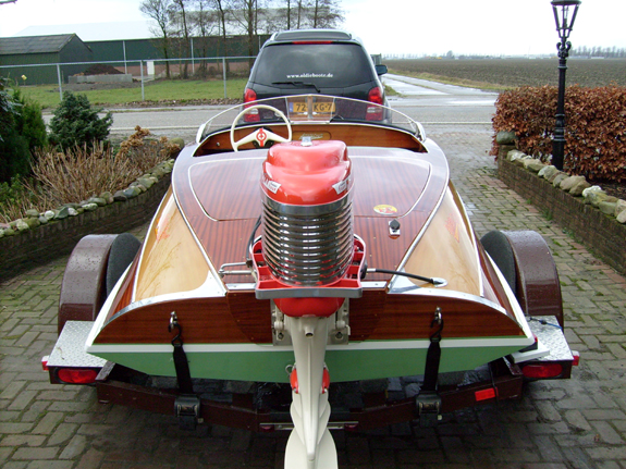

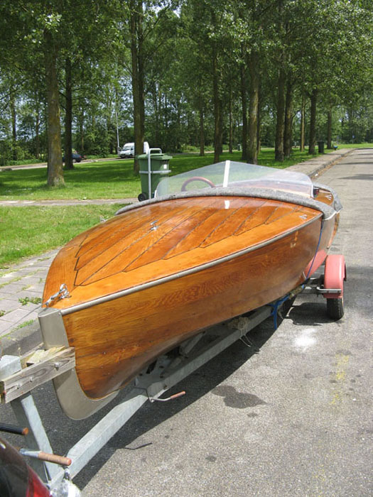

The short shaft is designed for a recommended transom of 16 1/2" and long shaft for 20 1/2" . My Aristocraft Torpedo is designed for the Short shaft and the "De Hart-Miltenburg" { the wood boat in my previous posting} for long shaft.
