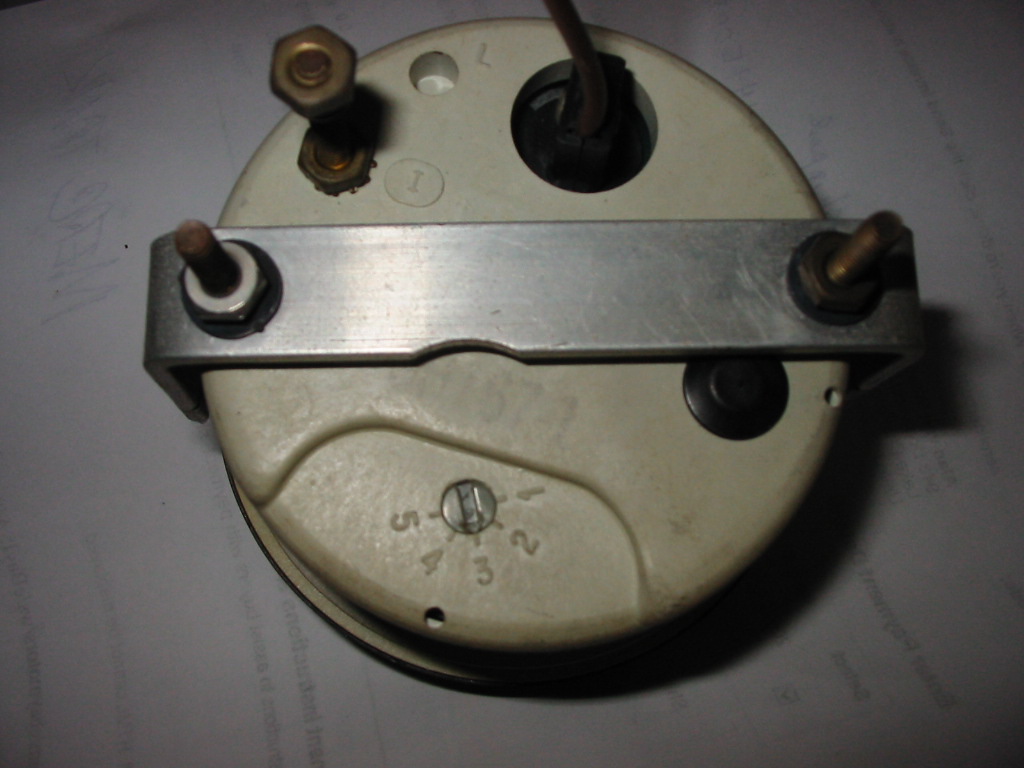

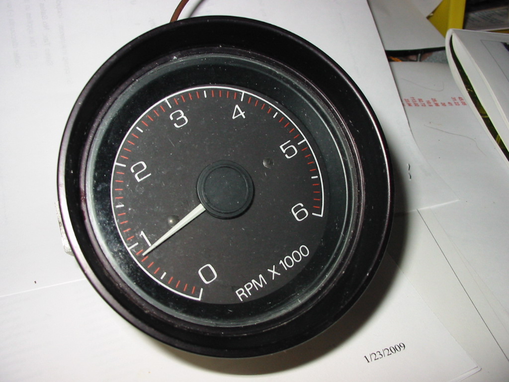

while we are talking about techs has anybody got and idea of how to hook up this tech. The guy I got it from said it came out of a boat.
It says its a KYSOR Medallion. It has 3 post labled I S G . Don't know what the posts hook up to.
Mike aka pathfinderz1
Re:Tachometer hook up 16 years 1 month ago #8936
I + with ignition on S sendor G - ground.sendor could be another unit,points or alternator. i dont know. try to get a manual on line.
Re:Tachometer hook up 16 years 1 month ago #8938
I have look all over the internet for info on this tech and nothing including the makers site. Don't want to burn it up then out the money I paid for it.
Re:Tachometer hook up 16 years 1 month ago #8946
I'm on my lunch break at work, I think we've got some Kysor books here. I'll look and let you know this evening. You've got the terminals identified correctly, just need to know which setting on the switch.
Re:Tachometer hook up 16 years 1 month ago #8949
Since there is a light the unit will need to be grounded some how; guessing through one of the mounting studs.....
Re:Tachometer hook up 16 years 1 month ago #8952
Not worried about the light. Haven't got the boat setup for lights yet. The mounting post on the left is G and right is S.
Marks thanks I hope you find the manual for this.
Thanks
Re:Tachometer hook up 16 years 1 month ago #8964
Mike, the books are not there anymore, but I just shot you an email with some contact info for help. Let me know how it works out, okay?
