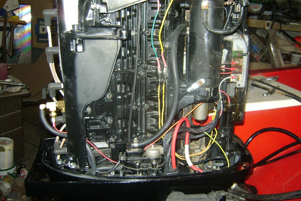

Does anyone know if it is possible to install a water pressure gage on one of these old girls? Seems to me it would be a nice way to keep track of the water flow through the block.

check for a pipe plug on the rear water jacket or on top of the block.
Re: 1982 Merc 115 13 years 2 weeks ago #85364
Water pressure, water temp, in with the pee tube.

Re:1982 Merc 115 13 years 2 weeks ago #85510
On my '77 115 I just have a tee at the point on the block where 50's flash has the fittings on his. One side goes to the gauge, the other to the "pee hole". It doesn't stick out as far because he has an extra fitting for the temp gauge. I figure as long as I have pressure,I don't need to worry about the temp.

Wish I could. The powerhead is in Key Largo, FL at Chris Carson's getting the "special" overhaul. It;s just a "T" in the pee hose hole.
