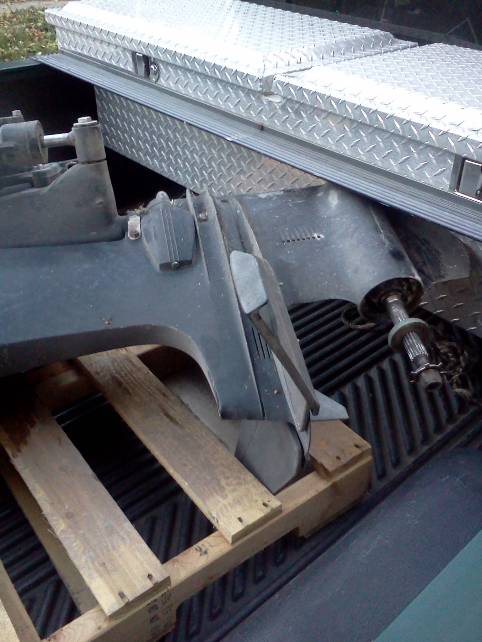

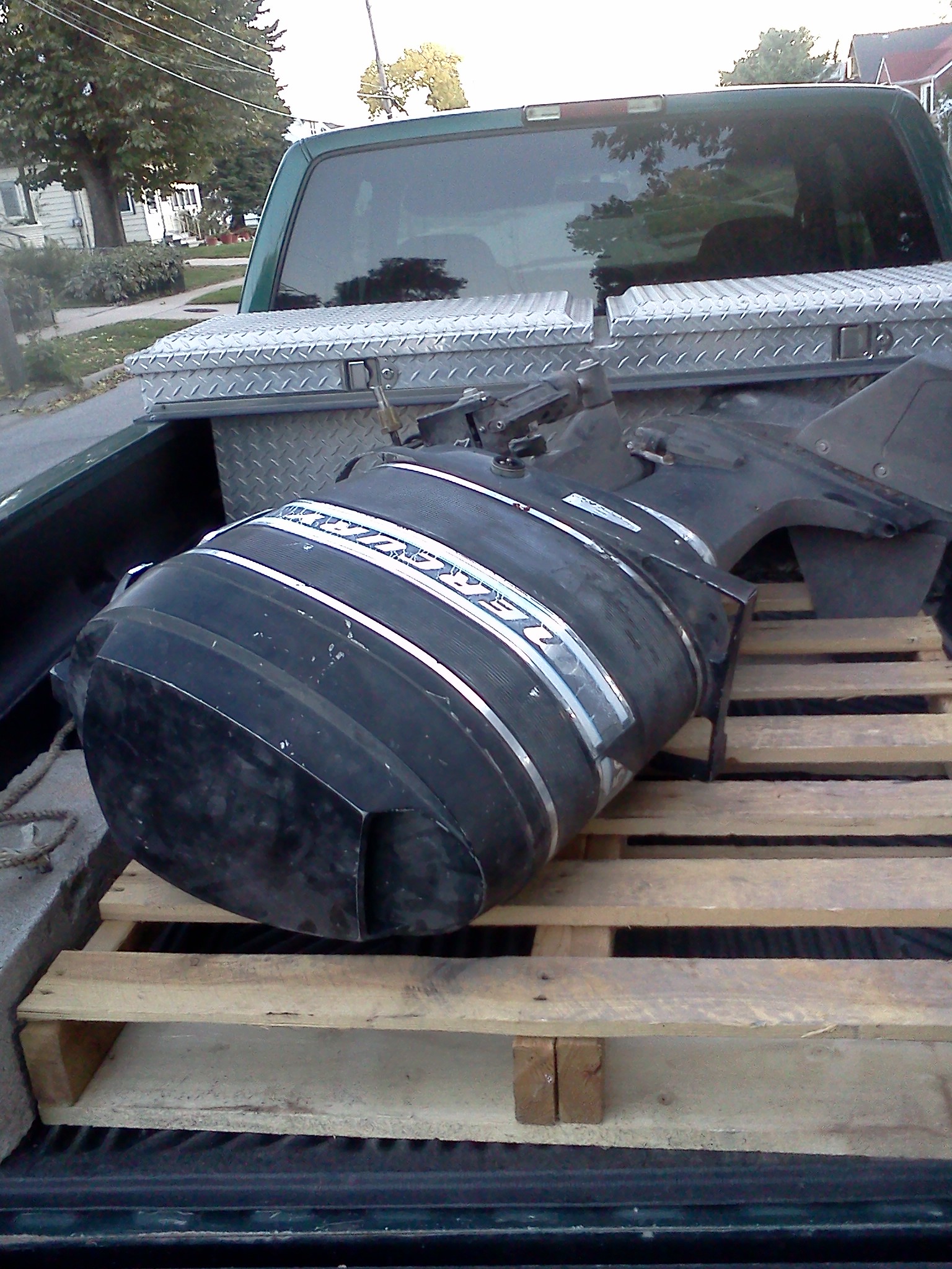

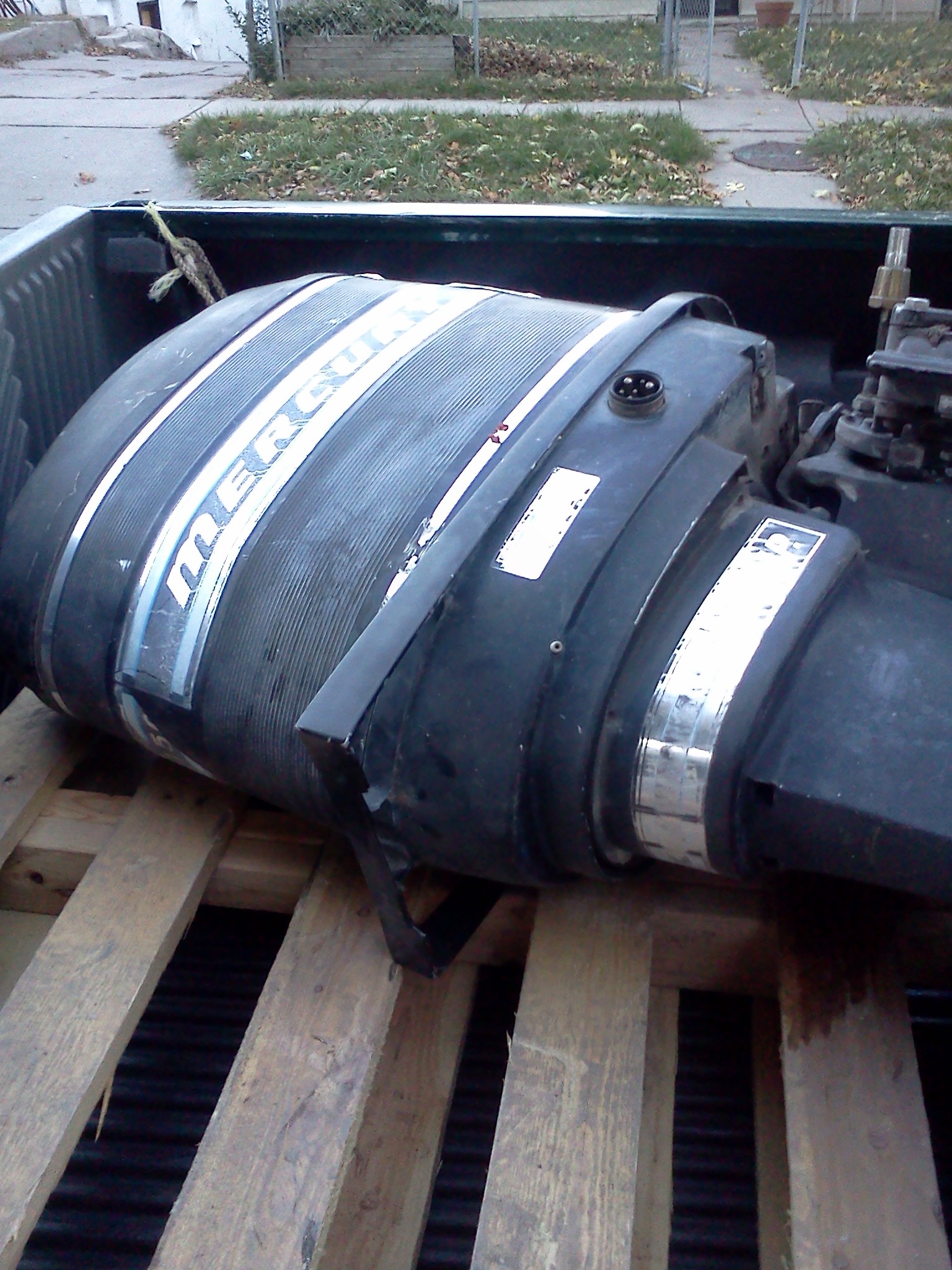

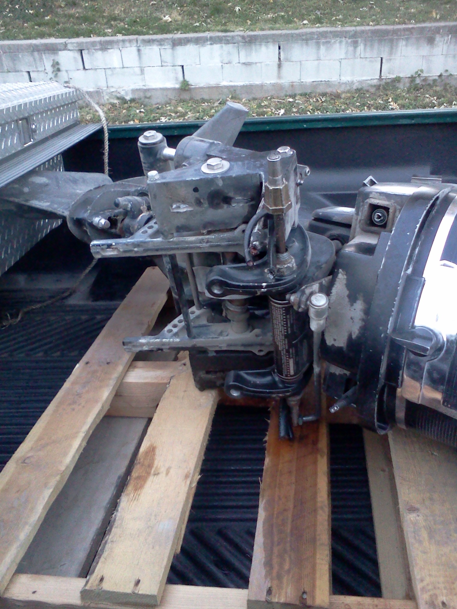

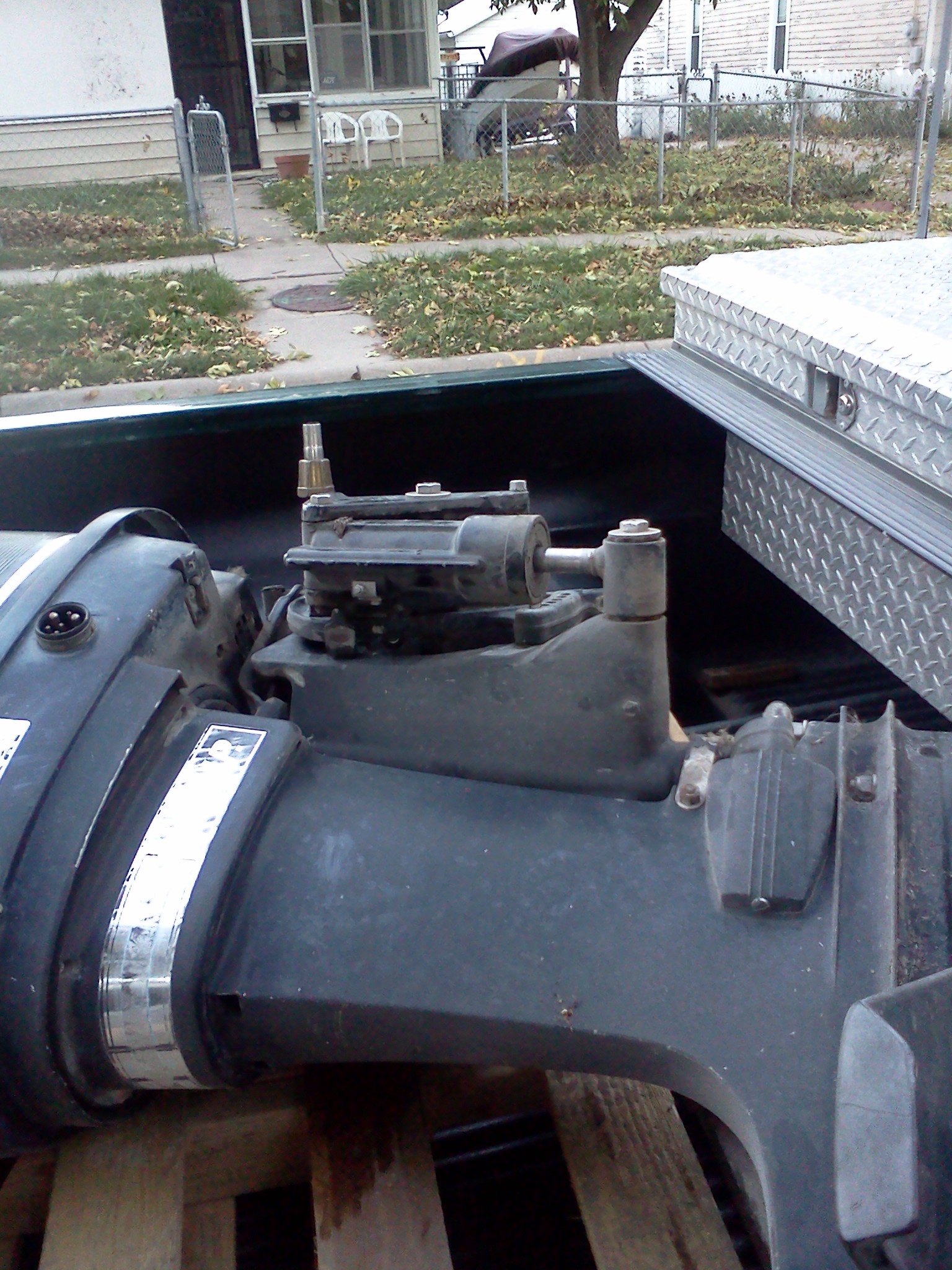

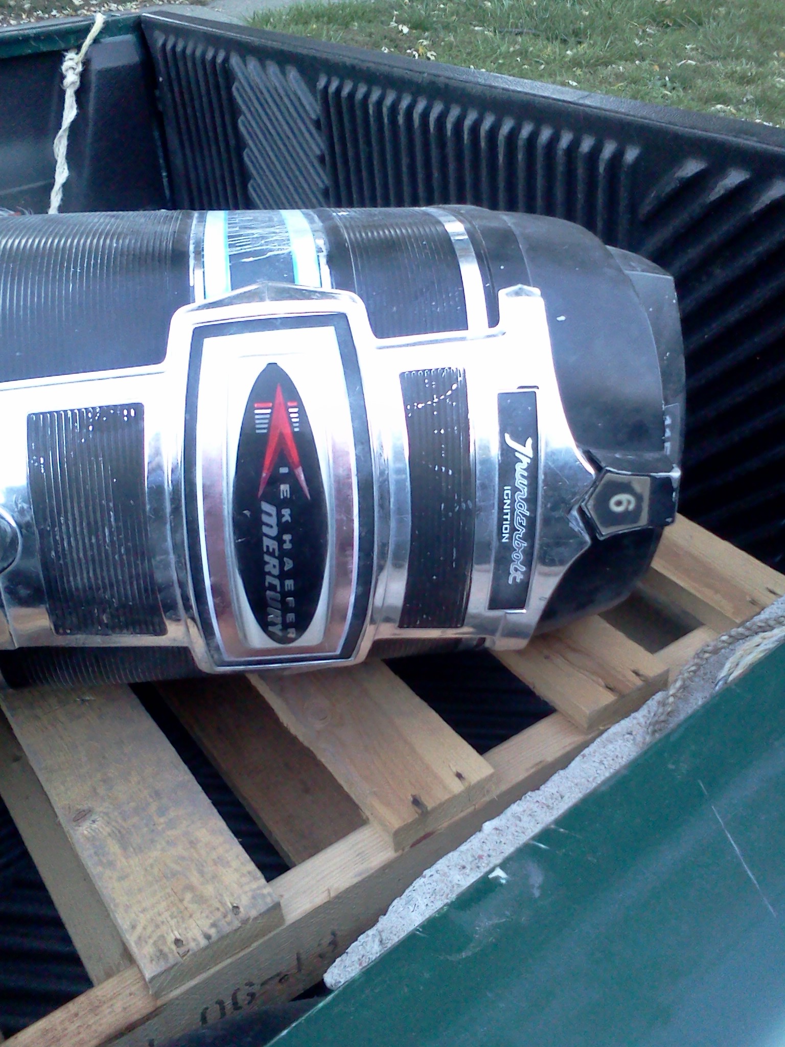

Well I picked up the 115 today. The motor is not in too bad of shape. I will need to build a new stand for this one. Here are some pics of it in the back of the truck.
Re:79 Merc 115 hp. 13 years 2 weeks ago #85370

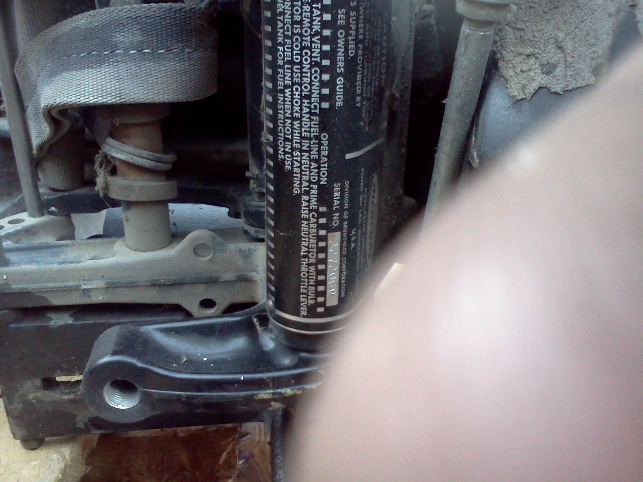

That does not appear to be a 79 motor. Very common these days to see motors misrepresented.----Serial # is the only way to confirm.
Re:79 Merc 115 hp. 13 years 2 weeks ago #85371
wow power trim.
Re:79 Merc 115 hp. 13 years 2 weeks ago #85373
Ok, I checked out the serial # and it looks like it may be a 1972.
Re:79 Merc 115 hp. 13 years 2 weeks ago #85406
Skip if it is a 71 or 72 the bolt pattern of the power head to lower end will be different than 73 and up. Nothing wrong with that, but it does limit your parts choices. Looks complete.

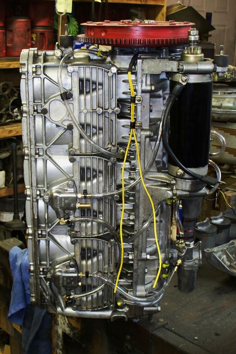

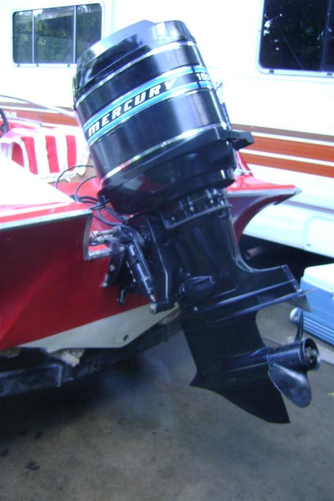

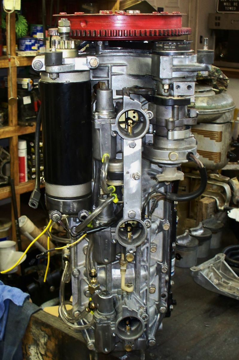

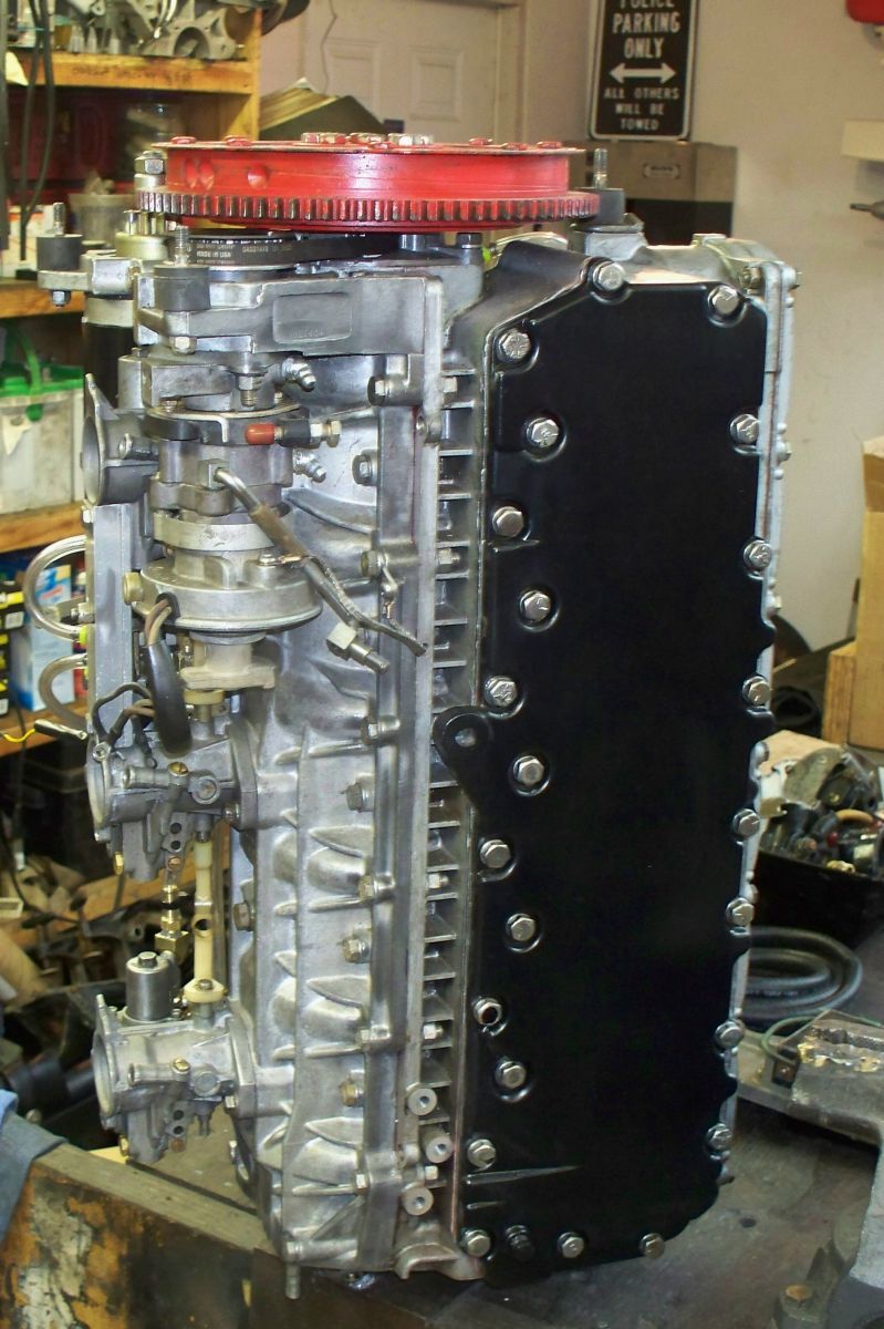

I'm just finiishing up a nice rebuilt 1350.
Still need to add a tell-tale to the top of the block, andstart tracking down inner cowl supports, but she's getting close. :-)
Doc F
Re:79 Merc 115 hp. 13 years 1 week ago #85666
Sweet looking motor there Doc. Is that clear fuel line you are using on this motor? Skip.

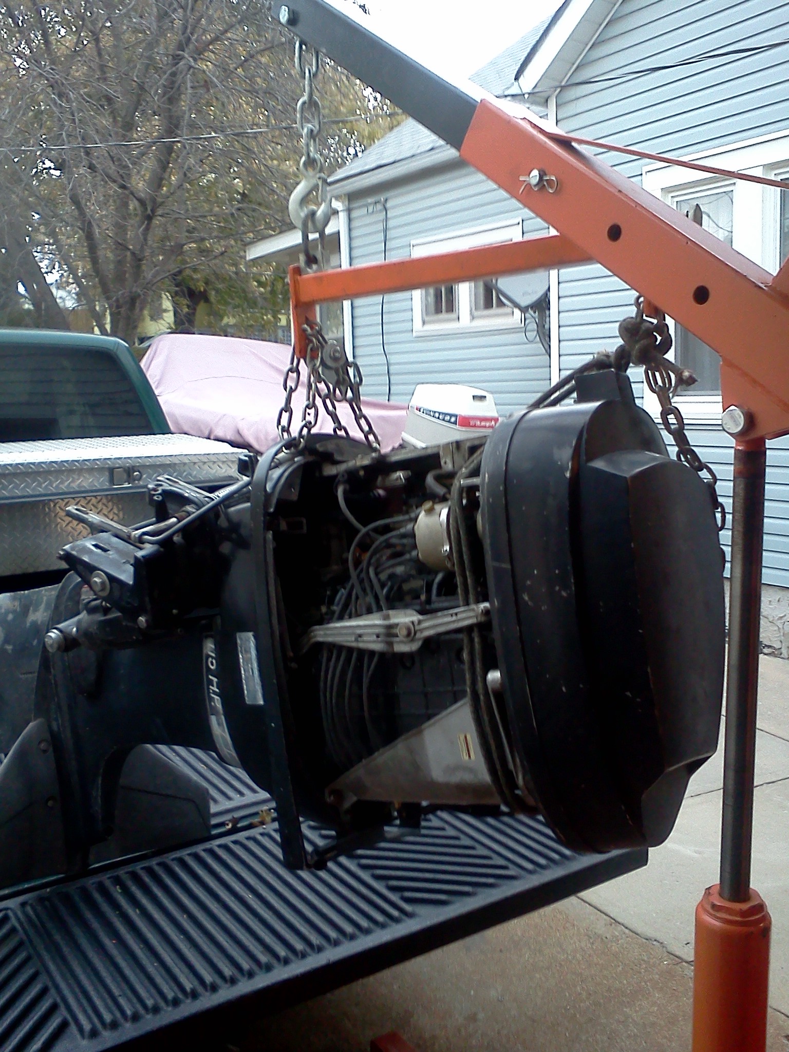

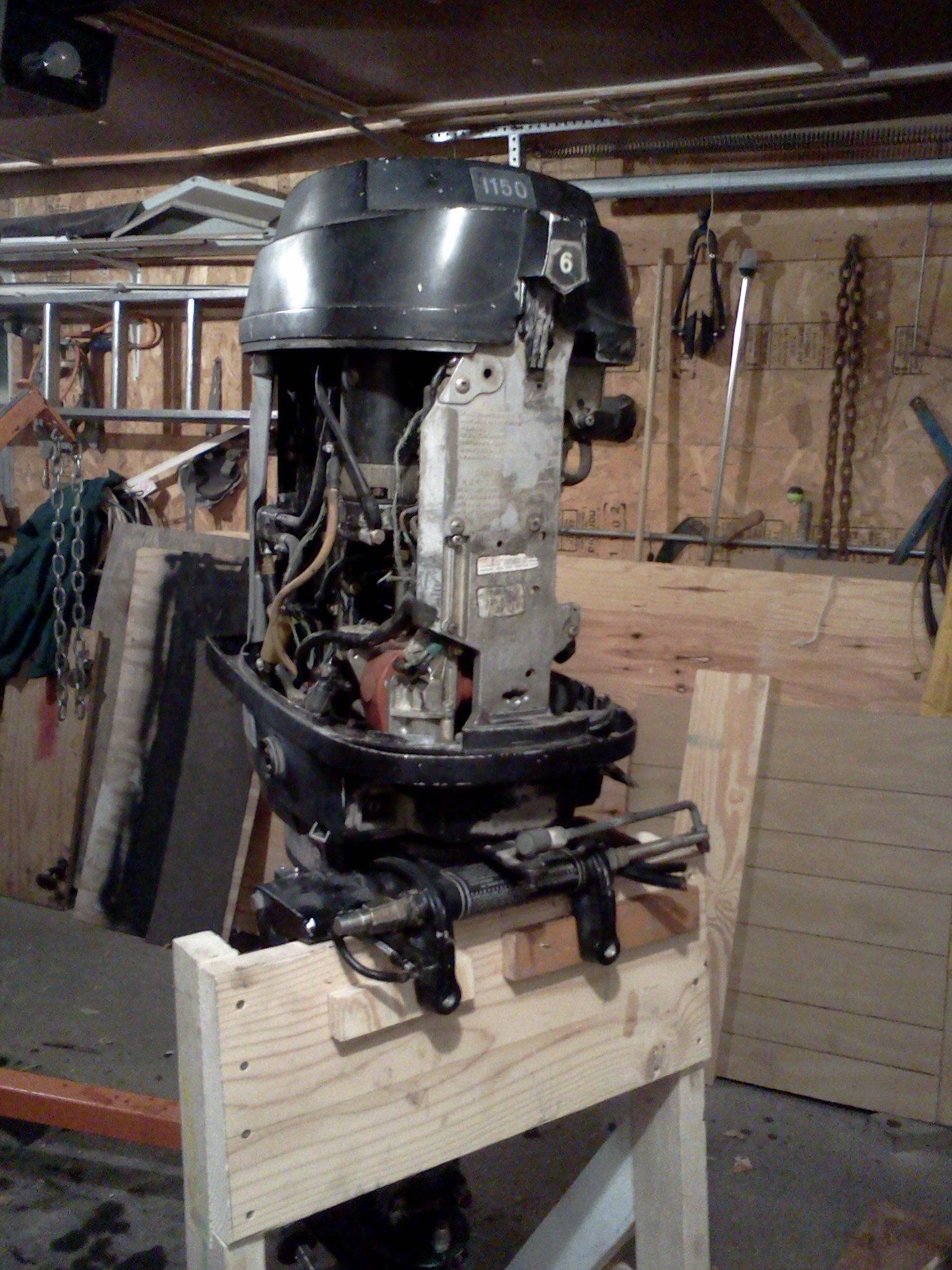

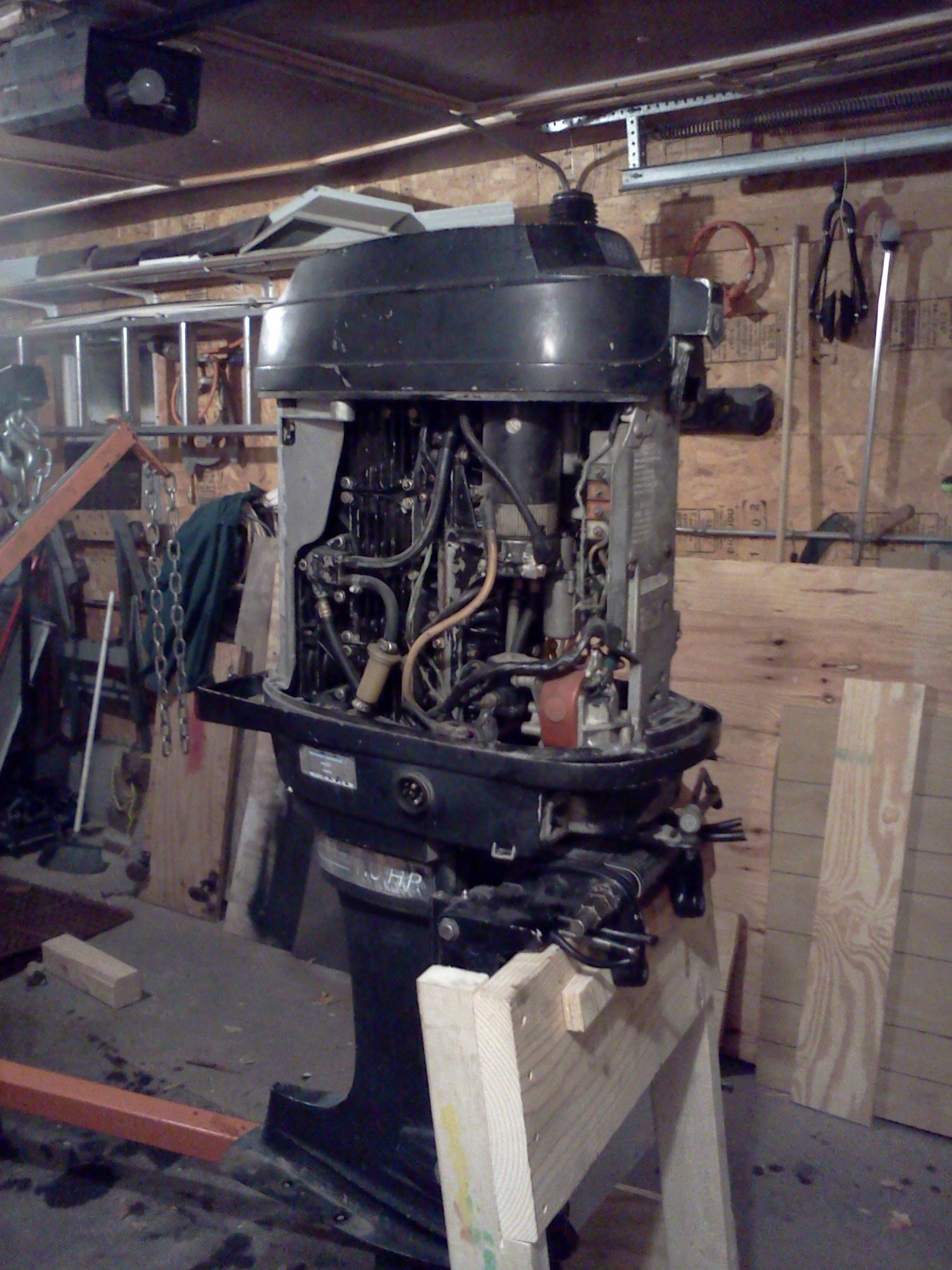

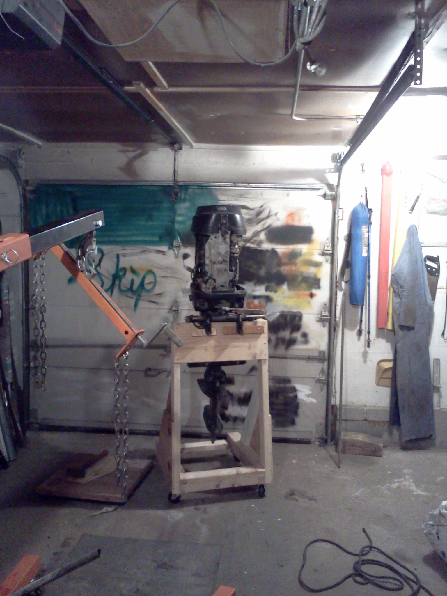

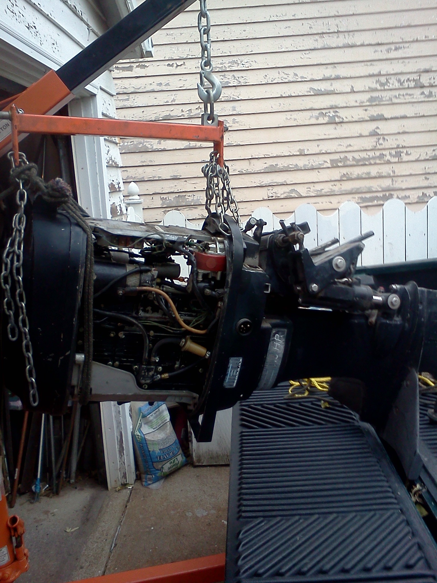

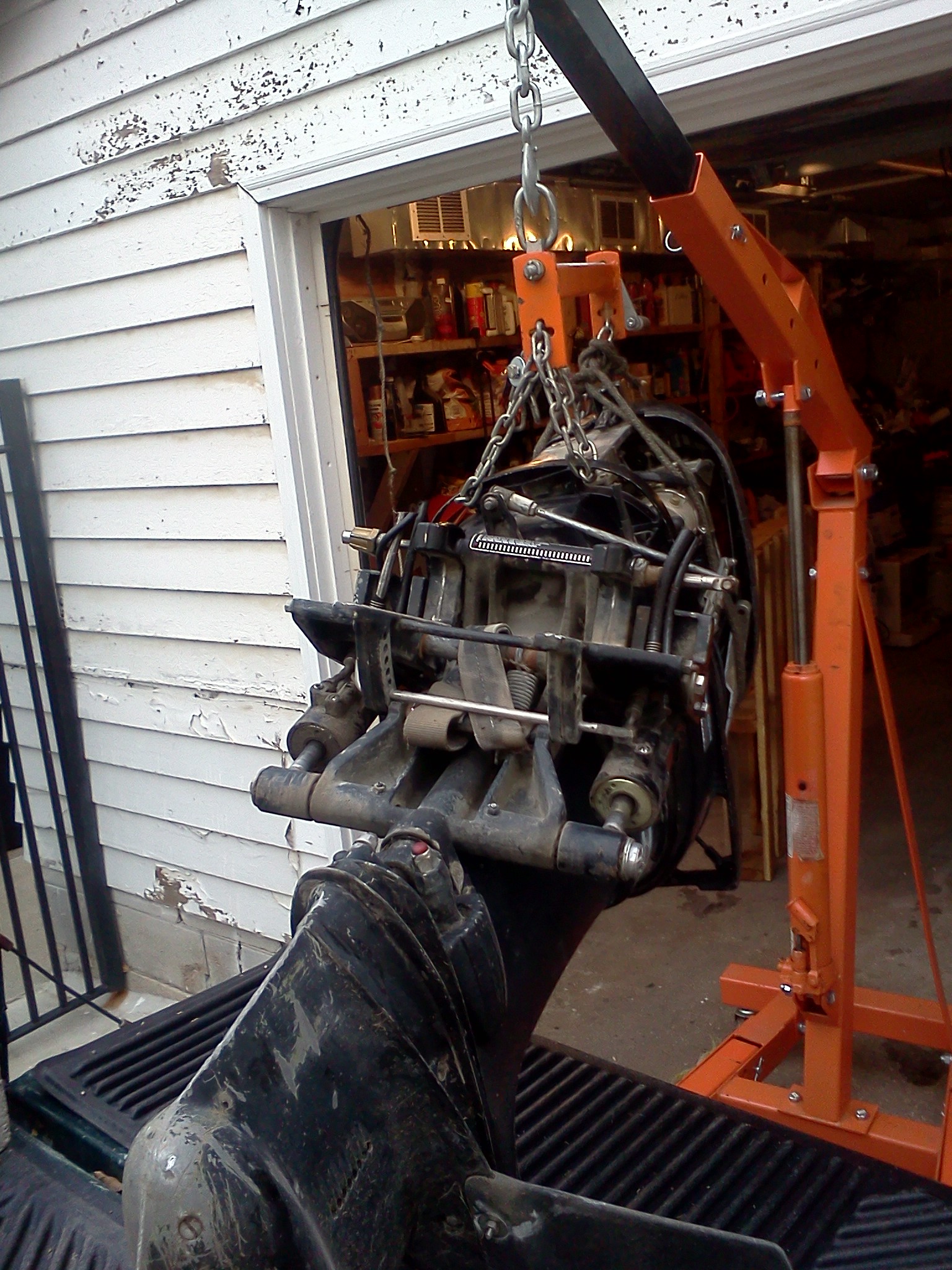

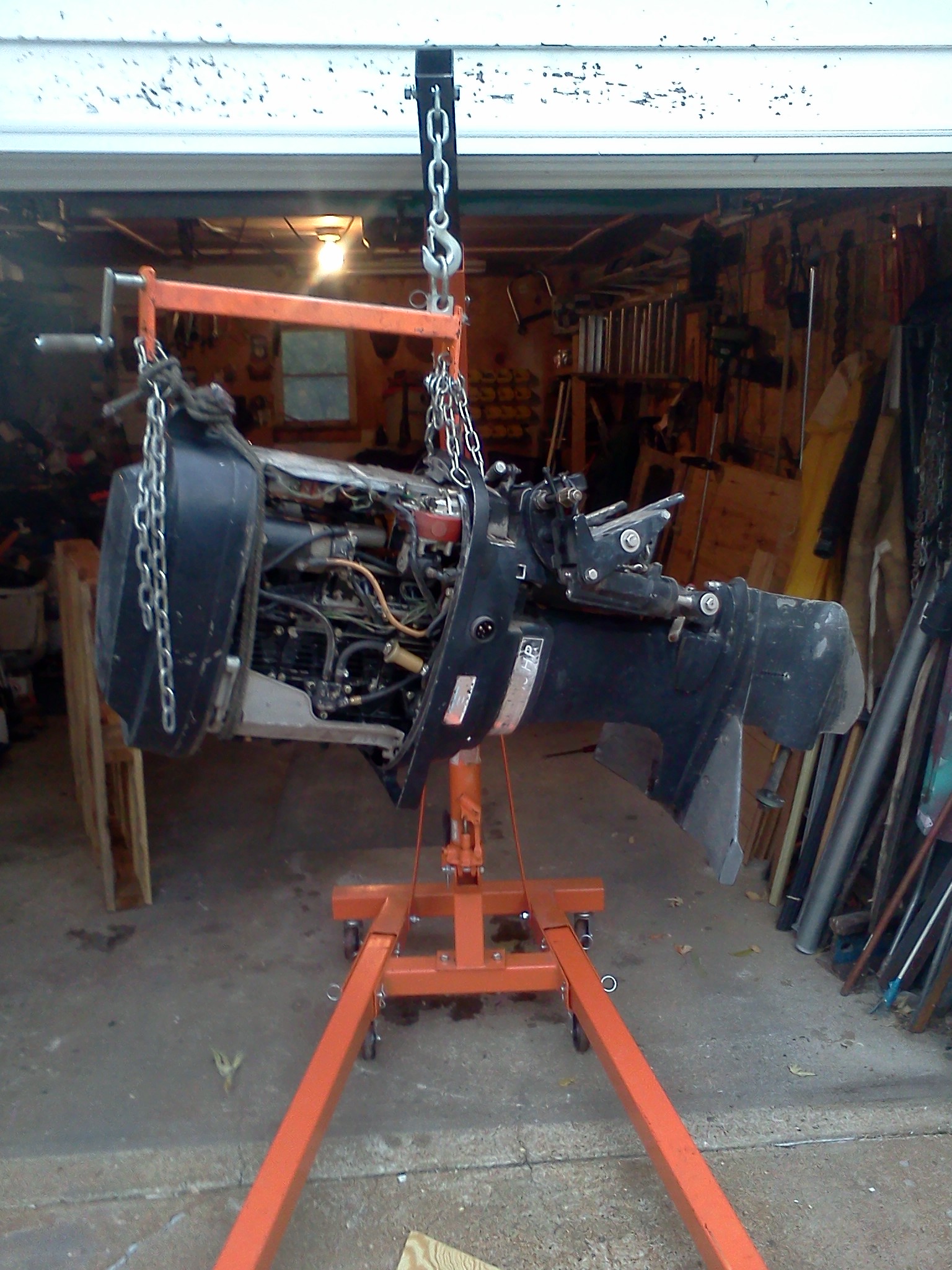

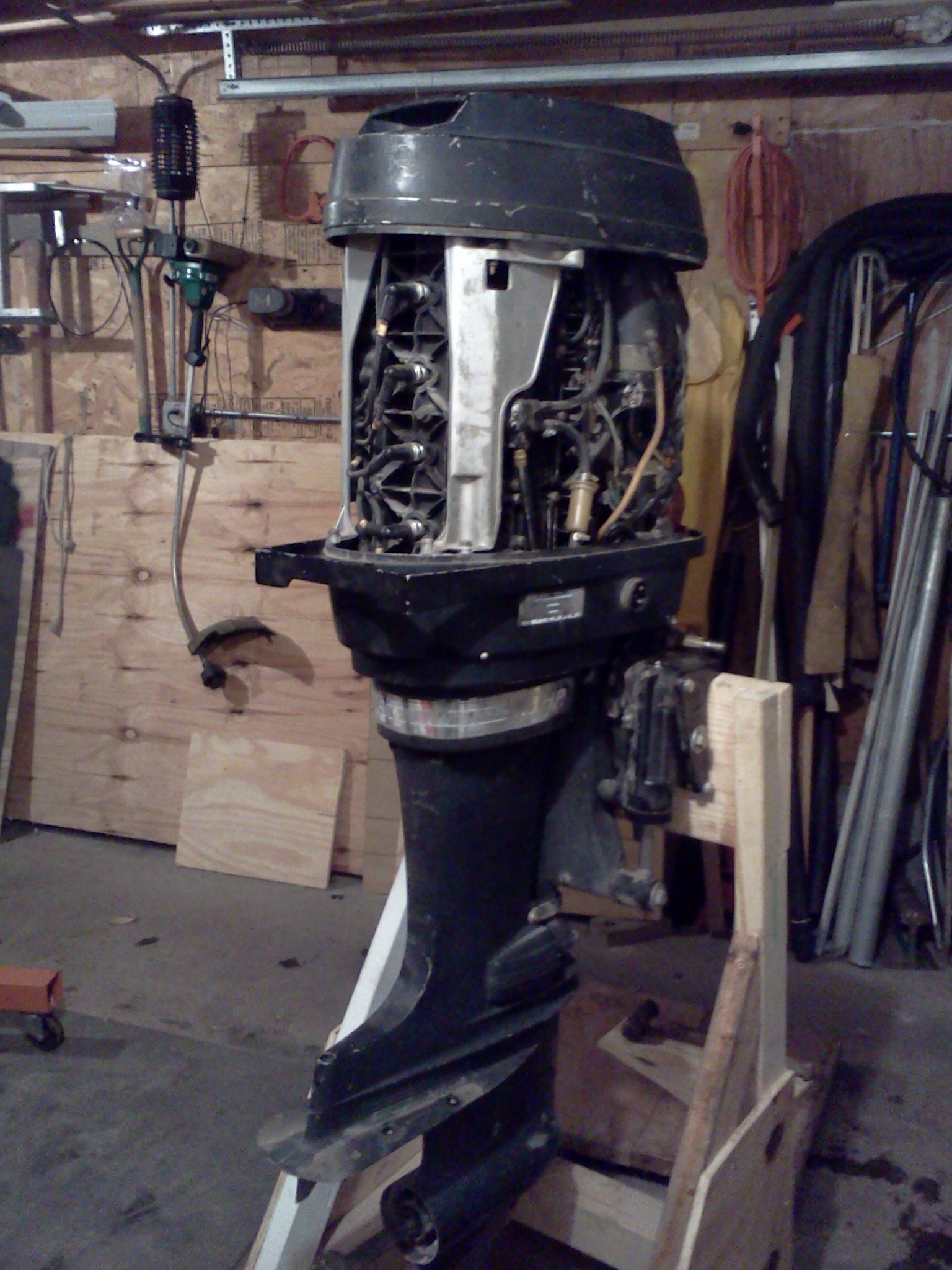

Well I finnaly managed to get the motor out of the truck and onto a stand. Had to kinda mess around with the hoist to get it hooked up right. Now I just need to get a couple of bolts for the mount to hold it on the stand then I can get it down into the shop area.
Re:79 Merc 115 hp. 13 years 1 week ago #85789
Looks great. Just for others reading this. Be careful lifting the 1965-1988 inline 6's from the cowlings like this. They are not fully attached. They are only floating cowlings. They can break if lifted this way.
Mercury isolated the cowlings on rubber mounts starting in 1965 to reduce vibration transmission noise.
Those little black rubber isolators break easily and are not cheap new. If your looking to make 135 hp out of this motor, ask Doc Frankenmerc to help you the it. He has the steps down pat.
Conrad
Re:79 Merc 115 hp. 13 years 1 week ago #85792
The proper lifting adapter screws into the thread on the flywheel hub.
Re:79 Merc 115 hp. 13 years 6 days ago #85795
Yea I kinda was taking it real easy lifting it this way. I bought one of those lifting tools that screw into the flywheel. Tried it on the 950 and it was so poorly made that it pulled right out of the hole where it screwed into. Luckly the motor was only about 2" off the ground when it happened. I got this motor on the stand with no problems so I am good to go on it. Skip.
Re:79 Merc 115 hp. 13 years 6 days ago #85798
Factory tools are always best.---I have the factory lifting tool and also one I machined myself.--Both work without a problem.
