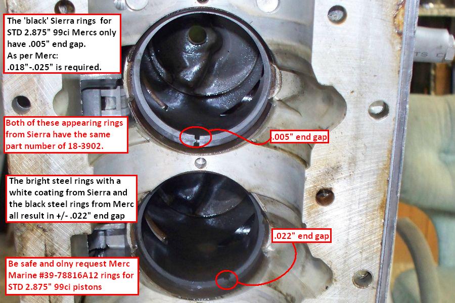

I've been having some serious difficulty getting the correct pistons rings from Sierra Marine lately.
I am not sure if it is 'industry wide', since as you might know,...I focus primarily on the inline-6 Mercs.
I discovered this fall that the Sierra Marine ring packs identified as 18-3902 for a standard bore 99ci inline-6 Merc are totally not safe to install.
Granted,...If you get a set of these rings that are bright steel in color with the white coating on the wear surface,...They are probably okay to use.
BUT,...If you get a set of their most recent batch, that are dark steel in color, you will find that when installed in a STD (standard 2.875") bore,...They will only provide .005" max of ring gap.
Mercury Marine specs call for .018"-.025" of end gap, so if you installed these dark rings, once the Merc has warmed up, the ring gap will vanish and the catostrophic carnage will begin.
My sourse told me that the response they got from Sierra Marine was,..." Well just tell them to trim the ends of the rings back."
What a retarded thing to state. Sierra Marine has apparently acknowledged they do have a new vendor they are using for pistons rings.
OMG!!! What a retarded comment for a pencil pusher to make. GAG!!!
If any of you have a connection to the right guy at Sierra marine,...Please share this info and see if you can get this resolved.
In the mean time,...I strongly recommend using merc Marine rings # 39-78816A12 for STD 99ci Mercs & STD 800 & 850 4 cyl Mercs.

Sadly in this case,...Trimming the ends of these rings is not a solution because the relaxed O.D. of these faulty sized rings simply will not expand enough to put the needed pressure 'outward' onto the cylinder walls.
Use of .015 OS rings that get their ends trimmed correctly will work if correct STD rings aren't 'in hand'.
In a 'good block' with no taper wear, the end gap can actually be trimmed closer to .018" end gap to gain a wee bit of compression, but with today's gasoline quality it just isn't worth the effort unless you are going for the winner's circle and have access to 100LL (airplane gasoline)
Beware too (IMHO) that adding over-the-counter 'octane boosters' can actually result in piston melt-downs because of the lack of necessary lead additives to keep the pistons happy.

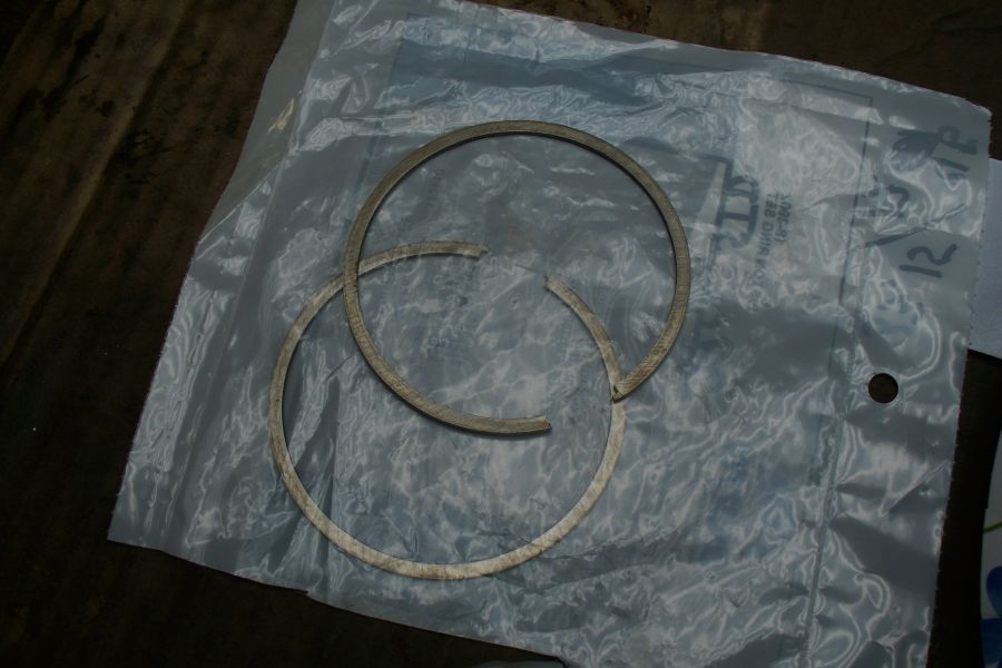

Re:Danger!!! Check your Sierra Marine piston rings 13 years 1 month ago #84324
If you have the correct ring laying on the table beside the wrong ring and you can visibly see that the wrong ring has a smaller O.D. at rest, and that the end gap at rest of the wrong ring is visibly shorter than that of the correct ring, it would be logical to me that the wrong ring would not have the ability to expand outward against the cylinder wall as well as the correct ring.
Consequently, even if the end of the wrong ring was trimmed back to provide adequate end gap, this ring would be more likely to allow the skirts of its piston to make undesired contact with its cylinder wall.
This just my humble opinion.
If someone has more insight on this thought, please post.
There are a LOT of very experienced folks on this forum, that in many cases know way more than I do. :-)
Doc Frankenmerc Keepin' Mercs Alive Since 1965

Doc, I understand what you mean here."relaxed OD size" ..basic smaller than the correct ring.
Bill, its not that gapping the smaller ring would hurt anything, but its as the wrong ring in relaxed state is not as large as correct ring, a bit bigger and more in "tension", against the walls. Had I know this yesterday when I was at the Docs, I would have brought my Mics, and do a size comparison.

In order to determine the ring pressure you would have the measure the tension.
No one can tell here how much tension a ring will have by " looking " at it.
Re:Danger!!! Check your Sierra Marine piston rings 13 years 1 month ago #84347
Im just going to throw out a few thoughts here.
Can,t judge those rings without measuring them with a mic.
I agree, you cannot see "tension" in a ring.
Tension is not important, heat and combustion pressure seat the rings against the cyl wall.
Cant show two rings in two cyl and make an informed decision, one cyl could be larger in bore.
ring gap should be measured where the rings run in the cyl, not at the opening of the sleeve.
Any brand of ring could exhibit the same scenario.
99.99% of the time I agree with Thom!
Good thing Thom checked the end gap!
