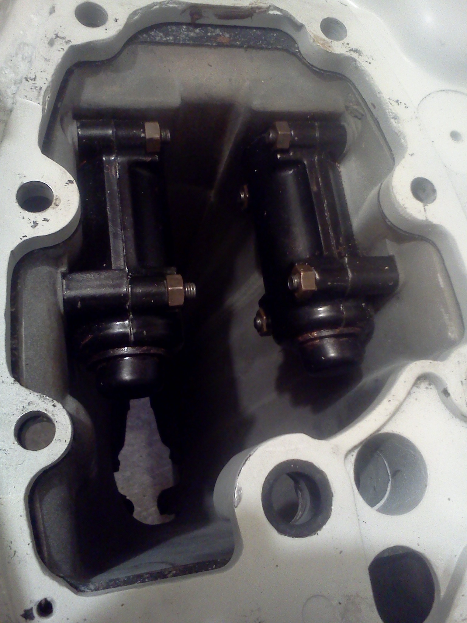

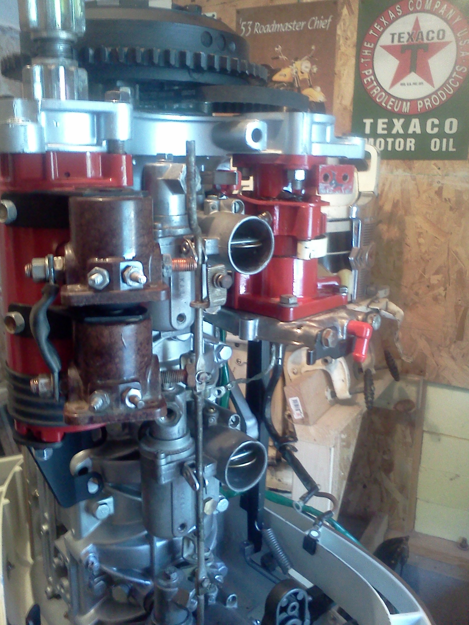

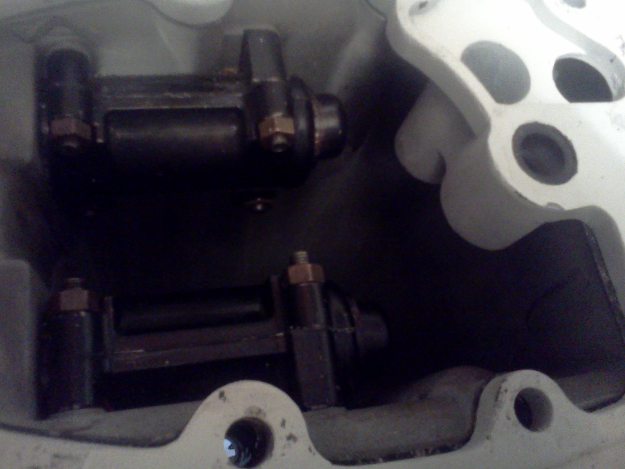

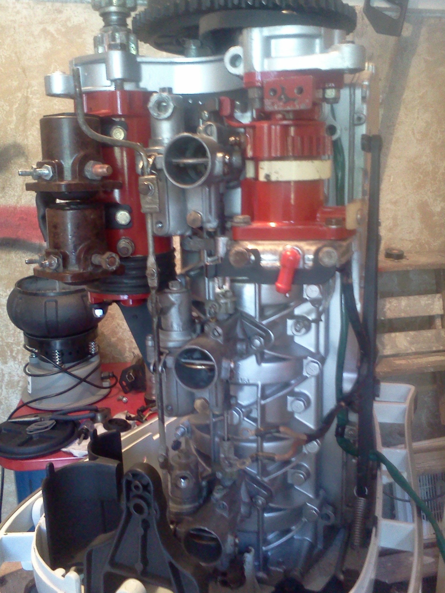

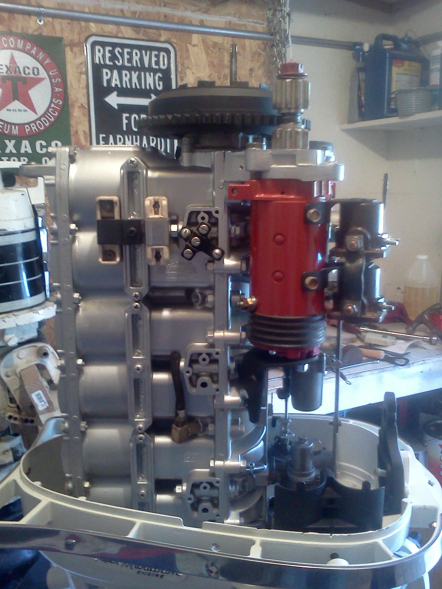

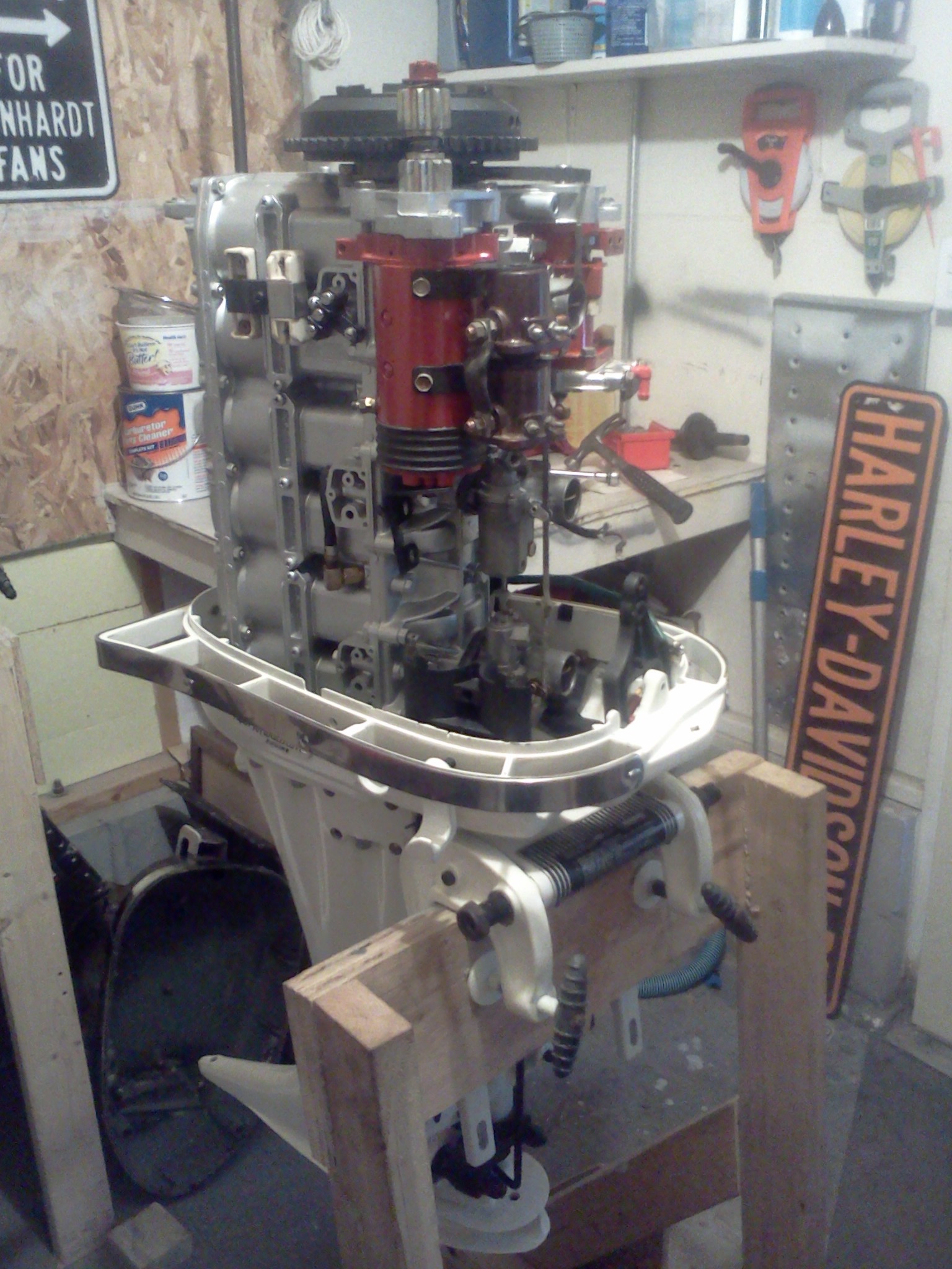

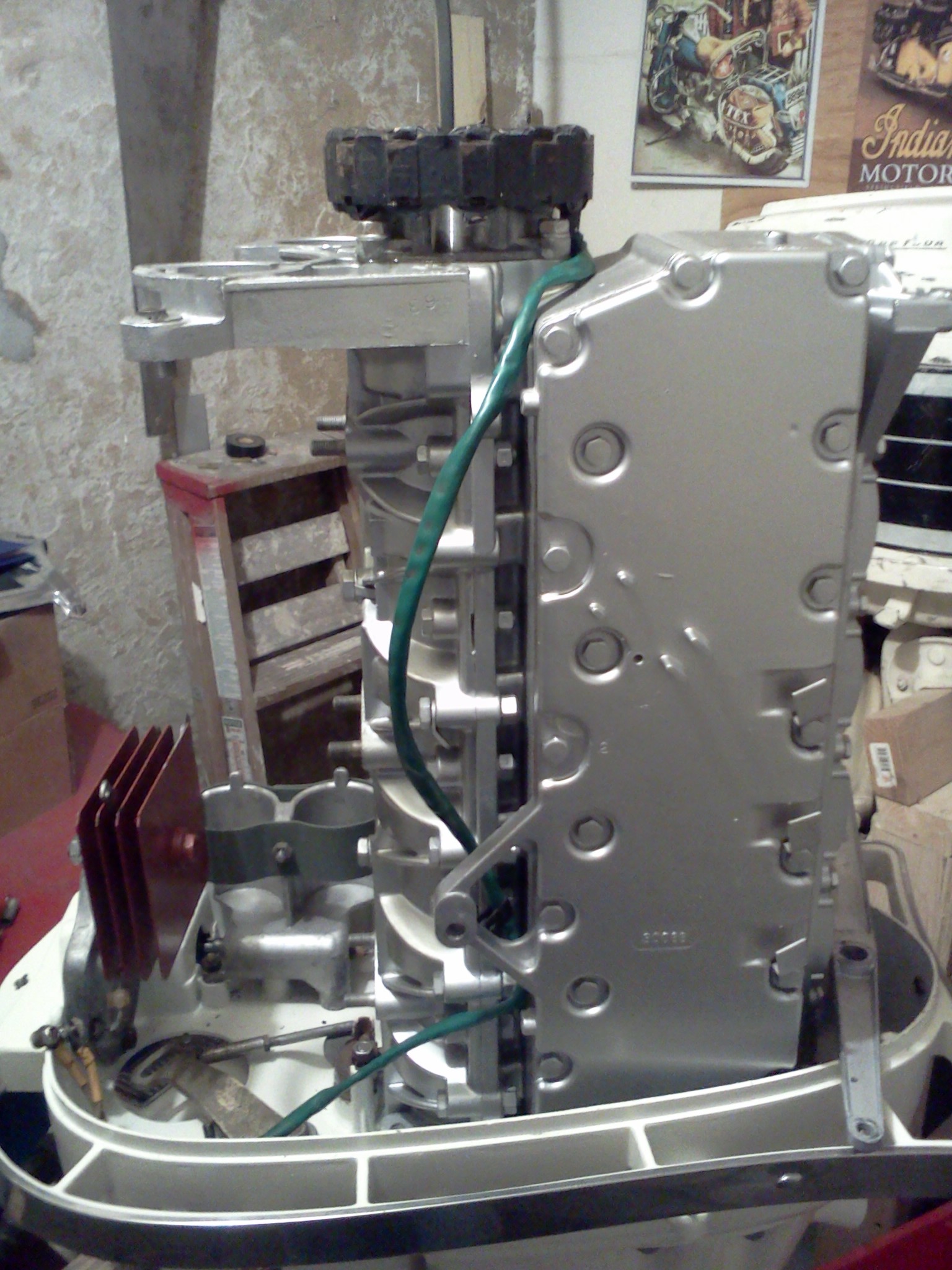

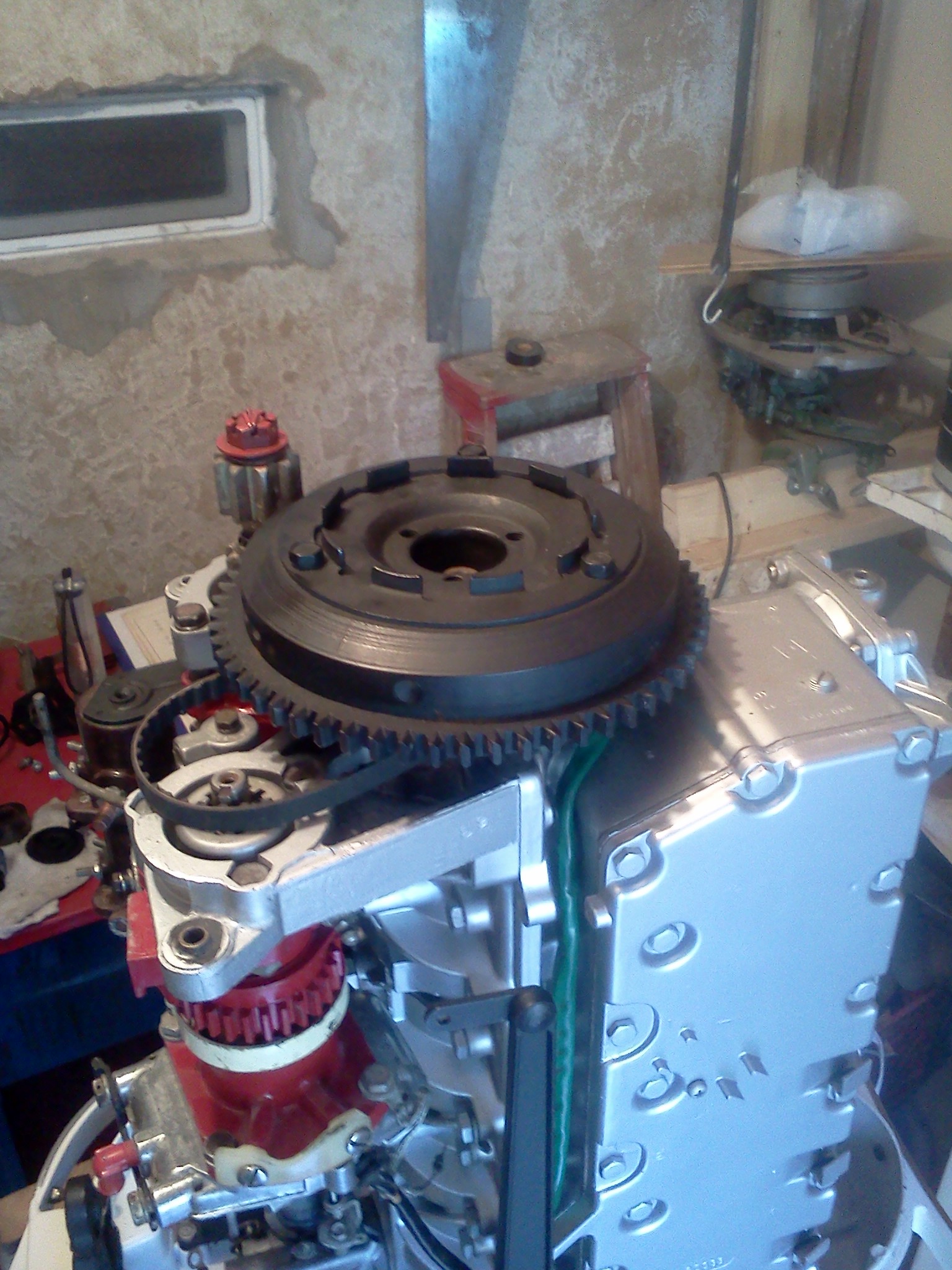

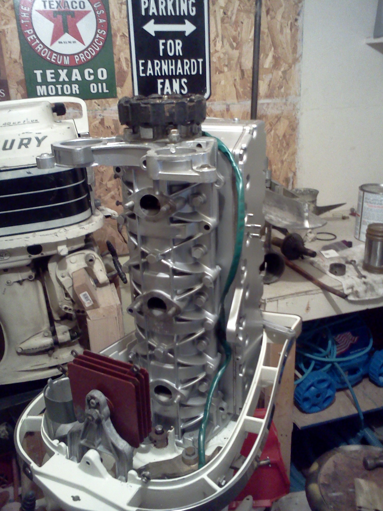

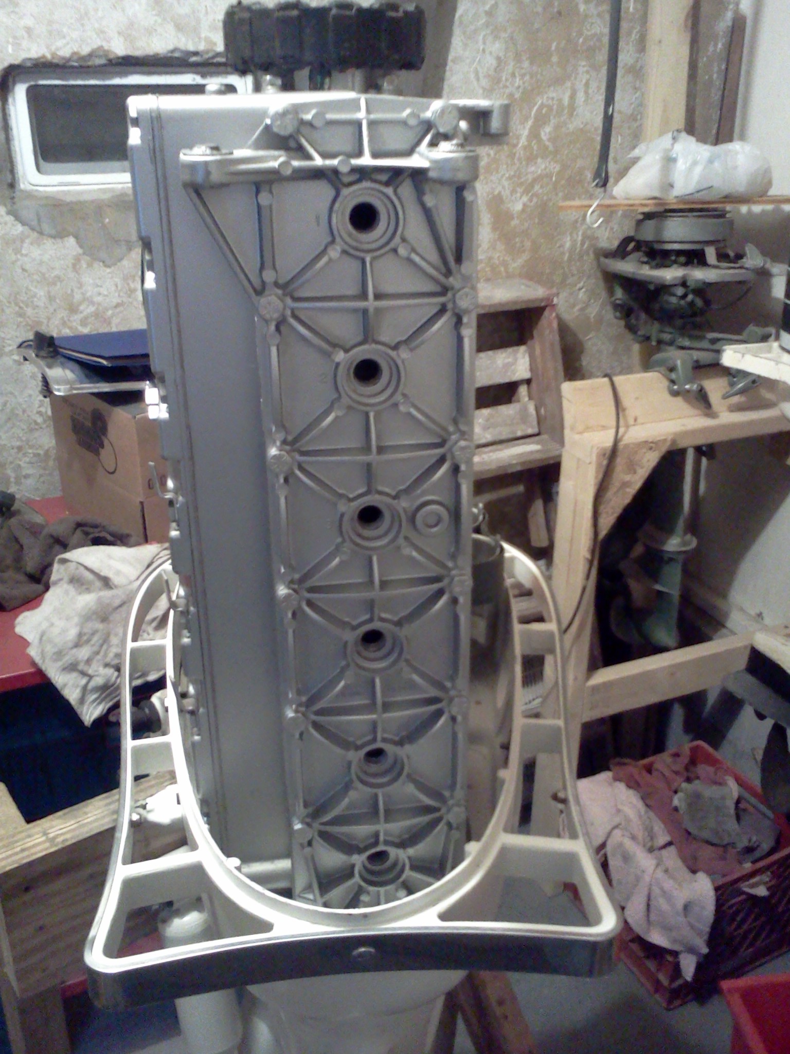

I have been slowly making progress on this old DB. Thought I would post a few pics of how it's going.
Well I hope that I am doing this right. Most of it is going back together ok. There is a couple of things I don't know about and will be asking some more questions here soon. The wife asked me today if it was gonna run. I told her if it didn't, we would have the best looking lawn art around. Skip.
Re:Merc 700 carbs. 13 years 1 month ago #84443
very nice work skip....

Re:Merc 700 carbs. 13 years 1 month ago #84493
  • Neil
  • Neil's Avatar
  • Posts: 1997
  • Karma: 65
Looks very nice. It should run the same.
