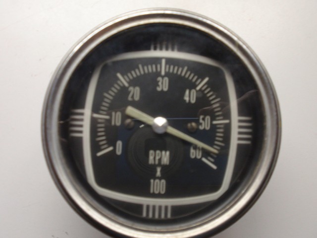

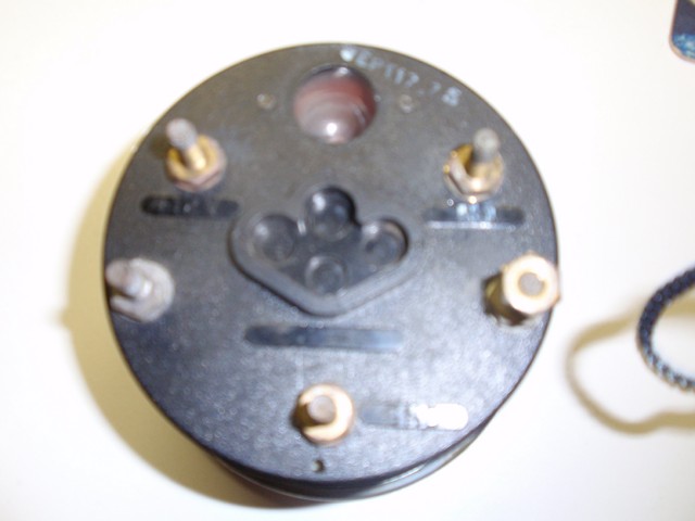

I thought that this one ran to the trigger side of the coil can you use a automotive tack on this system the motor has the next model ing. in it this is the tack that I have

Although I cannot really see the labels for the terminals, you appear to have an alternator driven outboard tachometer. If your battery charging system is functioning, you can connect this tachometer successfully. To successfully connect the tachometer via the use of a tachometer harness plugged into the MerControl, the brown tachometer sender wire likely connected to the four terminal side of the switchbox will need to be removed and moved to be connected to either one of the yellow with red stripe wires connected to the rectifier.
