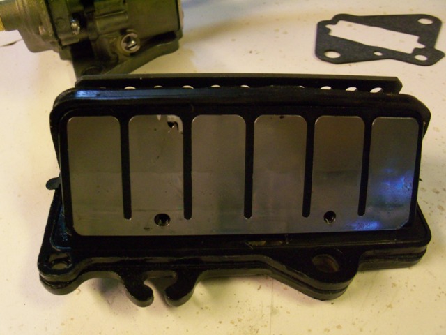

I think I found the issue?

I actually was thinking reeds should be checked but thought they were on the bearings and not something to get into yet, guess they got cheap with the newer Merc's :) Is that plastic? :( Glad ya found the problem:)
Dave kinda nailed it when he said; "are you getting pulse from the powerhead?"

The reed block is aluminum, and the reed stop (not in pic) is steel.
The reed itself is of course, some kind of steel, but I think you were joking.
I was told they are NLA, but marineengine.com claims 10+ in stock.
We'll see if they actually arrive. (there are 2 on ebay)
Other option is to install the entire assy. which is available, and of a different design, maybe because of this?

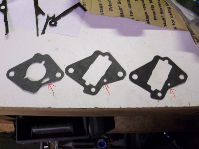

Update. I thought I would share what else I found.
I got the reeds and was installing the reed block. No problem. Then I put the carb gasket back on the reed block instead of the carb. Good thing I did because I would not have noticed it was the WRONG gasket.
Left is the right one. Middle was the one I put on last week. Right one was as I received it.
Without that oblong hole, the port to the fuel pump was completely blocked.
I almost repeated the problem.
Tank test tomorrow, boat test Sat. hopefully.
