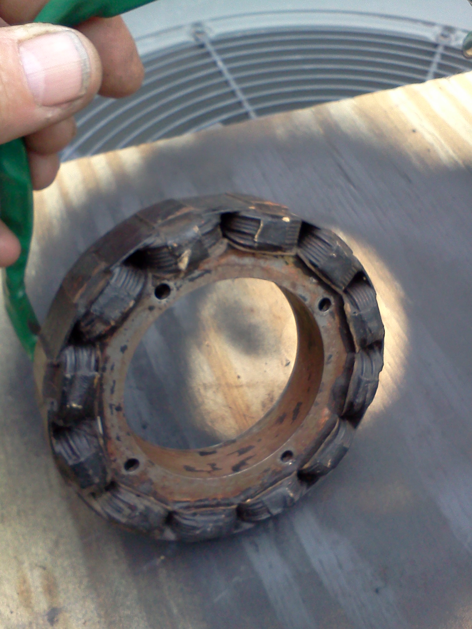

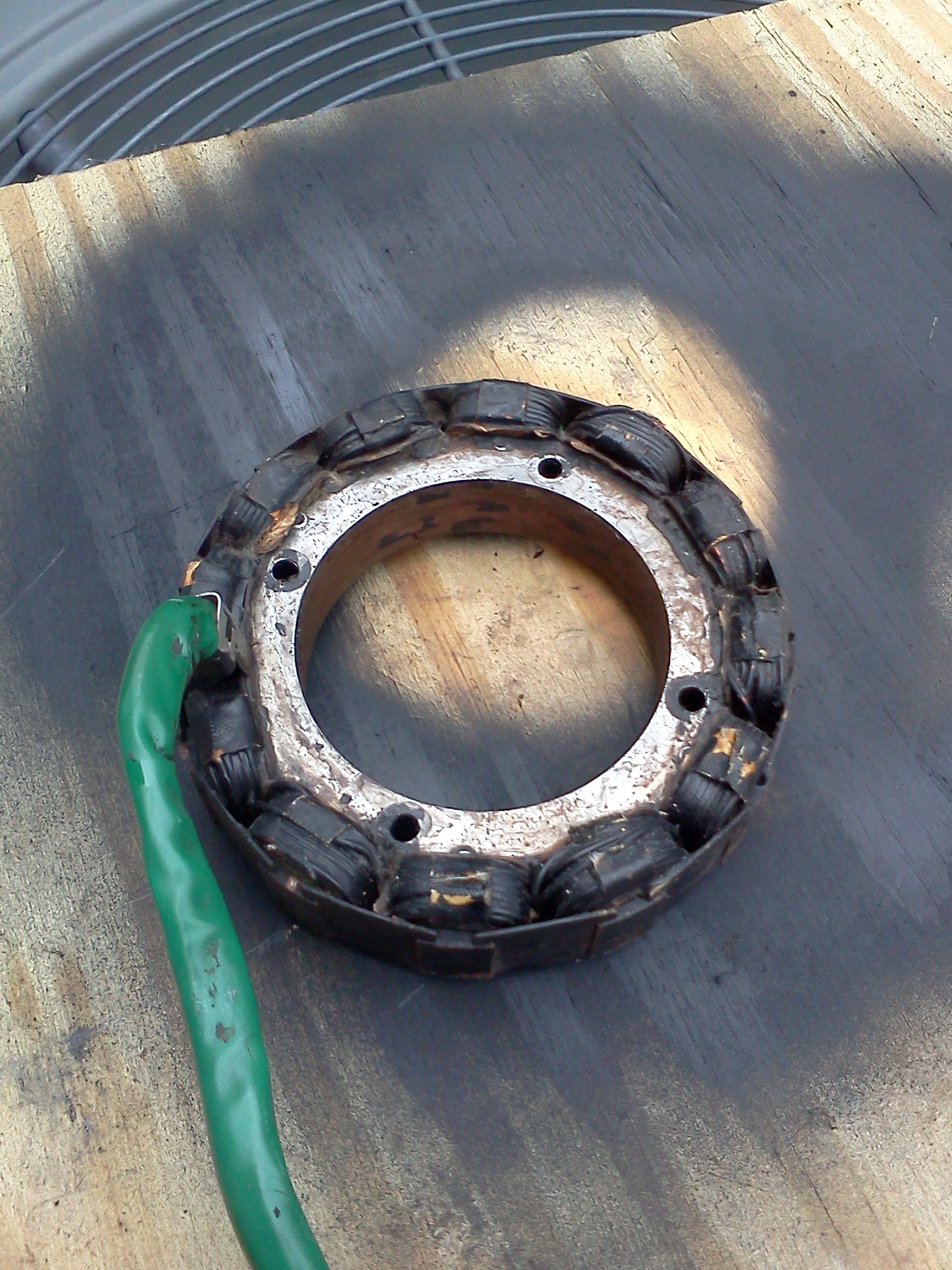

New question on the DB. Can I paint the stator? The original black paint is coming off and it was starting to get a little rusty. Just wondering if I could spray some flat black on it. Thanks Skip.

I would use a Rust inhibitor/converter in a spray can from pepboys or hardware store after removing as much rust as possible and applying to bare metal areas. Goes on clear and after a few minutes a second light coat turns dark then needs a top coat to last. Topcoating that with light coat of spray Shellac or guess your black paint is ok to prevent rusting again?
Wikpedia; Shellac was once used for fixing inductor, motor, generator and transformer windings, where it was applied directly to single layer windings in an alcohol solution. For multilayer windings, the whole coil was submerged in shellac solution, then drained and placed in a warm place to allow the alcohol to evaporate. The shellac then locks the wire turns in place, provides extra insulation and prevents movement and vibration, reducing buzz and hum. In motors and generators it also helps transfer force generated by magnetic attraction and repulsion from the windings to the rotor or armature. In more recent times, synthetic resins, such as glyptol, (Glyptal), have been substituted for the shellac. Some applications use shellac mixed with other natural or synthetic resins, such as pine resin or phenol-formaldehyde resin, of which Bakelite is the best known, for electrical use. Mixed with other resins, barium sulfate, calcium carbonate, zinc sulfide, aluminium oxide and/or cuprous carbonate (malachite), shellac forms a component of heat-cured capping cement used to fasten the caps or bases to the bulbs of electric lamps.
ADDED:
I think either will work fine, dont ya think Charles? if ya have either in the garage go for it imo. The red varnish is more flexable than shellac but think shellac would penatrate better into the windings if thats whats needed? One guy said he pored shellac over his ceiling fan windings and 10 years later is still quiet from the buzzing it had before?

If you can fined a electric motor shop buy a spray can of red insulating varnish clean it with warm soapy water let dry for a couple days then paint it till the paint soaks though the windings
I done this with mine about 5 years ago it is sold by Diversified Brands, Cleveland Oh 44115 WWW.diversifiedbrands.com

I just found a can of spray that is for electrical windings. Says it is an insulator so I am going to try it. thanks for the help guys, Skip.
