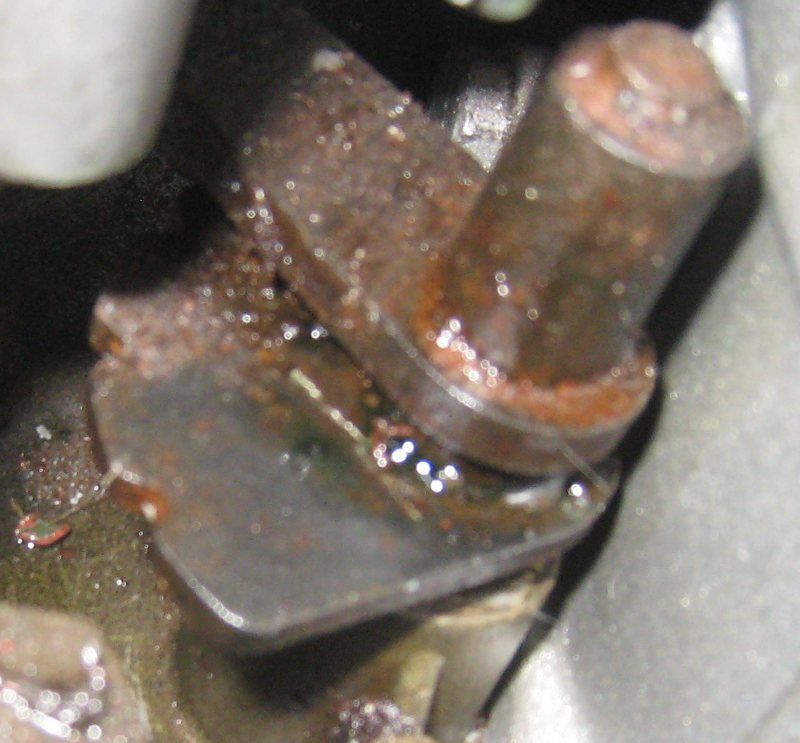

63g3 (Randy) said in response to a post about my motor problems "The shift shaft on the motor also has a neutral detent, look under the bottom carb, there is a crescent shaped arm with a groove that a spring clicks into make sure the spring is clicked into the center groove if there is more than one groove."
I posted this pic with my response and never heard back from Randy. Am I missing a spring here? It's a '63 Merc 1000. Thanks!
Frank

My 1965 900 L-6 has the 3 notches but no spring. My older MK55's and such have the notches and the spring. Most of my big motors do not have the spring.

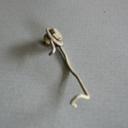

Frank the detent spring bolts to the lower cowl just behind and to the right of the fuel inlet connection
Re:Help 16 years 1 month ago #8297
Thanks Michael, that pic is VERY helpful. I know there is a spring down there that looks like that, but I couldn't see any connections. It is under that crescent shaped thing just out of camera range.
