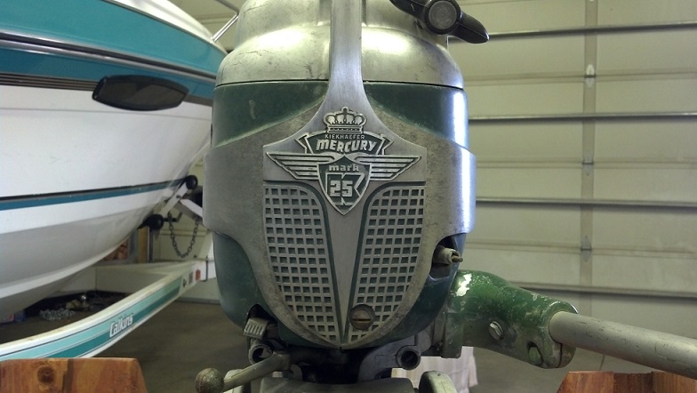

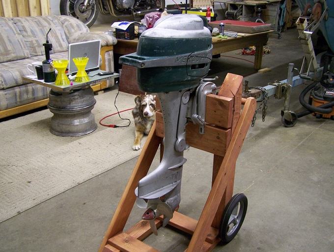

Picked this little guy up to add to the collection.

I have spark and compression, but that is as far as I got into it for now.
It is stuck in forward gear, so I soaked it down good and walked away:)

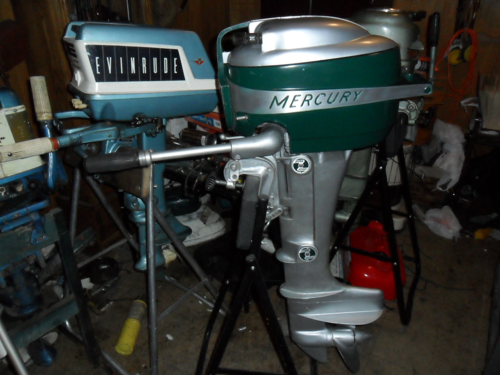

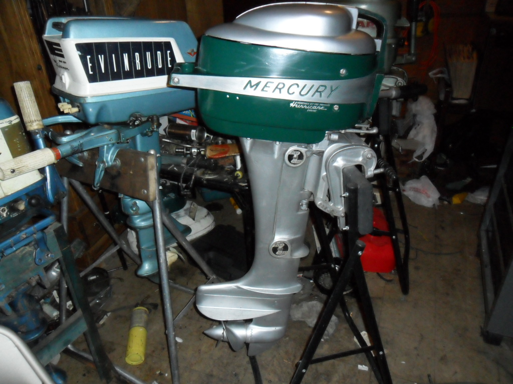

shift problem is most likely the cam for the reverse locks . easily seen it is brass 1/2 way down under the swivel bracket. here is my mark 25 L only 300 made.
Re:1955 Mark 25 13 years 2 months ago #82751
shift problem is the reverse lock brass cams under the swivel bracket or to much throttle.

I checked out the top of the shifter where the throttle interlocks and it is in the shift position. I will look into the cams next.

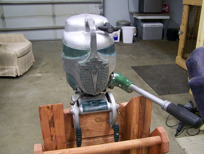

What am I missing here to cover the hole and attach with the bottom screw?
I haven't found a good picture of what is supposed to be here.

it is a cover hope the pic comes out.i may have a repro of it.
