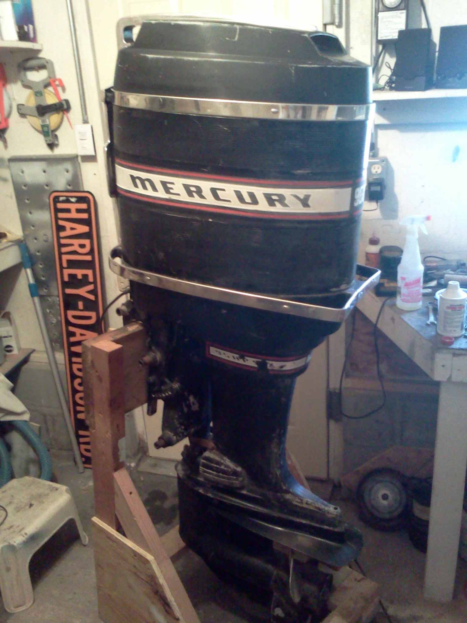

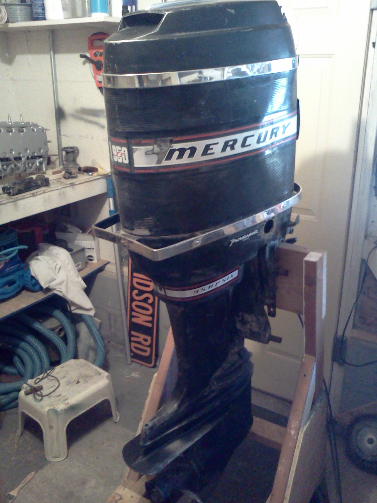

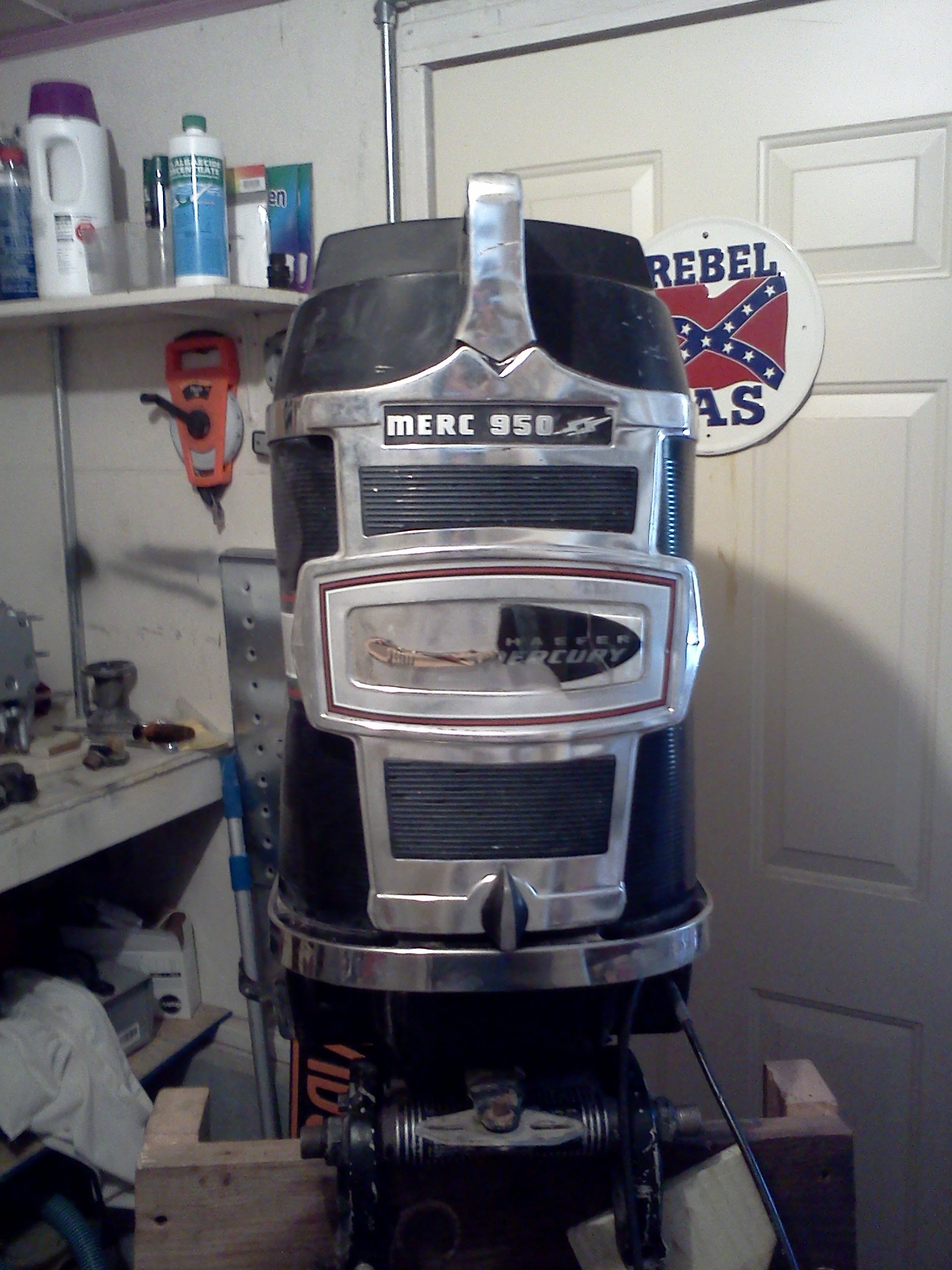

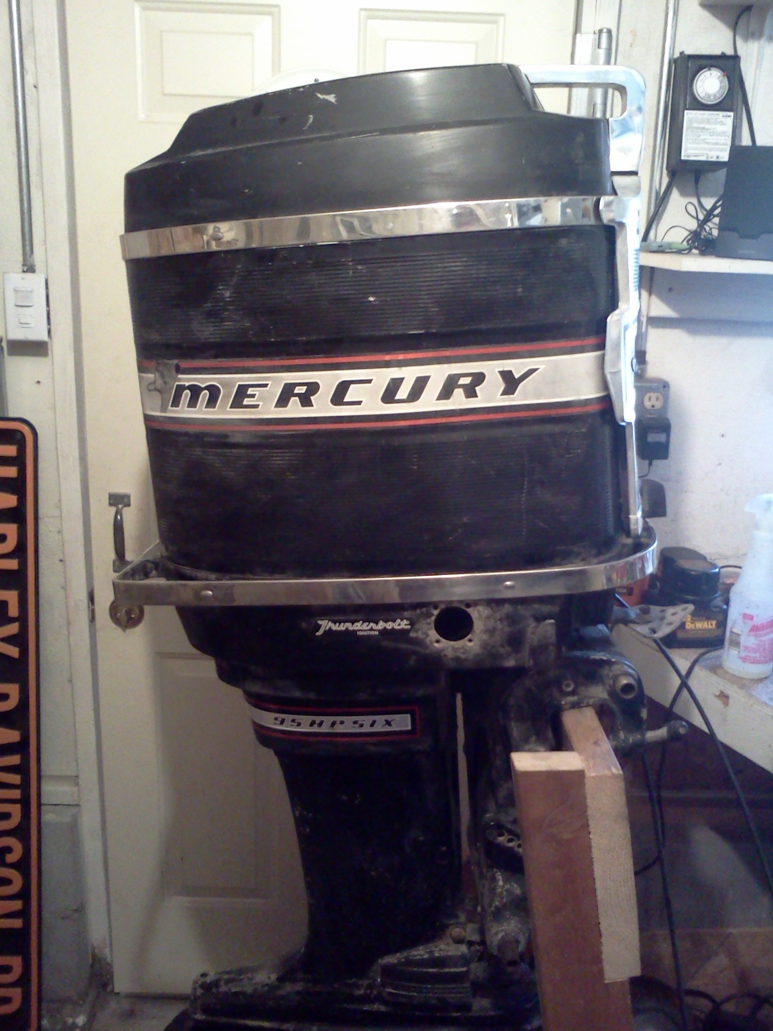

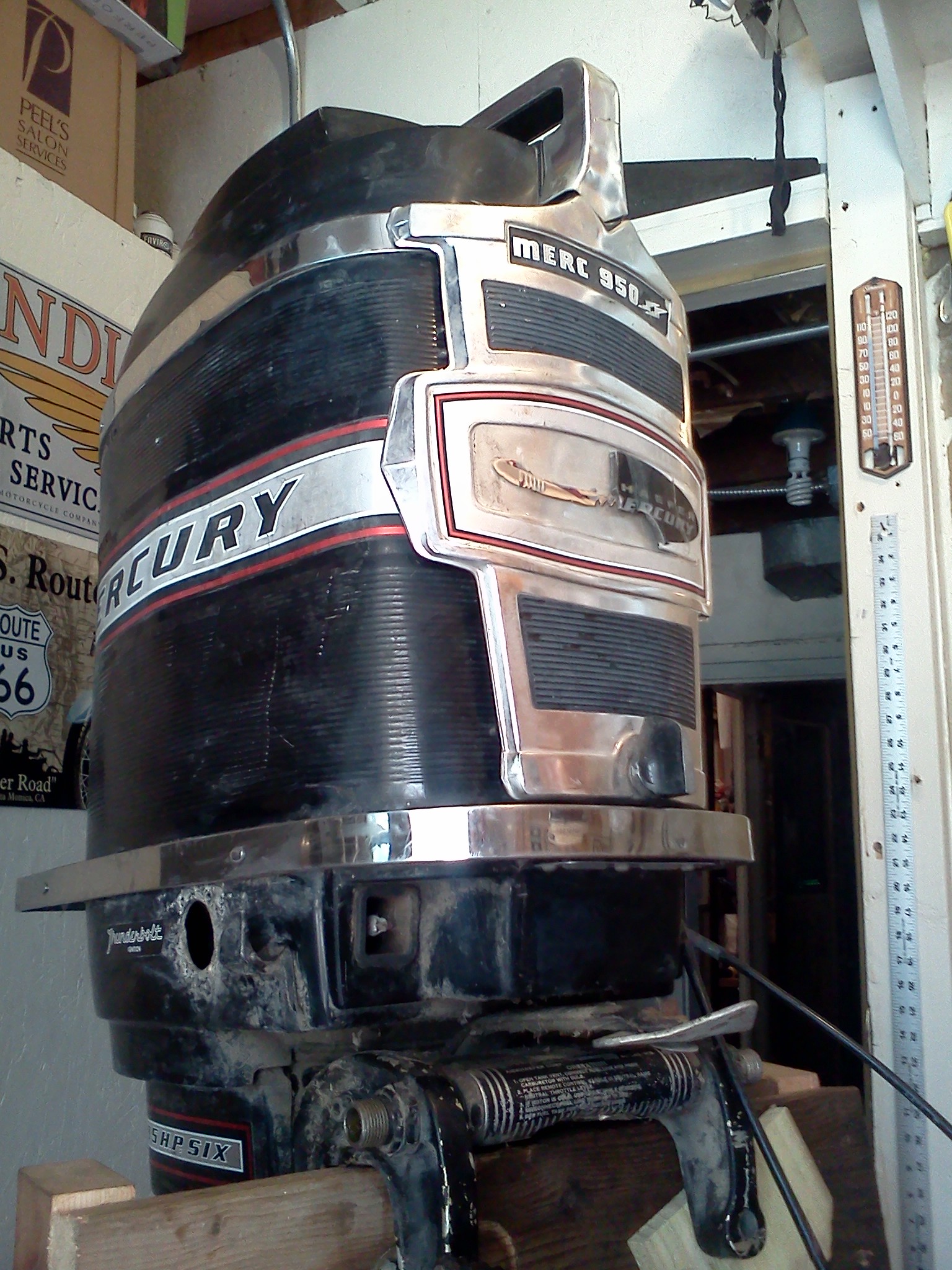

Gonna try some pics.

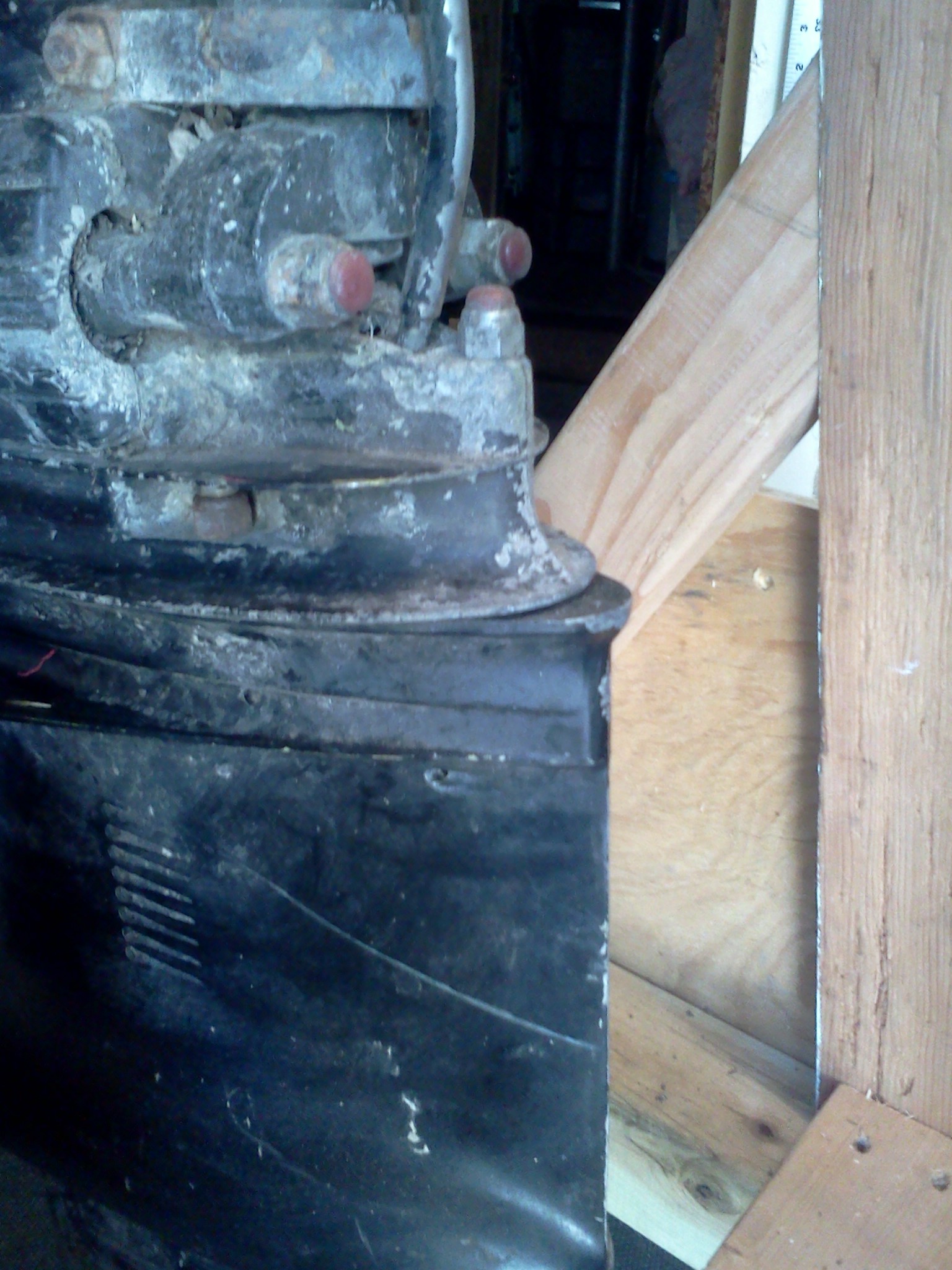

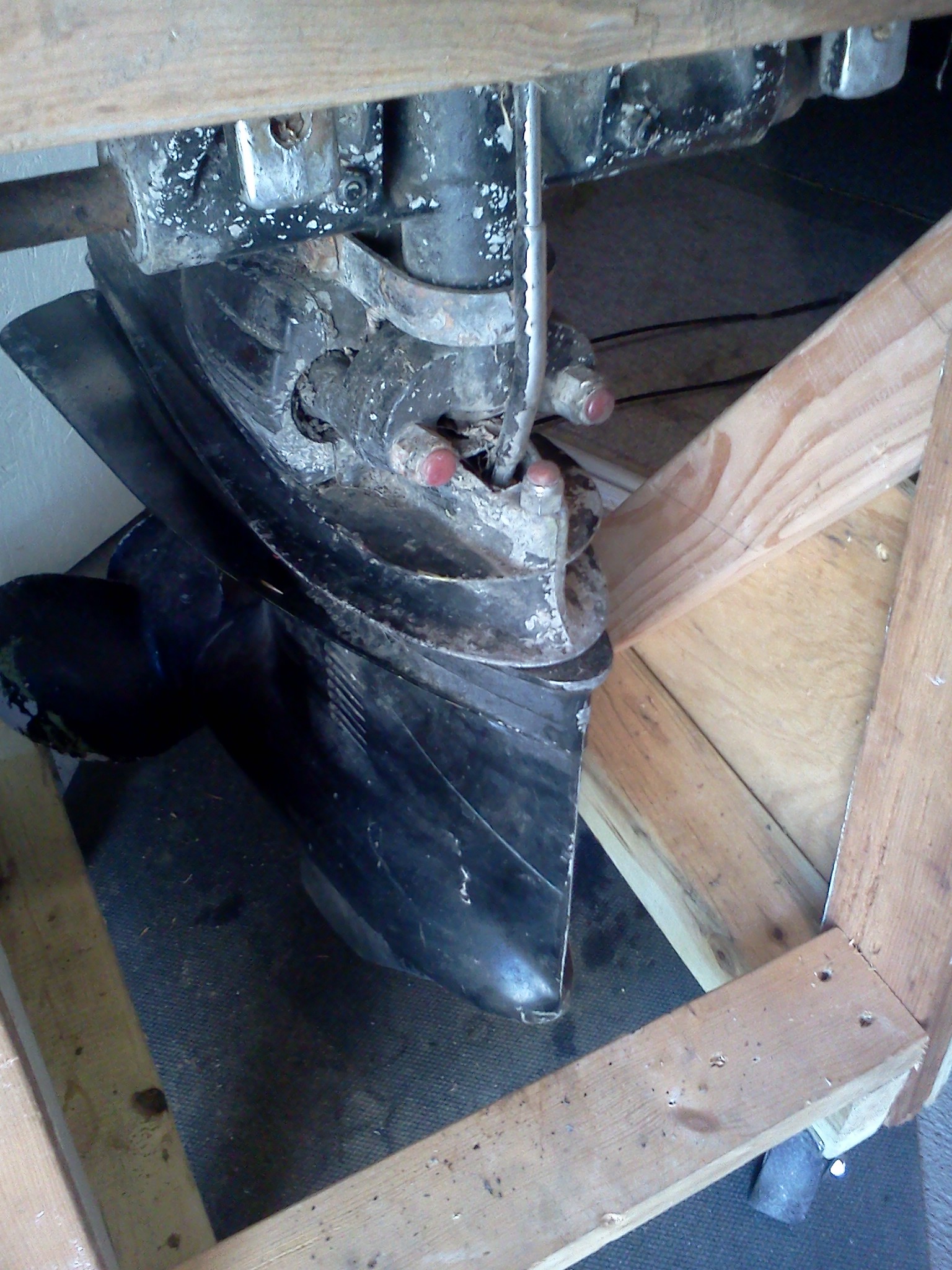

Re:1967 Merc 950. 13 years 2 months ago #82663
Couple more pics. I think this has a different lower unit on it. It don't look right.
Any thoughts?

Re:1967 Merc 950. 13 years 2 months ago #82701
Hi Skip,
Yes it has been fitted with a newer gear case/lower unit, but is not a problem. We can supply the small bolt-on fin if needed, but mounting the motor on the transom very slightly higher will also work with a suitable propeller.

..S.T.S. : CONGRATS. That 800 FOUR cyl are great motors.. Have unique exhaust block manifold. Also the lower may be a special
gear ratio. ?
.Is that 950 six cyl a SHORT SHAFT lower.. One of the pics
look short .? Anyhow congrats.. May go another year & not score anything. When Hot your hot.
