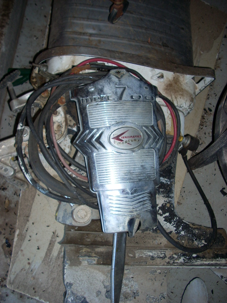

Got this a few days ago, No spark, duel points is a worry, first serious repair for me with a six pack. Looking for a book on this motor also.

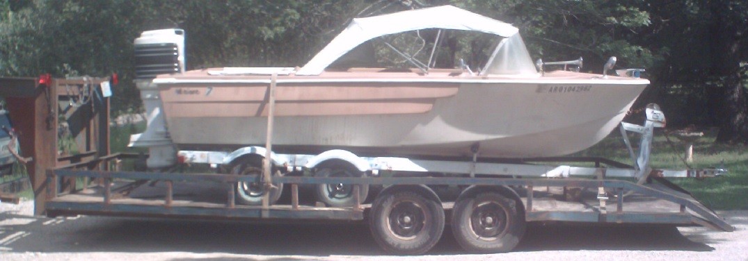

This is the boat . Mariner with a Montgomery wards sea king trailer

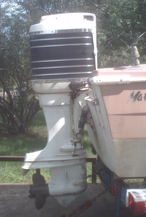

G3Bill ... This is my 6 pack , Tower of Power , and the Mariner Boat... i Think i am going to redo the boat , someday, and yes i am going to change the color from the bronze gelcoat ,,, to a shade of pink , just like the faded color it is now LOL !

Yes Mark that Manual is great, the Merc Bible!
Not too sure about the flamingo pink :) , people might wonder which bar you patronize,lol I do like the lines, nice boat...

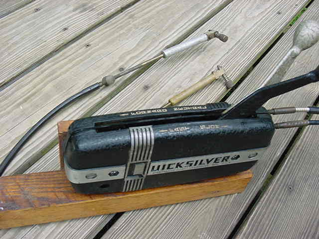

OH ! by the way .. i have searched for control cables for these Control boxes,without luck .. Any hints to where to look next ?

I would start a new thread asking about the cables. I know someone will have them but measure so ya dont get them too short. I'd include the pics you took.
My remote is like the white teardrop one but mounted lower. Have a piece of ply up under the gunwale to floor its mounted to. The ply also helps support the deck at end of windshield where they like to crack.

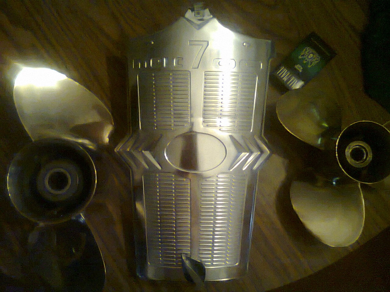

Now ... what to do , what to do ... I have washed rubbed scrubbed and wore my fingers out...Should I paint the indents black, or leave it polished like it is ... Lord knows I don't want to spend another week rubbing on this !

Paint them black. It's good for Karma. Skip.
