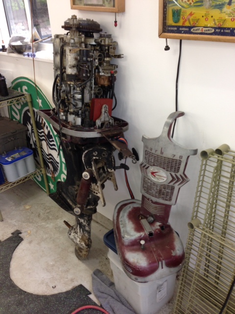

I decided to resurrect the 1959 Mark 78 I got with the purchase of a Reinell 1957 Jet-a Bout. The whole thing cost $200, but I had to get it out of the driveway, no trailer. It was a screaming deal. The Reinell is on it's way (you know, a project), but in the meantime I am going to get this Tower running.
I initially didn't want to get into this thing after reading about the "dock crasher" legend. But this motor is so clean and it is all there. I have totally rebuilt the fuel pumps and carbs, I have replaced all rotten hoses.

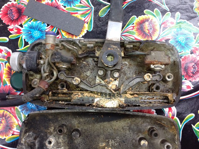

I hooked up the ignition and it is hot. The starter spins but does not engage. It won't even spin in reverse.
I am wondering if the control box gears are out of adjustment, or if some of the old switches are not working properly.
Is there someone out there with some sage advice on these direct-reversing Towers?

Headly, (Thom)
The 1959 would be a Mark 78A, and I'm not sure if it uses the same control box as the earlier Mark 75 & Mark 78.
It looks like you have an early (75-78) control box & the limiter switches are mounted in that box rather than on the distributor like a 700DR, but I'm not sure where the 78A had it limiter switches.
Like Dave suggested,...Try jumping direct to the starter to see if it will spin the beast both ways.
There are (2) different (+) posts on the starter so follow the secondary large wire from each solenoid out to each of these (+) posts. One should make the starter spin clockwise & the other will spin the starter counter-clockwise.
If the starter spins both ways doing it like this, then try using the clockwise solenoid to engage the counter-clockwise spin.

Thanks guys, big help as usual from two of the senior motor heads. I am going to test a couple switches, I have the control apart. Very old wiring, the reverse switch is not working, I will clean it up as best I can and test the switch. I will jump directly sometime this afternoon. I do have some decent literature on this, so I know how to set it up correctly.

Re: Need help with Mark 78 control box issues 13 years 3 months ago #81322
From the looks of the cowl top, it appears to be a 1958 Mark 78.

All right guys, again Thom, Dave and all, thanks for the help. The starter didn't engage on the lower cog (forward?) but did on the upper. Can the starter be saved or do I need something new/old?
The switch in the box is not working, may be the wiring. I don't have my meter here with me but will check later.

serial number 1192389 Mark 78E

Thom,
Will the starter spin both directions, but just not fast enough to get the top bendix gear to come down?
If so,...It could just need a good cleaning of the commutator, end bushings, & bendix guides.
