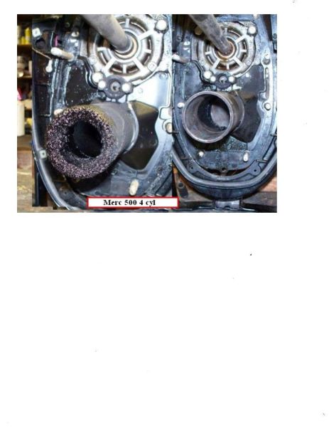

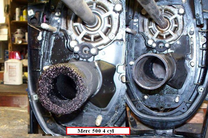

Revving the Merc up tied to the trailer is not only dangerous without a test prop, it can undermine the boat ramp and upset other folks that use the ramp.
Here is a picture of what the professor is referring to.
doc F

Knowing the 500 like I do, it could be that the exhaust is plugged. The tuner has a bad habit of plugging up if cheap oil has been used at the wrong ratio and will choke the engine. Take off the lower unit and look up the tuner with a flashlight to see if this is the case, they can plug right over in some cases.As far as the shifter goes make sure it is not a busted cable in the box, you should be able to see it move back at the engine. Shift shafts have been known to rust through at the waterline as well killing the shift.
