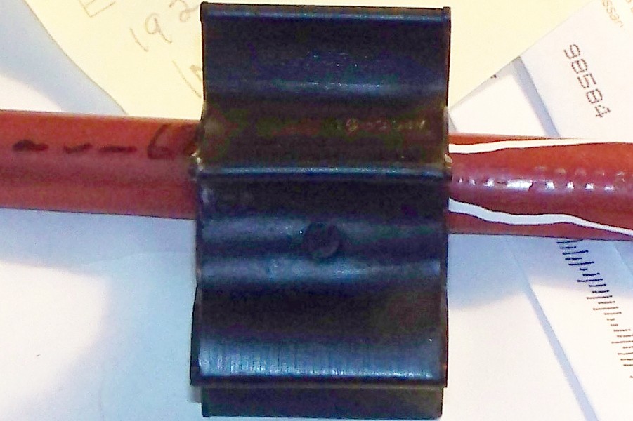

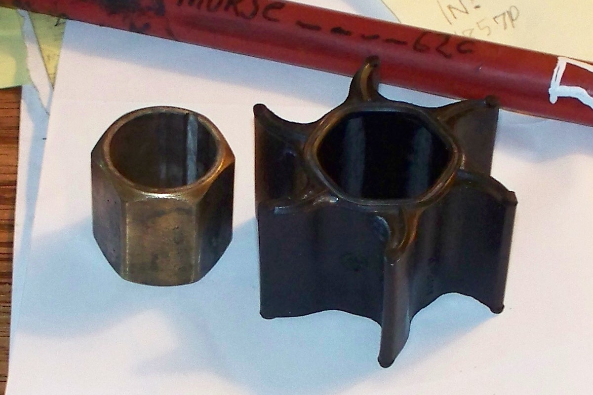

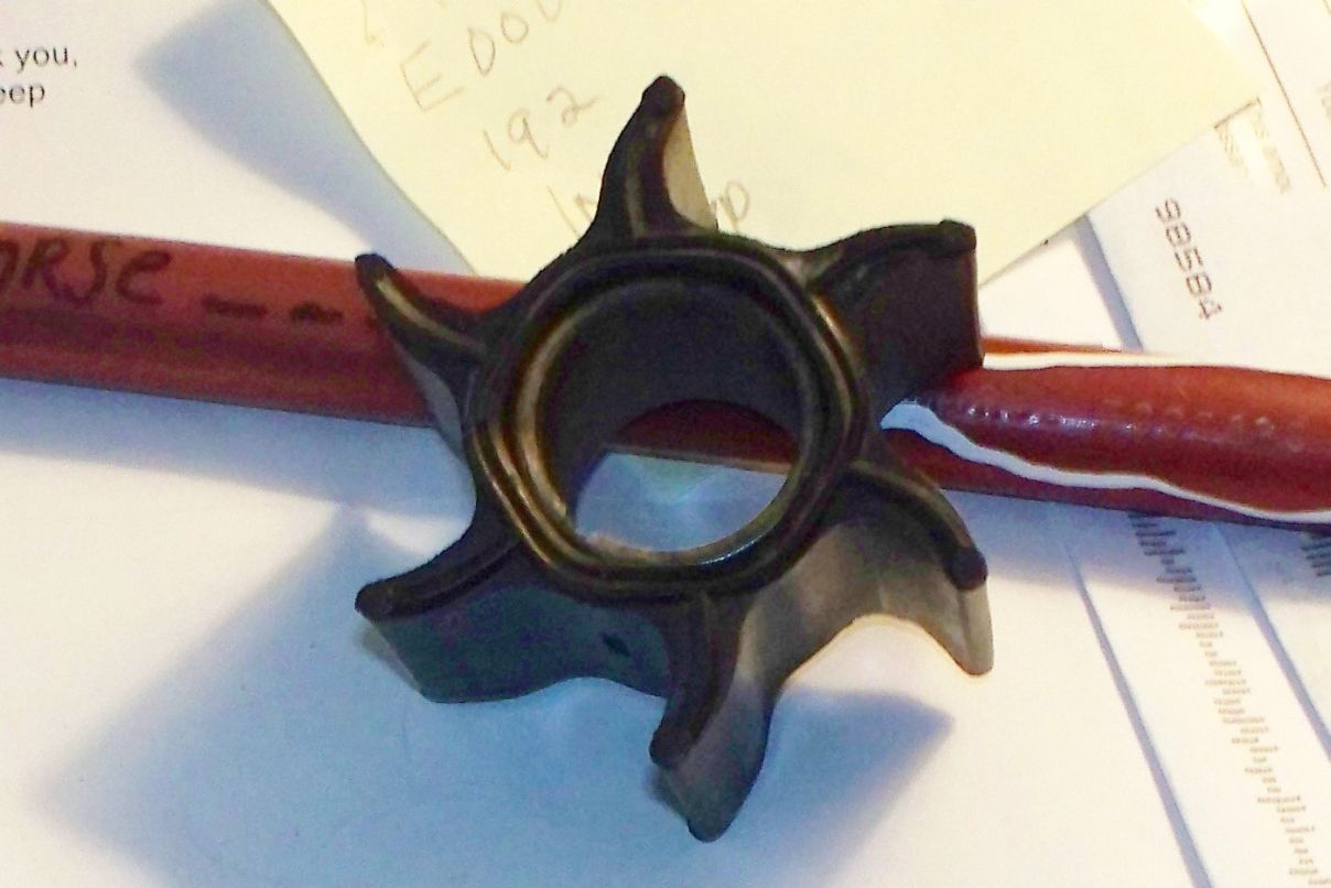

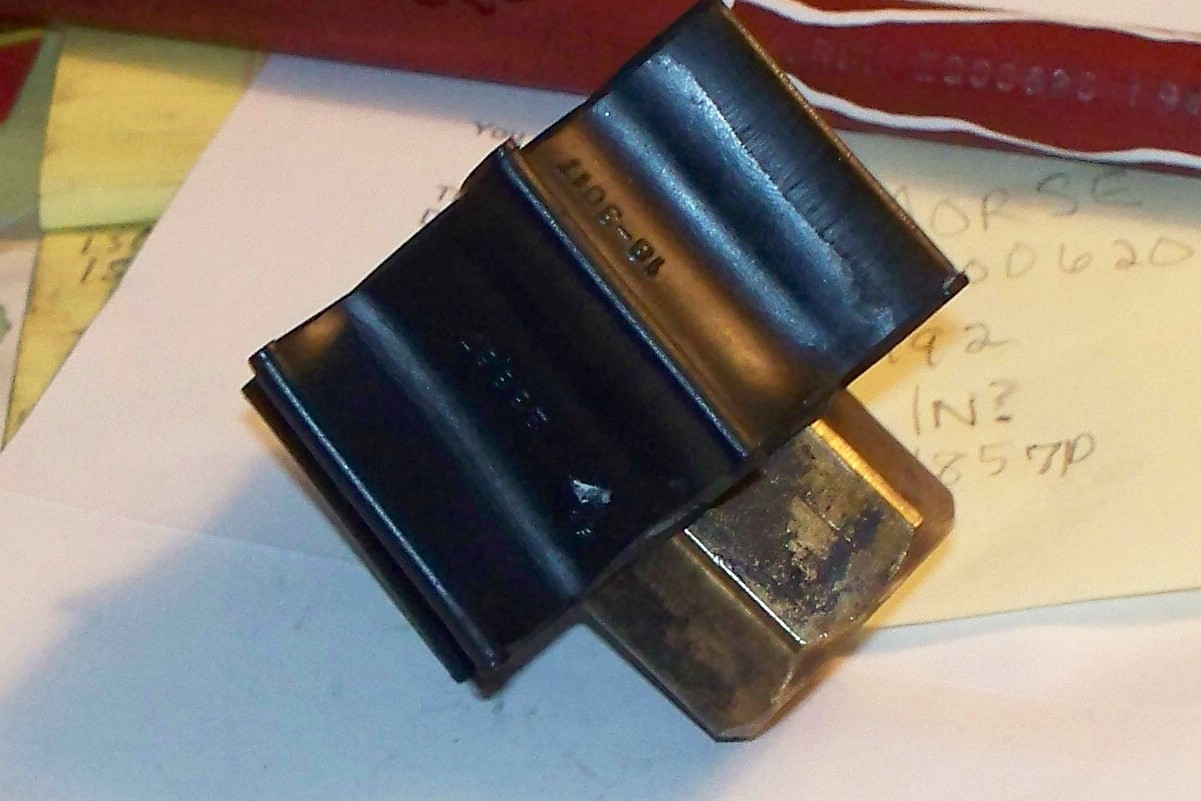

I'm curious as to whether anyone else has had this issue with a Sierra Marine Impeller.
While servicing the lower unit off an inline-6 Merc, but before opening the water pump housing, I turned the driveshaft and fealt an unusual lump-lump-lump in the driveshaft.
I suspected I would fine an impeller with some of the blades broken off, but what I found was that the brass hub in the impeller that should be permanently bonded to the rubber impeller had come loose. The brass was rotating with the driveshaft as the rubber impeller remained stationary.
A GREAT way to destroy a Merc, and another good reason for checking the impeller every Spring before going boating.
