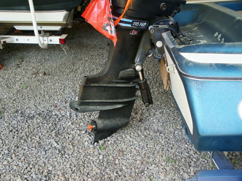

I'm not sure it would fit but Joe just took a 5 inch spacer off my 115 merc. studs shaft connection everything looking to get rid of it i think. they advertize here in the little sliding box up there. Ferguson Poole marine
