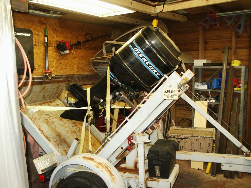

well just picked up my merc 115 from joe poole and it ran smoooooooth . a cold start but once it warmed up first hit of the switch . looks real good sounds better the main point he stressed was never run it without the proper water intake . i am not proud i wont need to show it off until it is ready to go. properly hydrated. but she is a nice outboard. thanks to joe i have a good connection of all of the running gear i need for this project.
