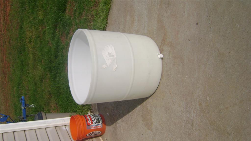

Whew! Thanks, Doug. I made this test barrel from an old plastic 55gal drum from work and a drain fitting for a coleman cooler. The backpressure from having the exhaust in the water changes idle settings, plus my old Merc 700 was one you couldn't run muffs on, so...........there it is. Total investment = $2.95

Okay, so I barely got the LU in my garage 30 gallon trash bucket, so now what am I looking for? Water just out of the pee tube I put in?

Water out of the pee tube I put in?
Yup, that's it. It may take a minute, but it should pump up and out the tube on it's own.

She's trying to pump Frank, but I don't think your water level is high enough in the can. Put some 2x4's under the can to raise it up, trim the motor down a tad. The water level needs to be up to the cavitation plate! (With the water "boiling" around in the can, I think you're sucking some air in the water intake) It started pumping pretty good at first...! Think you're gonna be okay, but lets try this higher water level.
