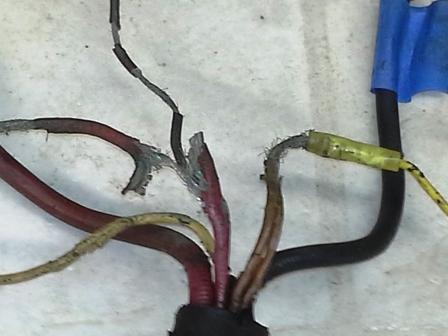

Re:External wireing harness for 1968 50 HP Merc 13 years 5 months ago #78135
My harness was all corroded an I just re wired it now the engine runs fine. Do it just like Dr. Frankenmerc says and it will save you $$.
