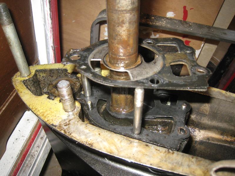

I figured how hard could it be to change an impeller? Well, really not hard at all, as long as you STOP when you get the water pump off. But, oh no, Frank did not stop there, he wanted to explore a bit, lifting the thin stainless plate off that rests between two gaskets under the water pump. When I did, this small shim popped out onto the floor. It's 1 1/16" long and is raised in the middle sort of like a little roof. I hesitate to put things back together without knowing where it goes. The manual is useless!
I think it came from towards the front, could it go between the base for the pump and whatever that loose thingie is in front of it?
Could anybody help me with this, or give me a web site that has a blow up of this LU with clear locations of the parts? I have the manual, but I'll be darned if I can find a blow-up that shows this part.
This could put a big damper on my plan to float the boat tomorrow!
Thank you very much for any help.
Frank

Is that the KEY that keeps the impeller from sliping on the shaft? Locks the impeller from sliping?
Re:Help! LU shim on my '63 1000 16 years 2 months ago #7768
Frank, does your driveshaft have a groove (keyway) or a flat spot? (I'm thinking DelRay is onto something here, the flat back of the key going against the driveshaft, the raised portion acting as the key to fit in the slot inside the impeller?)
Re:Help! LU shim on my '63 1000 16 years 2 months ago #7771
Yep. Thank you very much. LU is back in place, all is hunky dory! :)
Frank
