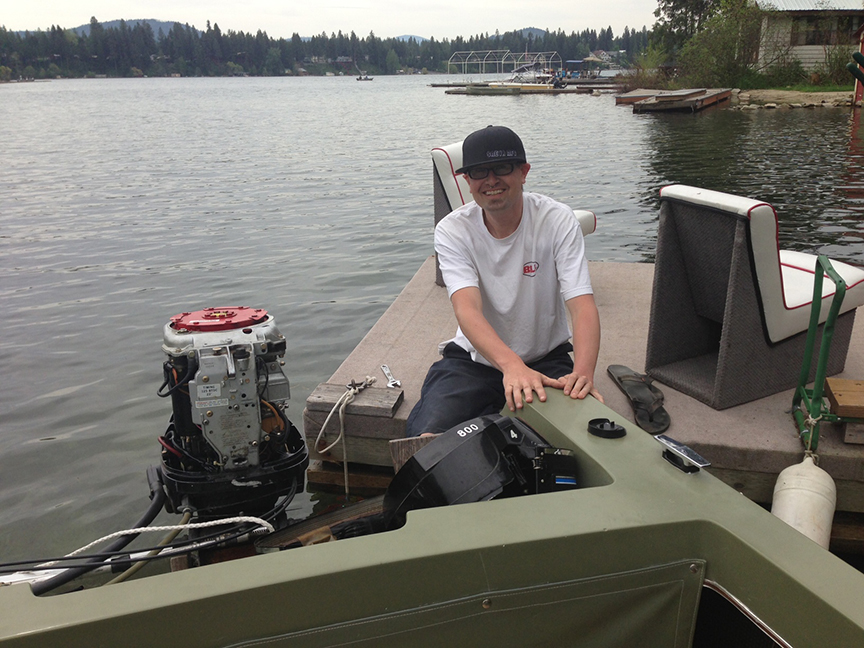

My buddy has a '72 Merc 800 in beautiful condition, has been babied for years. He has had an intermittent problem with starting and now it is quitting in mid flight.
I told him I would ask the pros on the Fiberglassics web site and I knew you would ask two questions: is it getting gas, is it getting spark?
We can smell the gas, the plug was wet.
When we went to test the spark, I turned it over while my buddy placed the plug on some metal and boom...not only did it start right away but it gave him a killer zap.
Why, my brothers in Merc's, did this action start the engine? Vapor lock?
Come back and thanks for your opinions.

The motor turns over well, always has, it just won't catch. He has been having this problem for a while. I told him we had to be sure that the motor was getting spark so we did that test. It started and ran on 3 cylinders just fine. Turned it off, installed plug, and it started and ran just fine.
The shock was just one of the little surprises that happens, no biggie.
What happened in between is my question. Why would it not run until I pulled the #1 spark plug? I kept thinking it was some kind of vapor lock, or something that kept if from getting fuel. Then when I took out the plug everything started moving.
We did discuss the control box. It is older and he probably could use a new one (where should I get?), but why would taking a plug out make it catch and start?
