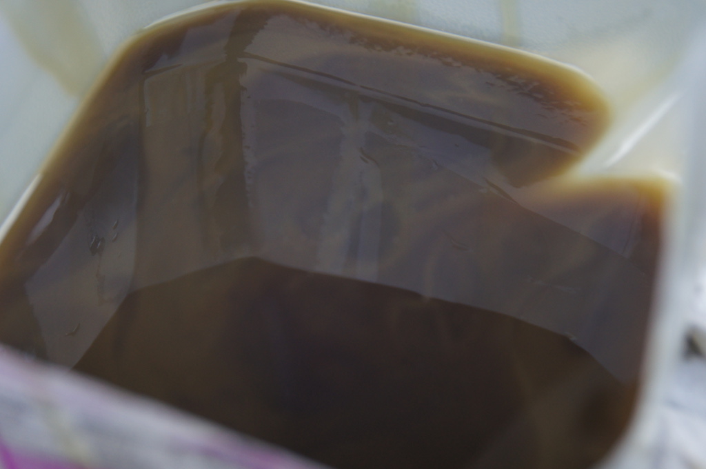

Here is a pic of the oil i drained today. That was run 2 or 3 times in the river.
Does that look milky?

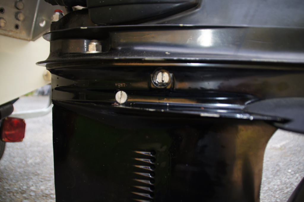

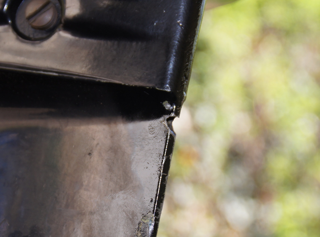

Should this hole be there? It is in the top front of the lower unit. I can't see it in the SELOC manual and have not seen it on any other pictures.
Close up:
Dan
68 MFG Chevron
61 Power Cat 18DC Tahitian

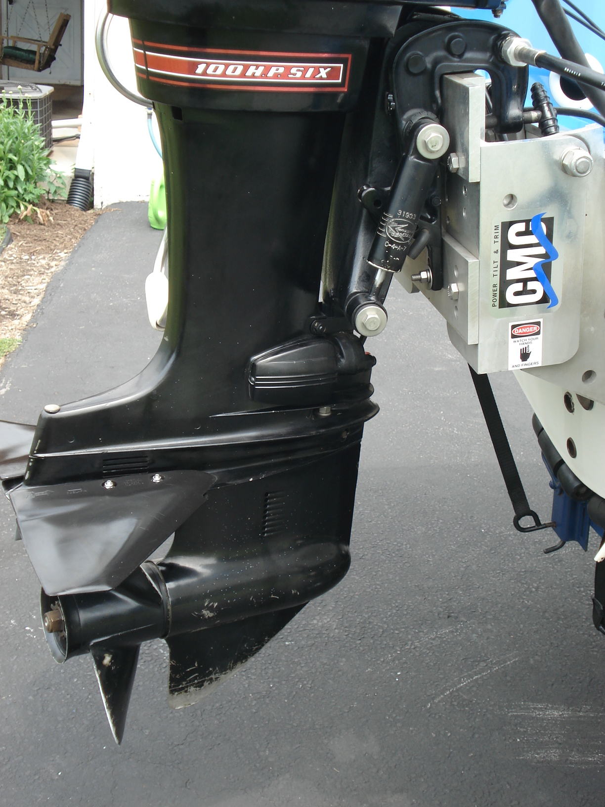

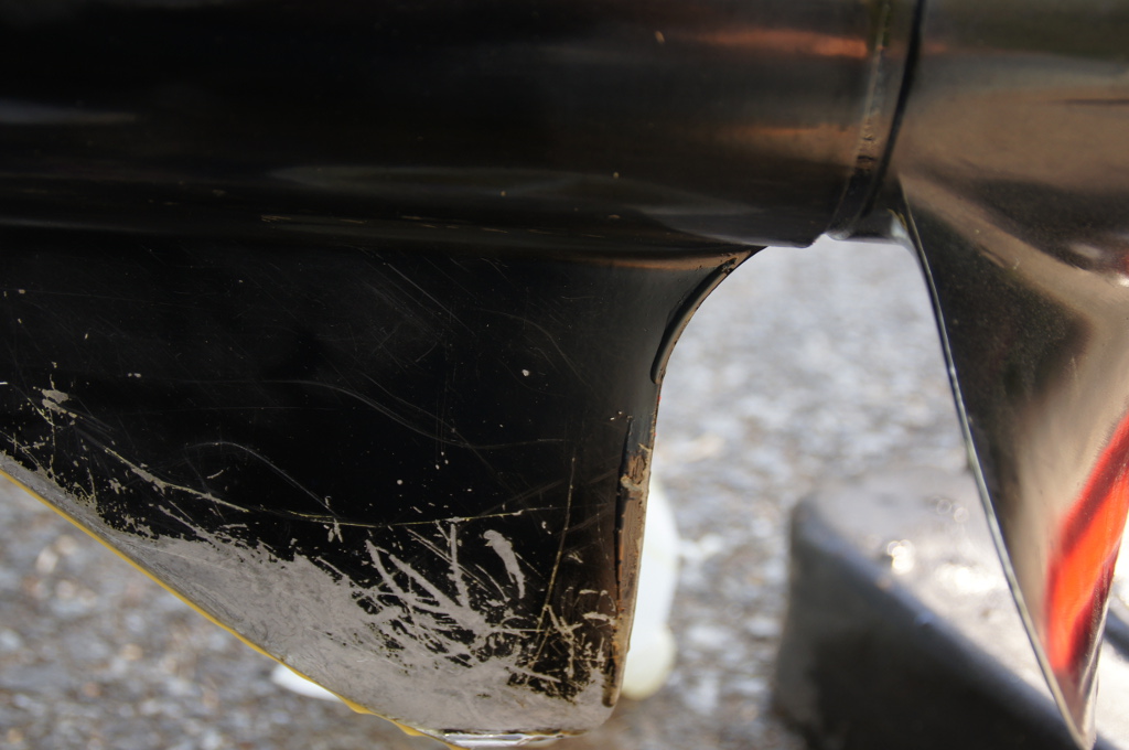

This one might show the problem.
Notice on the right side of fin under the prop there is a dark black line of oil. Probably shouldn't be leaking out of there i'd wager.
But wonder why it's darker than the oil draining from the drain hole.
Oh, is there any spray can paint i can use on her that will match?
Dan

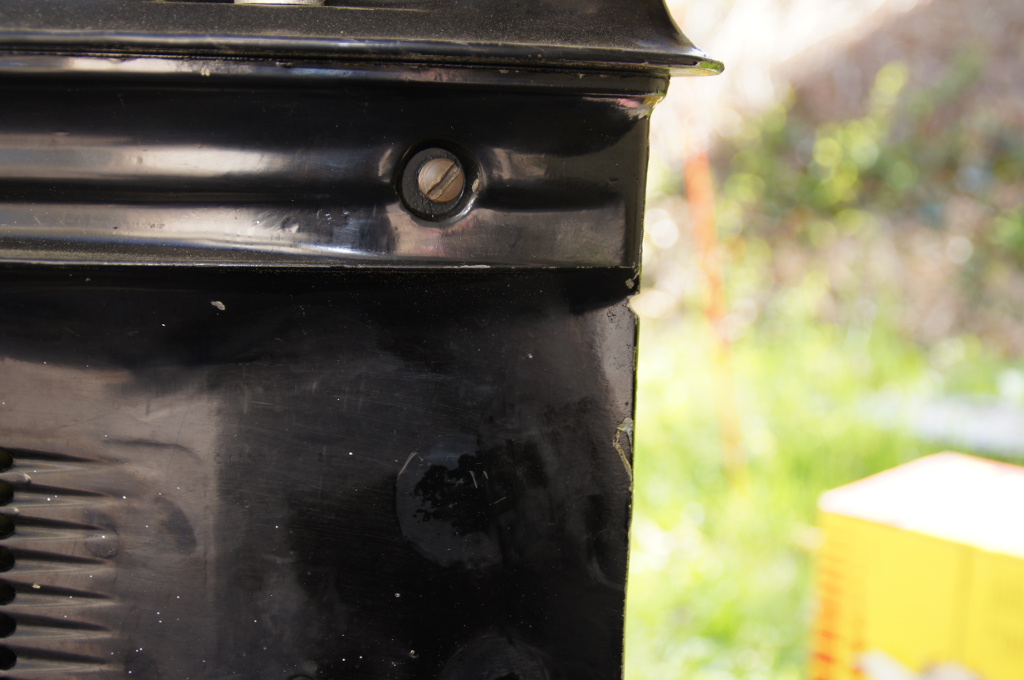

OK, last one of the day i promise no more pics!
This Flush hole. What's it do?
Other than have water and gas come out of it...
On a previous post i thought their was oil coming out but when i smelled it today it is definitely gas!
Dan
68 MFG Chevron
Re:1968 Mercury 1000 100HP lower unit. 13 years 6 months ago #77082
Hi,
The hole on the gearcase leading edge is factory. During that time, Mercury added the hole with the thought that if silt was trying to fill the hollow area behind this hole, that the water forced into the hole (when the boat is moving) would flush the silt out.
The "FLUSH" screw can be removed, and an optional flushing attachment Mercury offered can be threaded-in to flush the cooling system with a garden hose (saltwater, or sand). By the way, Mercury did not recommend running the outboard with the use of this kind of flushing attachment. The flushing attachments which induce water (from your garden hose) into the gearcase water intake holes, is suitable for flushing and running (at slow throttle settings - as your garden hose cannot provide the amount of water seen when operating in the water) your outboard.
Your gear lube does not appear to be milky. To check for yourself, the captured gear lube will separate into gear lube and some water, if there is actually any water. It is typical to have unburned fuel and oil drain from the propeller area as you show. If you were losing gear lube, the color of the drainage would be the same color as the gear lube, as you are thinking.

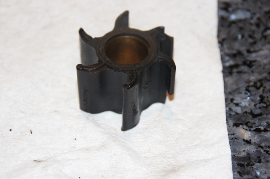

Here is what my impeller looked like:

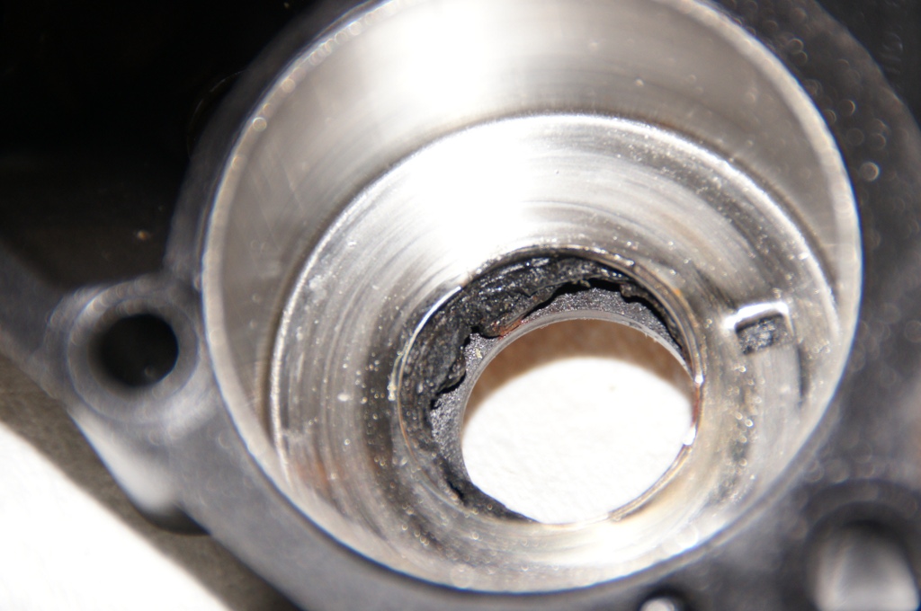

Is the housing supposed to look like this?
It's hard to see but there is now a raised lip on one side of the circle.
Looks like i'll be buying a new one when i rebuild my original LU.

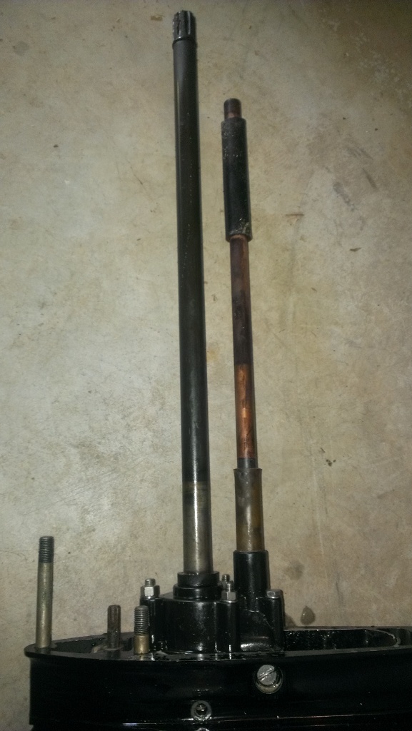

Here is a shot of the original LU after i removed it. Note how the water tube stayed in the LU.
Dan

Re:1968 Mercury 1000 100HP lower unit. 13 years 5 months ago #78653
the pump housing is shot it has been run dry.will always give a problem even with a new impeller. get a new pump kit including thr pump base.

Re:1968 Mercury 1000 100HP lower unit. 13 years 5 months ago #78671
not worn melted.from run dry.
