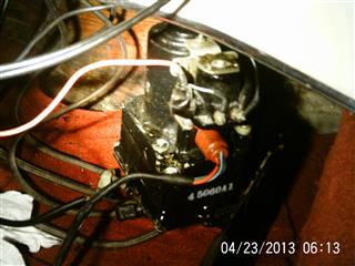

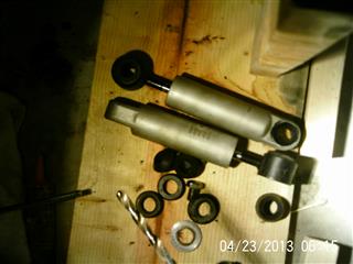

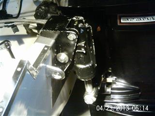

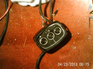

These are pictures of what you are looking for, this power trim unit came of a 1972 140hp merc, and its installed on my 1967 65hp. I believe you could get a unit off a motor as new as into the early 80's that would still work for you, and I don't think it has to be a tower of power it comes off of. I think the units are the same all the way down to the 65hp range. Hope that helps.
The power trim rams bolt on where your shocks are currently mounted.

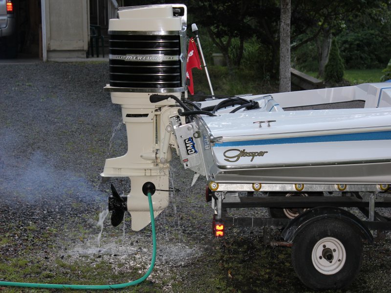

I just mounted a CMC T&T. It's self contained, just hooked it to the battery and ran the switch up to the dash.
Bandit - 1959 Glasspar G3
