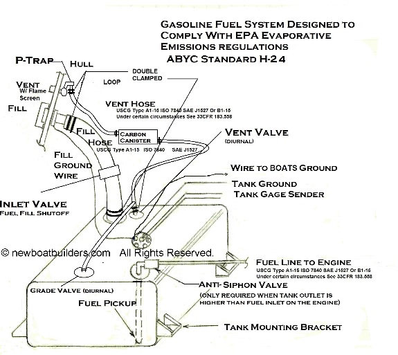

One of the key things that popped up in my investigation is a need to wrap a wire around the fill fitting and connected to the ground on the gas tank near the gas gauge sender. That in turn would be connected to the ship's ground. The diagram includes a wire it runs to the ship's ground. I don't know if I want to hook that up to the battery or not?
