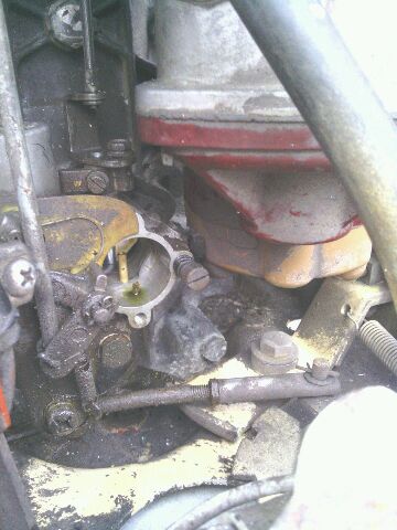

But...it has a very high "idle" when the idle screw seems turned all the way down. Am i missing something to make it go lower?

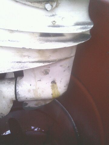

Second...what is the hole in lower unit for? (weep hole thing with fluid coming out)
1960 slickcraft catalina
1963 g-w invader ski-bird
Portage Michigan
Re: more mark 35a questions 13 years 7 months ago #76180
just a drain hole for water no problem

I know a lot of you know this motor so...
Does it automatically run on high idle till it warms up? If not, what would be the cause of the high idle with idle screw all the way down?
Portage Michigan
Re:more mark 35a questions 13 years 7 months ago #76191
no they dont run on fast idle aside from the idle adjustment on the carb there is on that is an idle stop for the mag check it out.

I checked the idle stop set screw before i posted and that was not the culprit.
Is the screw on the carb near the mouth of the carb the screw i need to adjust? Turn the screw out for richer, correct?
I do get a pop out of carbs every 5 seconds or so = Lean
Portage Michigan
Re:more mark 35a questions 13 years 7 months ago #76260
correct.

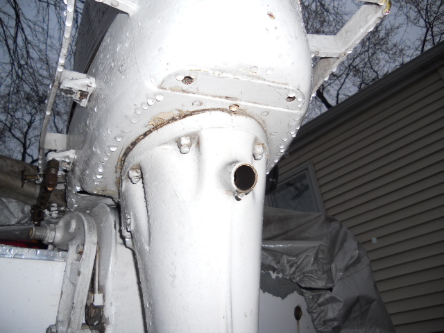

So i want to replace the impeller but when i googled it i found a thread that said....
"There IS a Tell-Tale on that motor, but it's plugged up (normal). If you look (and poke) under the left rear of the cowling you'll find it."
Anyone know what exactly that person is talking about?
Are they saying under the cowling is actually under the cowling or lower unit area below cowling? Why is it normal?
If someone could post a pic i'd appreciate it. Below is a pic of what i'm looking at.
Portage Michigan
Re:more mark 35a questions 13 years 6 months ago #76321

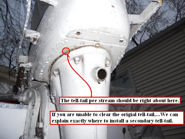

iy is a 1/8in hole located just above the last nut on the left in the pic.just tells you the pump is working but they do clog and the pump still is working fine.
Re:more mark 35a questions 13 years 6 months ago #76325
See the attached picture with notes.
HTH,
Doc F

Thanks guys. It was definitely plugged up (almost couldn't see it) so i cleaned it out the best i could with a 1/8" drill bit.
Is it easy to describe how to install a secondary tell-tail?
If so i'd like to know...
If not i'll wait to see if my tell-tail "tells" or not.
It's probably best to install a cylinder head temp gauge huh?
Portage Michigan
Re:more mark 35a questions 13 years 6 months ago #76355
There is no provision on that motor to prevent major engine damage / dynamic halt should it overheat !!--A wise man would install a new impeller before going out on the water.
Re:more mark 35a questions 13 years 6 months ago #76356
take the top cowl off and on top of the block right rear there is a 1?8 pipe plug . remove and install an elbow and run a hose and exit at a convienent spot.this is for the tell tale
Re:more mark 35a questions 13 years 6 months ago #76359
