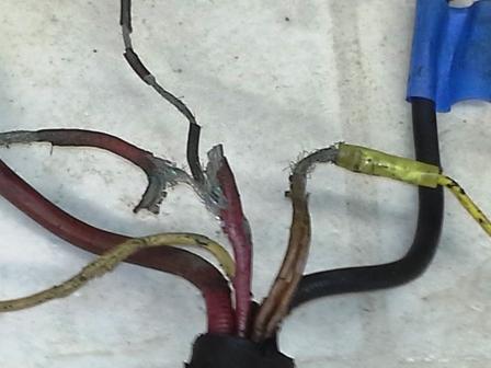

So after paying$111.00 to a well known repair shop in my area, He claims I need a new switch box($539.00 installed!). I figure it's not worth it. At home after contacing you guys I start to test things and I decide to open up the internal wire harness to trace down the leads. Suprise! Dah! did the shop ever do this(NO!) would I have put in a new switch box to have it Blow out too?
So now I'll re-wire or find new/used harness and proceed to try and get spark or put in a new/used box. Thanks fpor your advise guys.

All of my 1968 to 1972 Merc 500's had wires that looked like that.. I cut them back as far as I could and re-wired, Hooked it all up and the switch box's all worked again.. maybe you will be as lucky. Best of luck!

Thanks for the encouragement> thats what I'm going to try!Hey it can't hurt.I'll keep you all posted on the results.

Thanks for this thread! After reading it, I looked at mine and I have the exact same thing. I'll be rewiring today. Thanks.

I'm just glad I decided to trace the wire harness back. Could have wound up paying big bucks and had a new switch box short out as soon(or after a little use)as I tried to start it again(then what more $, more time wasted etc.). Thanks to this forum and guys like you, we can keep these old boats/engines still running.
I rewired the harness taped and used heat shrink I'm finishing hook-up today and then we'll see if that original switch box is still good. At least now if I have to buy a new switch box, it won't short out.

I had a couple of wires like that , I soldered and heat shrinked them .. Bang zoom .. ready to go !!

Thanks guys: I re-wired harness and she started right Up! Thanks for the encouragement.All it cost was time,new wire,heatshrink & tape.
