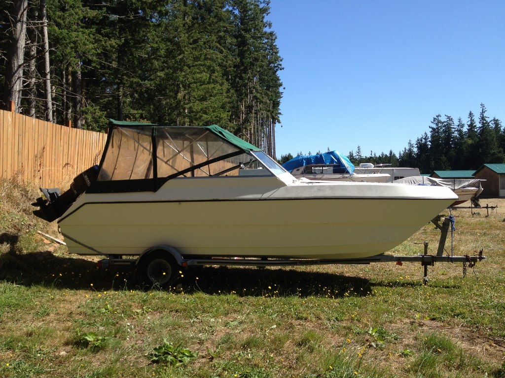

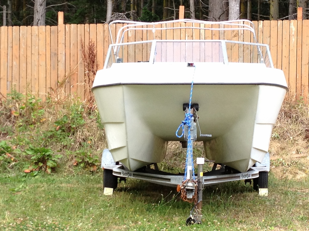

Will mount her on my newer power catamaran, replacing a Merc 90 triple looper. She'll be doing more cruiser duty with the Cat than speed duty. But I will admit it is hard not to use the Power of the Stack.
