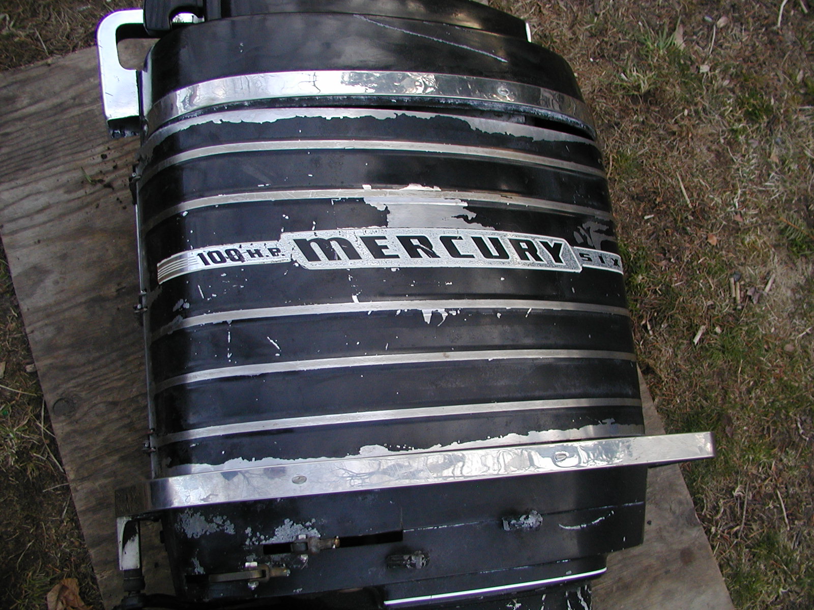

hi, a friend picked the up and we are trying to find some information on it. serial# on the transom clamp is 1689101, the wrap reads 100hp and the faceplate is from a 950SS. if it is a 100hp then that would make it 1964? also how does the front of the hood attach, it looks like something is missing there.also to get spark do i need 12V at the white resistor wire?

I believe the upper cowling is held on with 4 nuts.
Re:inline 6 13 years 7 months ago #75805
on the back there is a bracket but on the front the studs are missing and i don't see any thing it would attach to. hopefully we can build a stand this weekend and get a better look.
thanks
Re:inline 6 13 years 7 months ago #75807
Is there a nut near / above the distributor ( visible in the first picture ) that hold the cowling ?
Re:inline 6 13 years 7 months ago #75809
I have a '63 1000. I can send you pics of anything you need. I'll snap a few of the hood attach points this weekend and send them along.
I interpreted your original question to be how to attach the chrome face plate, vs. the top hat/hood. Did you have questions about the face plate?
Pete
