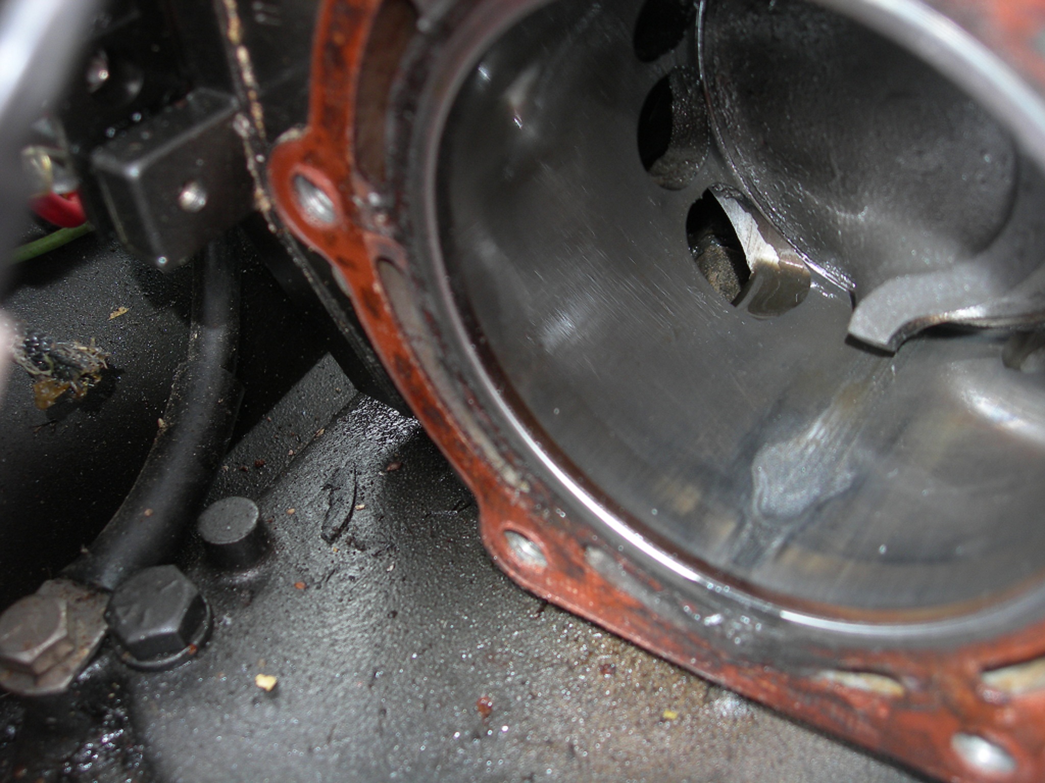

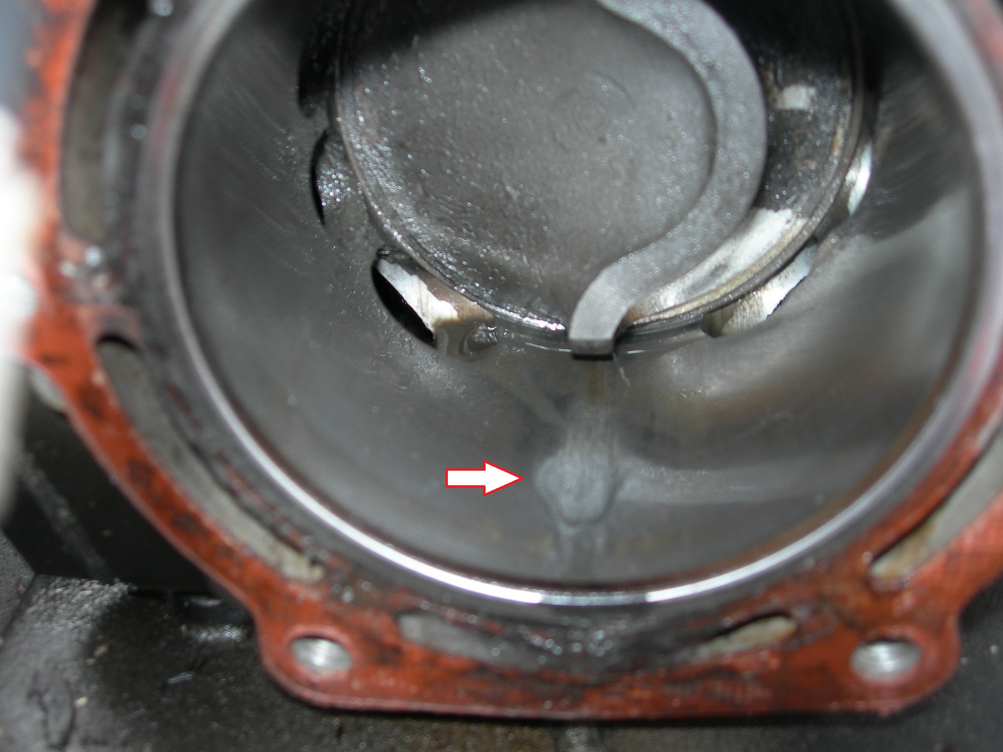

Well Scott I didn't get as lucky as you did. I pulled the head and first noticed that it was not the gasket that had blown...it was fine. But it was immediately evident what was wrong. The lower cyl wall has a gouged out trench in it as seen here:
And here:
When rotating the crank it is easy to see the effect....on the compression stroke you can see and hear the air and oil spitting out that gap. Not really sure what is causing it...doesn't seem to be excessive play in the piston or a broken ring that I can see.
So now what? Option one...hope the gouge isn't too deep that it can be honed and add an oversized piston(kinda doubt it) or option two: tear it all apart and part it out by piece.
Too bad cause it is a nice clean looking motor that as I said is running albeit labored because of the pressure loss.
Thoughts?

Tim, it looks to me as if the head gasket was leaking right in line with that "wear" spot. Maybe a hot spot. Put a used ring in over the wear spot and measure the gap underneath, my guess is you would have to go .015 over to fix it. It kinda looks like the work of a dremmel tool in the wrong hands.
Re:Force Good News Bad News 13 years 7 months ago #75409
a good machine shop can offset bore the cyl so you can bore to
the smallest size possible have done this with H-D cyl
Charles
