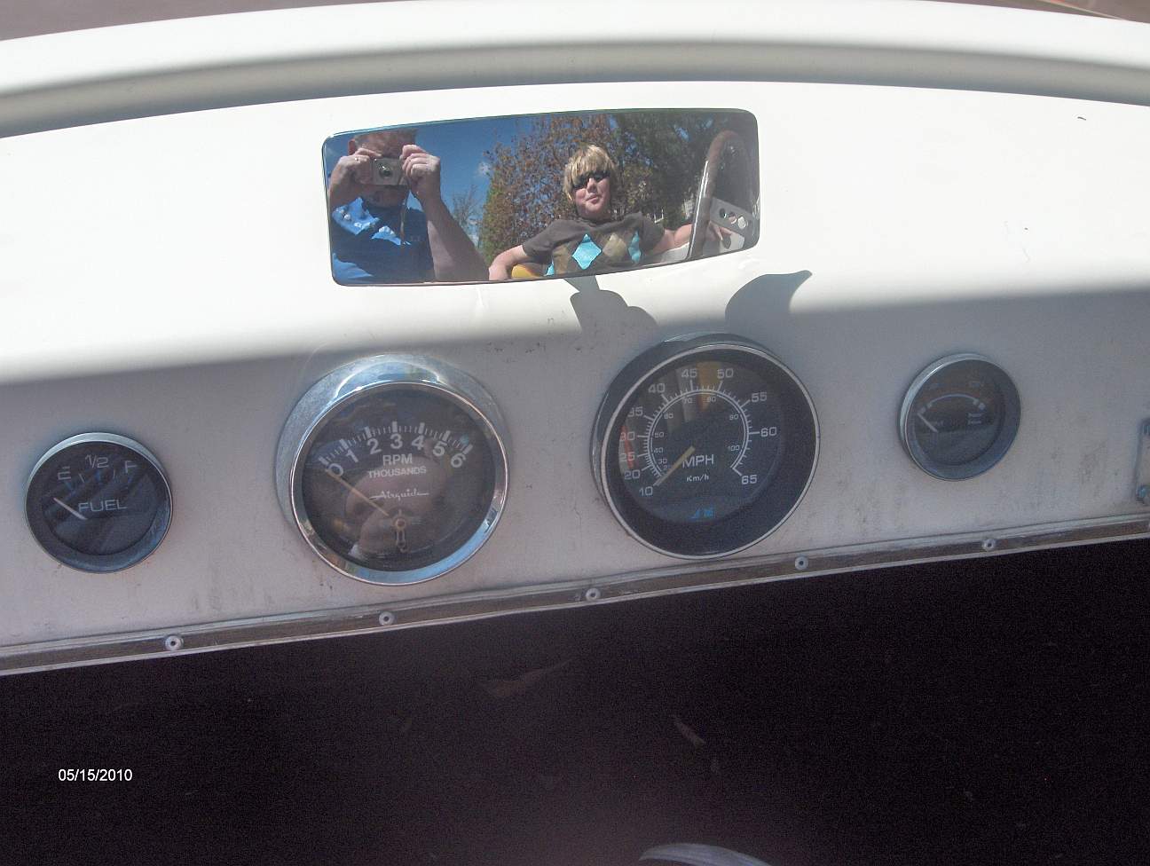

]So, here is a shot of the instrument panel.
Now, the fuel gauge works, but one of the tank sensors does not. Or perhaps its a loose wire somewhere. Time to break out the multimeter. (Something I AM good at!)
RPM gauge pegs, and is malfunctioning. Again, it could be wiring, or a defective gauge.
Speedometer works, don't know yet how accurate it is.
Trim meter does not work.
I am thinking about removing the trim gauge. I can not see the benefit right now. I just turn around and look to see if its all the way up or all the way down. I spoke with the mechanic at Valentines and he stated that they are constantly getting out of adjustment.

When several gauges start to mess up or one for that the first thing I check is the ground! Voltage goes to it but cannot get back to the negative and it has a partial ground. Since most of the gauges rely on resistance it is very important. Gauges for the most part are nothing more than resistors. Hope this helps.
Re:New 1975 Merc 1500 Questions 16 years 1 month ago #7725
That Airguide tach is probably designed to read off the switch box rather than the rectifier so if someone moved the sender wire (brown) from the starboard side of the switchbox over to one of the yellow wire terminals on the rectifier or if someone replaced the six cylinder switchbox with a 4 cylinder switchbox at some time in the past - that style tach will peg.

Thom is correct (as usual) that tach is specific for the merc switchbox. If you look at your wiring diagrams when you get the manual you will see the tach wire shown in two locations, one with a dotted line, one solid line. Connect the + terminal on the tach to the switchbox,the - terminal goes to ground.
There is no trim sender on that engine so the trim gauge is Moot.
