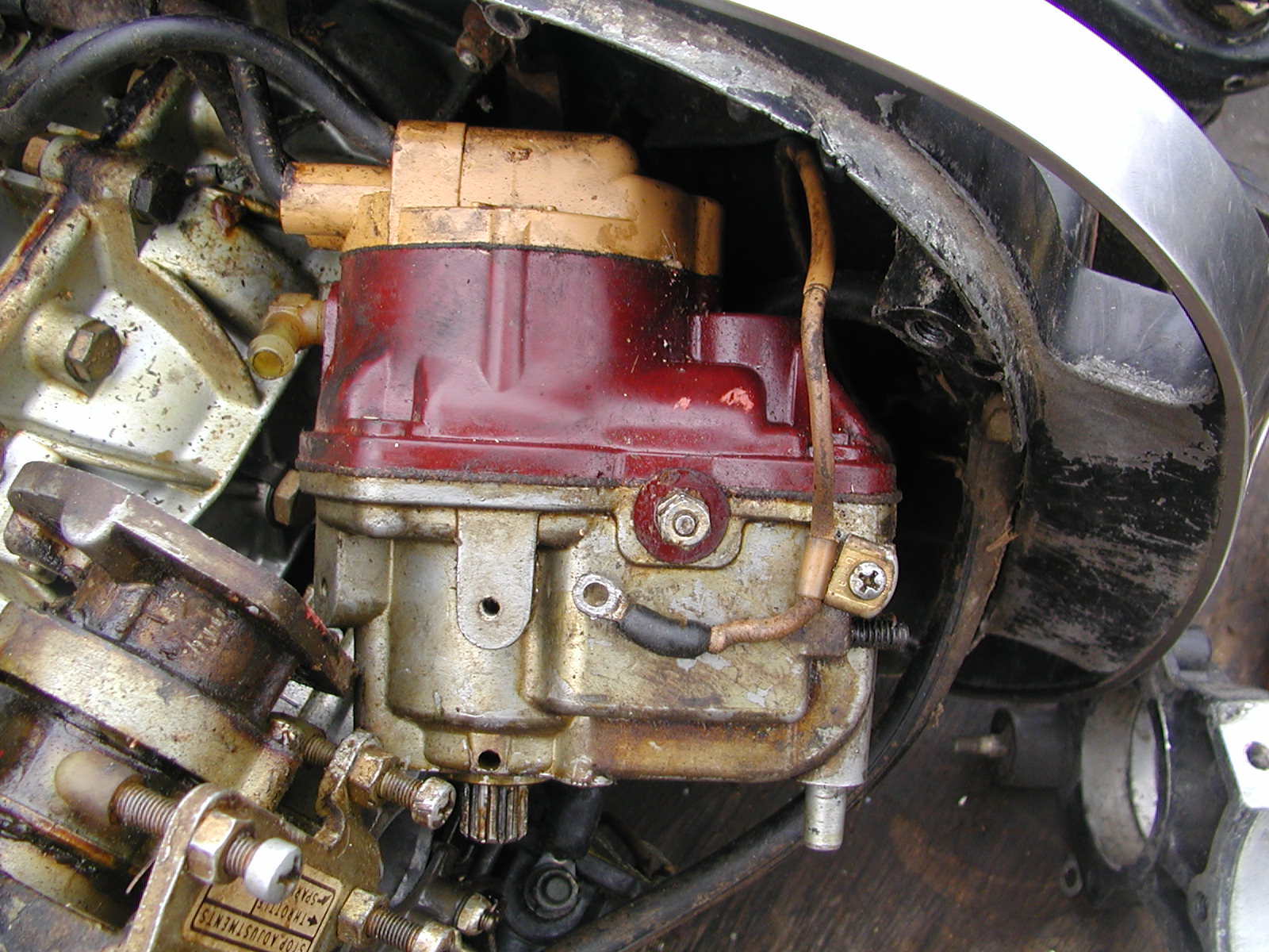

hi, i have a 50hp that has no spark so i am trying to troubleshoot the distributor but the cap is stuck on there pretty good. anyone have any tricks to get it off?
thanks
Re: 50hp distributor 13 years 8 months ago #74888
wooden handle of a hammer and tap it side ways. works every time for me.parallel to the red cap.if you have a problem i can repair the mag just send it to me. i can do a 1 day turn around with a mag i have already to go.
Re:50hp distributor 13 years 8 months ago #74897
thanks dave, it is being stubborn so i sprayed it and i am hoping that will soften the gasket.
Re:50hp distributor 13 years 8 months ago #74912
You will need to remove the yellow distributor cap, then remove the rotor, and then you will be able to remove the red distributor cover to access the points, etc.
I take a very sharp razor knife and gently slide it in between the yellow cap & the gasket. Then turn the razor knife ever so gently, say less than .005" to get the gasket to release.
Then you will see if the gasket is sticking to the yellow cap or the red body and proceed accordingly.
If the gasket refuses to release, I spray carb cleaner at the gasket and wait for it to soak in a bit.
Then things will release.

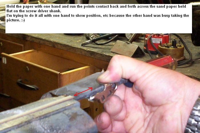

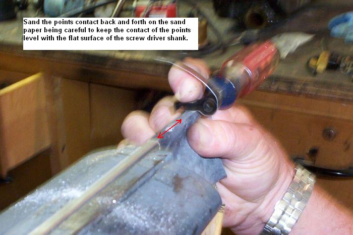

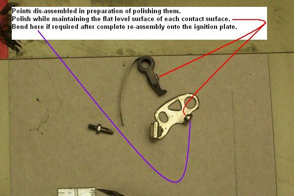

I will attach pictures of how to polish the points, which is commonly all that is needed to revive the magneto.
Begin polishing the points with 400 wet-n-dry sand paper, then polish them to a mirror finish with 1500 wet-n-dry sand paper.
Points get set at .010"

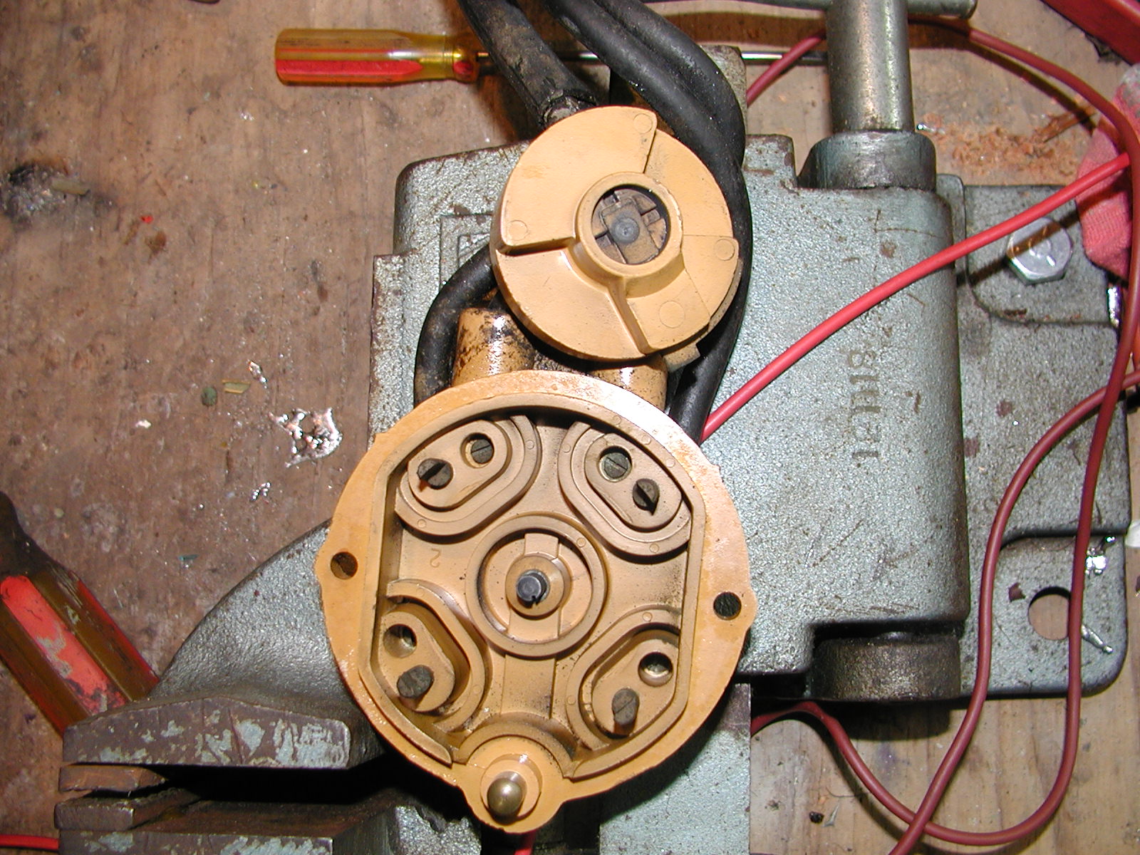

ok, i got it apart have the points polished and reinstalled, my question is can i bench test it for spark? Also should i do any cleaning in the cap? By the way the razor blade and string method did the trick.
thanks
Re:50hp distributor 13 years 8 months ago #75093
ok, i rigged up some spark plugs and grounded them back to the housing and got spark on all four.
