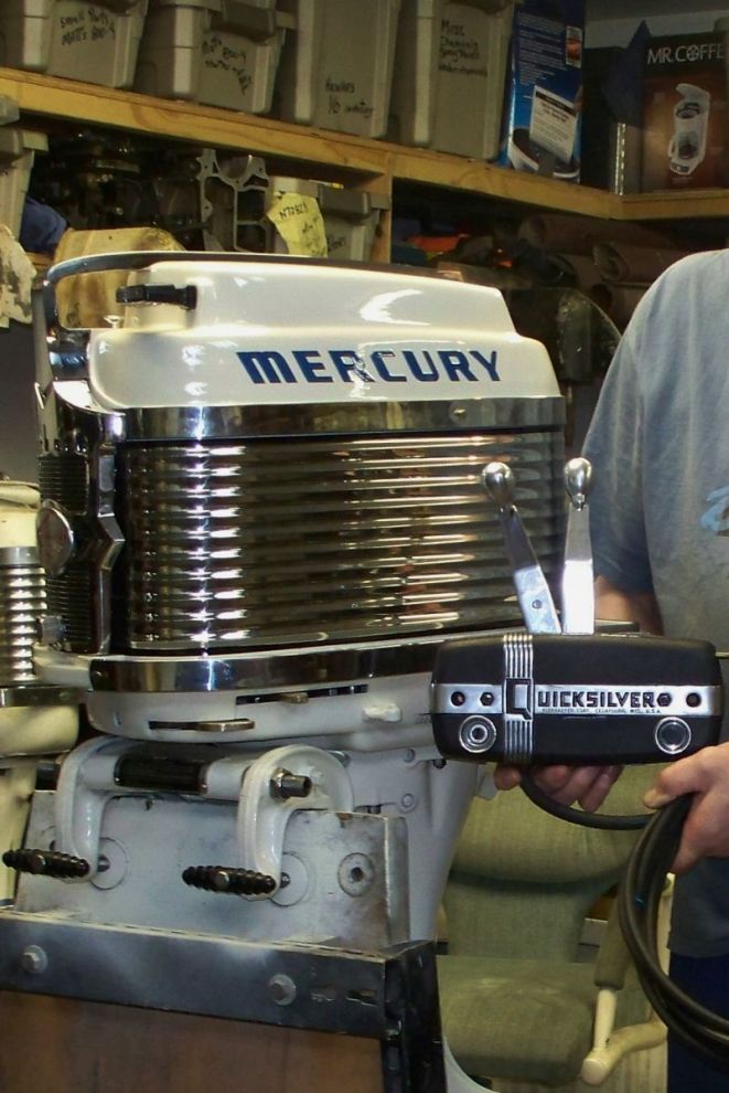

I have a Mercontrol control and a Quicksilver control. I want to use the Quicksilver control with my 1959 Mark 35a. Can i use the wiring harness from the Mercontrol on the Mark 35a?
I feel this is a no-brainer but i had someone stop by and he said it would not work. He said the plug "prongs" wouldn't match up to the Mark 35a but i checked and they do.
Harness is shown below......
Using this control......did this control originally have any buttons or key cylinders? If someone has pics please post.

that plud should work in a 35A may not use all the pins. if it plugs in it should work.
Re: mercury control compatibility 13 years 9 months ago #74160
If the plug fits, it should work. However, getting the harness to work with the older controls may be an issue, as the original key switch had a right-angle harness that allowed it to fit on the face of the control box. The MerControl key switch is likely too deep to fit in the box. Might have to dash-mount it, or find a different key switch that will fit...

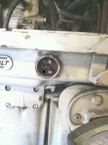

I tried to email Dr_Frankenmerc for help on the wiring of the Mark 35A but email didn't go through. Can anyone else help me out?
I think this should be the prong for the choke.....

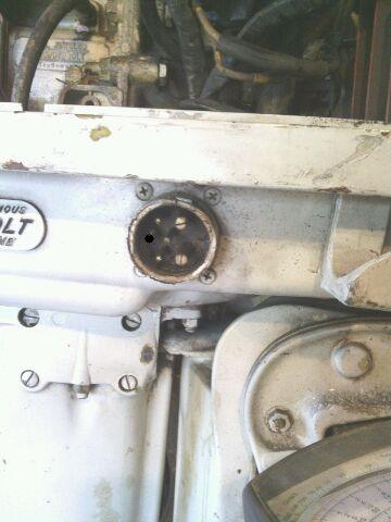

Negative cable.....

Re:mercury control compatibility 13 years 7 months ago #75651
Hi,
Starting with the last picture, the small center pin does connect to the battery-side of the rectifier.
Second picture up, small lower left pin does connect to the magneto assembly terminal for grounding the breaker point to stop the outboard.
Third picture up, small upper left pin connects to small terminal on starter solenoid (other small terminal connects to ground, if the correct solenoid is in use). Start circuit
Fourth picture up, large lower pin does connect to large engine ground cable.
Fifth picture up, large upper pin does connect to (one of the) large terminal of the starter solenoid.
Sixth picture up, small middle left pin does connect to choke solenoid.
