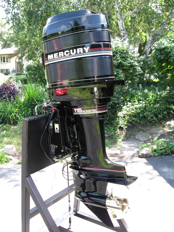

I have owned two Mercury 115 HP motors. This is what I would do to get it running well:
Change the fuel diaphram and check valves
Change the rubber fuel lines inside the engine
New fuel lines and baynets (ends of the fuel lines) from
the fuel tank to the engine (if you have portable tanks)
New water impeller
New lower unit grease
Grease motor fittings
Sea foam in gas tank several times
Mercury Power Tune through the carbs and in the combustion
chamber with the spark plugs out
New spark plugs - NGK BUHL
Touch up the chipped paint by dipping an artist's brush into
Mercury paint sprayed into the paint cap and dab on spot
As for a prop, how heavy is the boat? If speed is not a factor, a Quicksilver Black Mac aluminum, if speed, a Laser II stainless steel or a Ballistic SS
Use Mercury Premium Plus oil and high octane gas

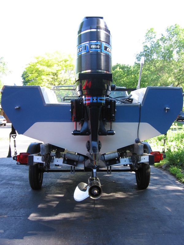

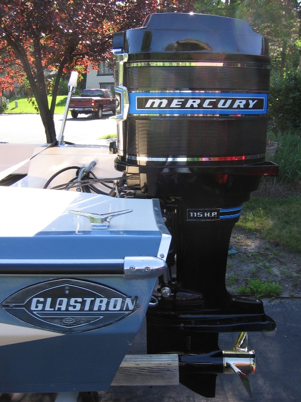

Running the 1974 115 HP Merc on a Glastron V-153 deep vee weighing 630 pounds, my best prop and speed was 53 MPH GPS running a Mercury Quicksilver 2-blade bronze prop 21" cupped at 5,500 RPM. The prop has no rake and does not lift the bow.
