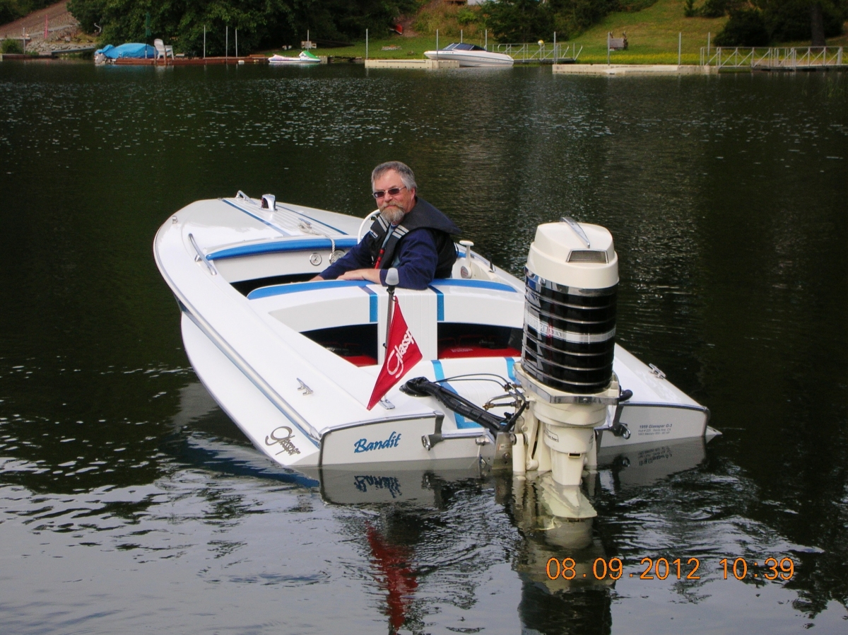

Hi Kenny,
I have a 1959 G3 that is 13' 7" long and weighs just north of 400 lbs. I am running a '63 850 Merc six. I have a Merc 1000 carb set and tuned exhaust plate installed (a '63 850 is a detuned 1000) I probably am running a little over 90 hp. I tested a lot of props last season, and my best setup was a 19P quicksilver stainless steel three blade prop with a slight cup. At 6200+ RPM (too high) riding solo, I am now getting 55 mph. I did a lot of work on my engine vertical mounting height and use a fair bit of trim to see that speed. With my engine mounted at normal height and moderate trim I was seeing 49 mph with that prop. I tried a ton of props, including the older Kiekhaufer two blade 19P bronze props, where my best speed was about 45. I didnt like it as it would break loose easily on corners and while trimming... it didnt have any cup though.
I think your motor has 2:1 lower gears, so it would be my guess that you dont want more than 19P. I just couldnt get the RPM I wanted with a 21P, and it lugged out of the hole.
I would say that Dave hit it right on the head! (45 @ 19P)
Bandit - 1959 Glasspar G3
